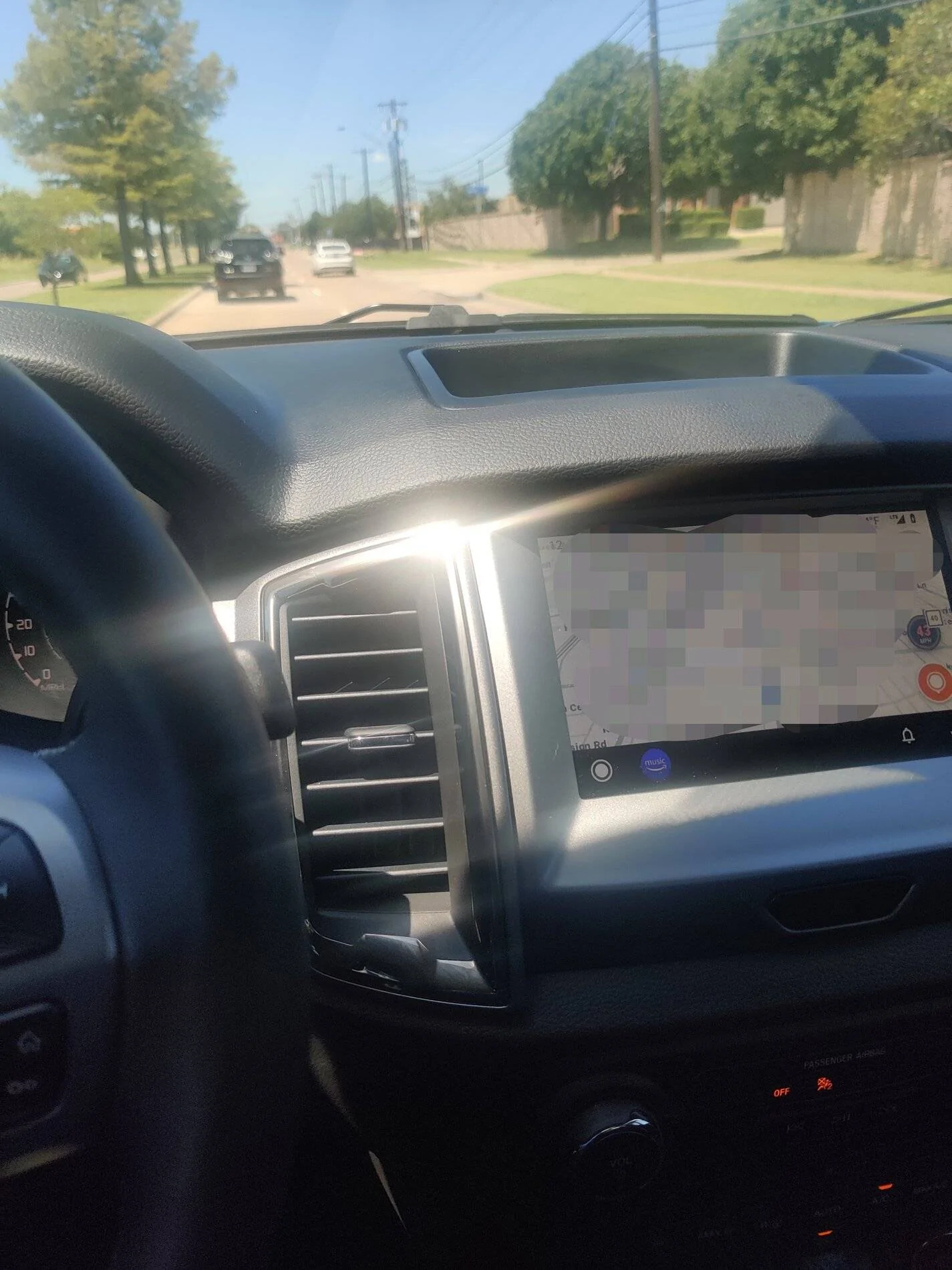

The chrome trim around the air vent is blinding.

Flip your sun visors up against the windshield.
I am looking at doing an AS1 line tinted visor just not a fan of how those normally look.

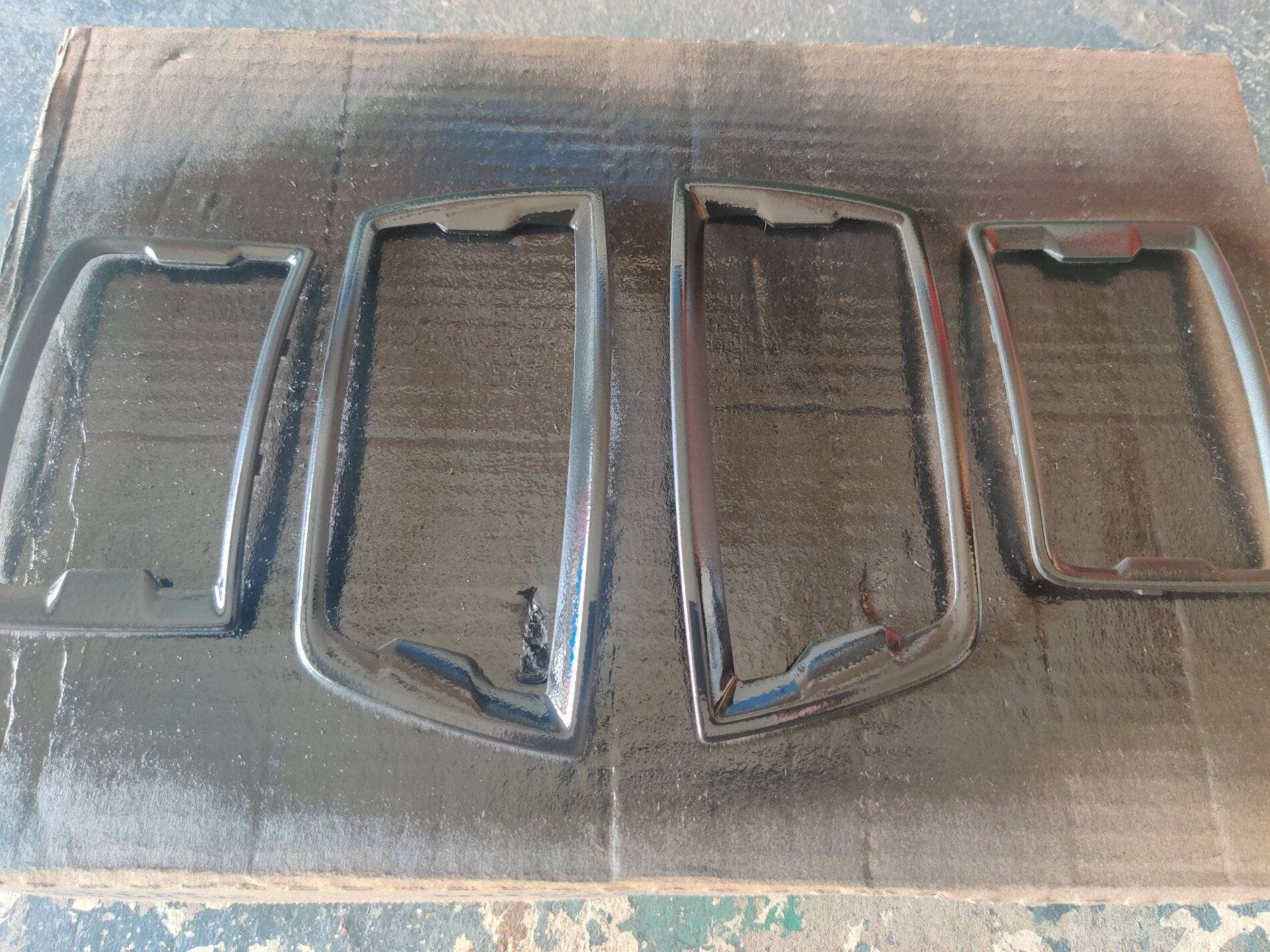

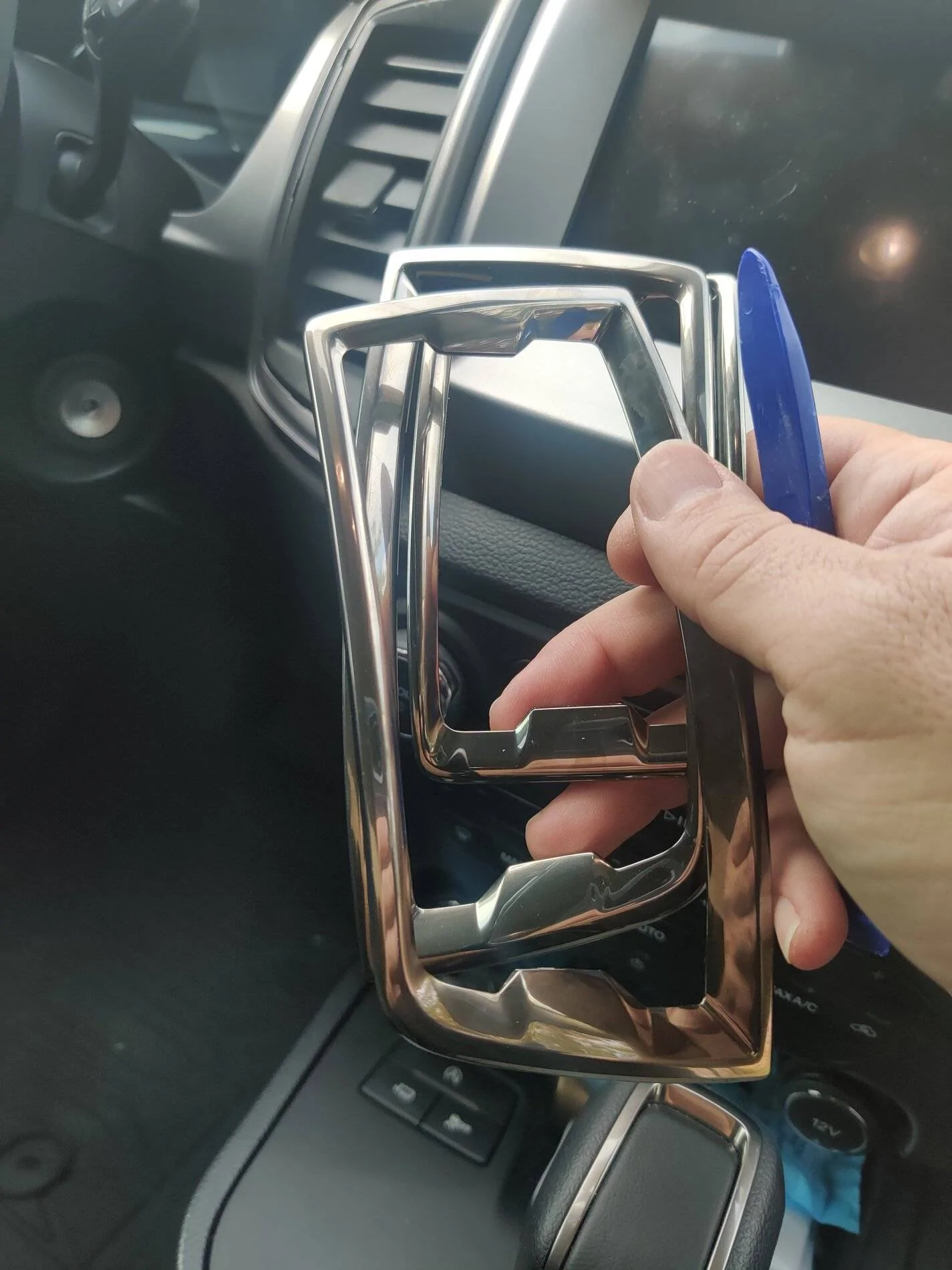

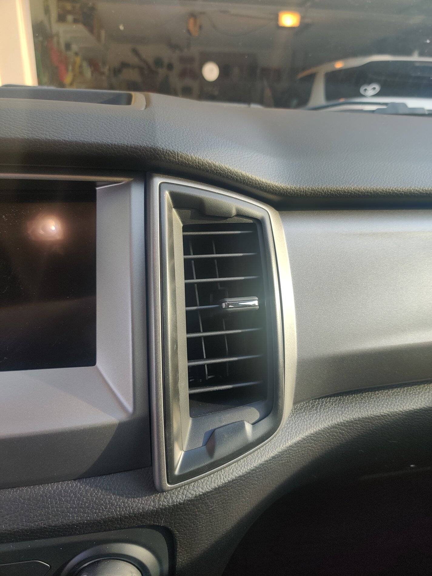

My trim removal tools finally showed up. Wasn't as intimidating as I thought. Just need to start on the inside and work your way around.
Couple more coats of this flat black and it should be better.

Looks really nice. I'll probably do this using clear plasti-dip to to retain the original color.
