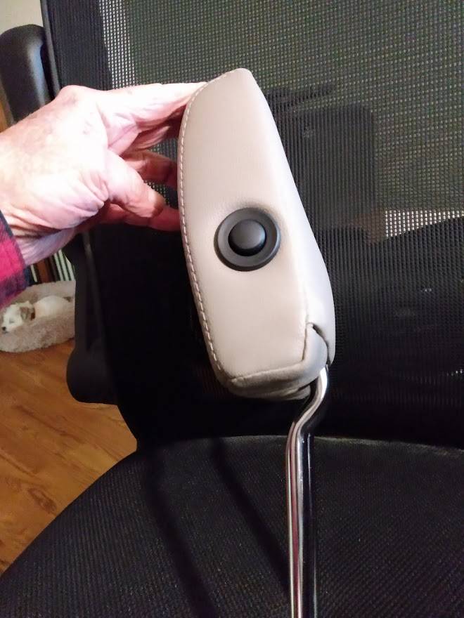

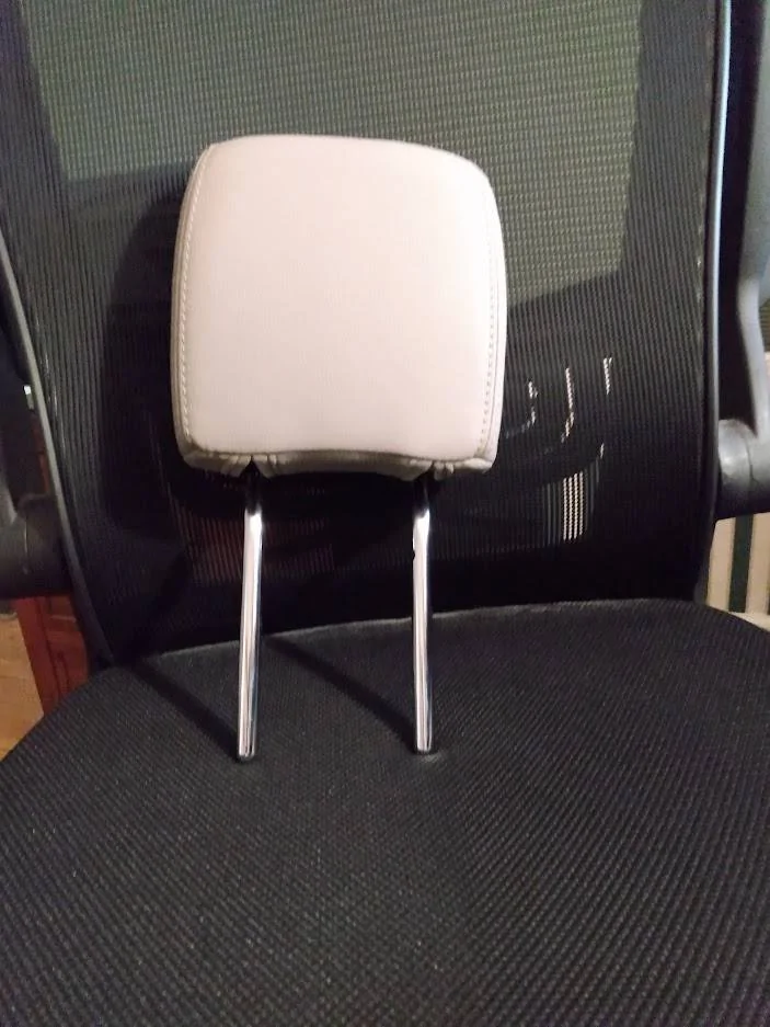

Should be the same. here's pic's of the replacements I received. Don't use them as I replaced my back seat with a rear seat delete set up. Keeping them so I can revert if needed.

I see -- thanks for the photos and details, that's helpful :)
I'll look to buy these headrests online, then, given the hassle with a dealer that also doesn't have parts.

It is not. the 2019 version of the folders have a slightly different notch that locks into the seat. I bought 2019 folders before the recall, and they did not lock in until i widened the notch with a dremel. The warranty headrests lock right in without modification.

I have 22 Screw, had fixed rear headrests and I bought & installed Folding Style, the Headrest rods have a different notch (locking) style, but they work (Fold Down -Out of Rear Window View)
The locking notch, I'm not worried about, they seem to stay in place, I may visit on what to do with this issue latter, (Possibly swap my factory rod over to the new headrest or replaced the headrest guides to match the new folding ones
FYI: I think the part numbers below are the (older) style, like poster above stated he had to widen notch with Dremel
My original factory rods - look like the one in the pic- posted above
It's difficult to locate exact part numbers through Ford parts as there are variations between Scab and Screw - So, I used part numbers from another member who has a Scab, I have not found any exact part numbers for Folding Screw, from what I can tell the Folding are only installed on the Scab - As far as parts diagrams go
Here is the Part #'s I ordered (if anybody's interested)
Note: These do not come with cover, you have to swap it over
(Right) Headrest, Outer - Ford (FU5Z-78611A08-AC)
(Left) Headrest, Outer - Ford (FU5Z-78611A09-AC)
You have to swap the cover over to them, and (cut hole around button IF you want the button to be visible-it works just fine with button hidden though.
