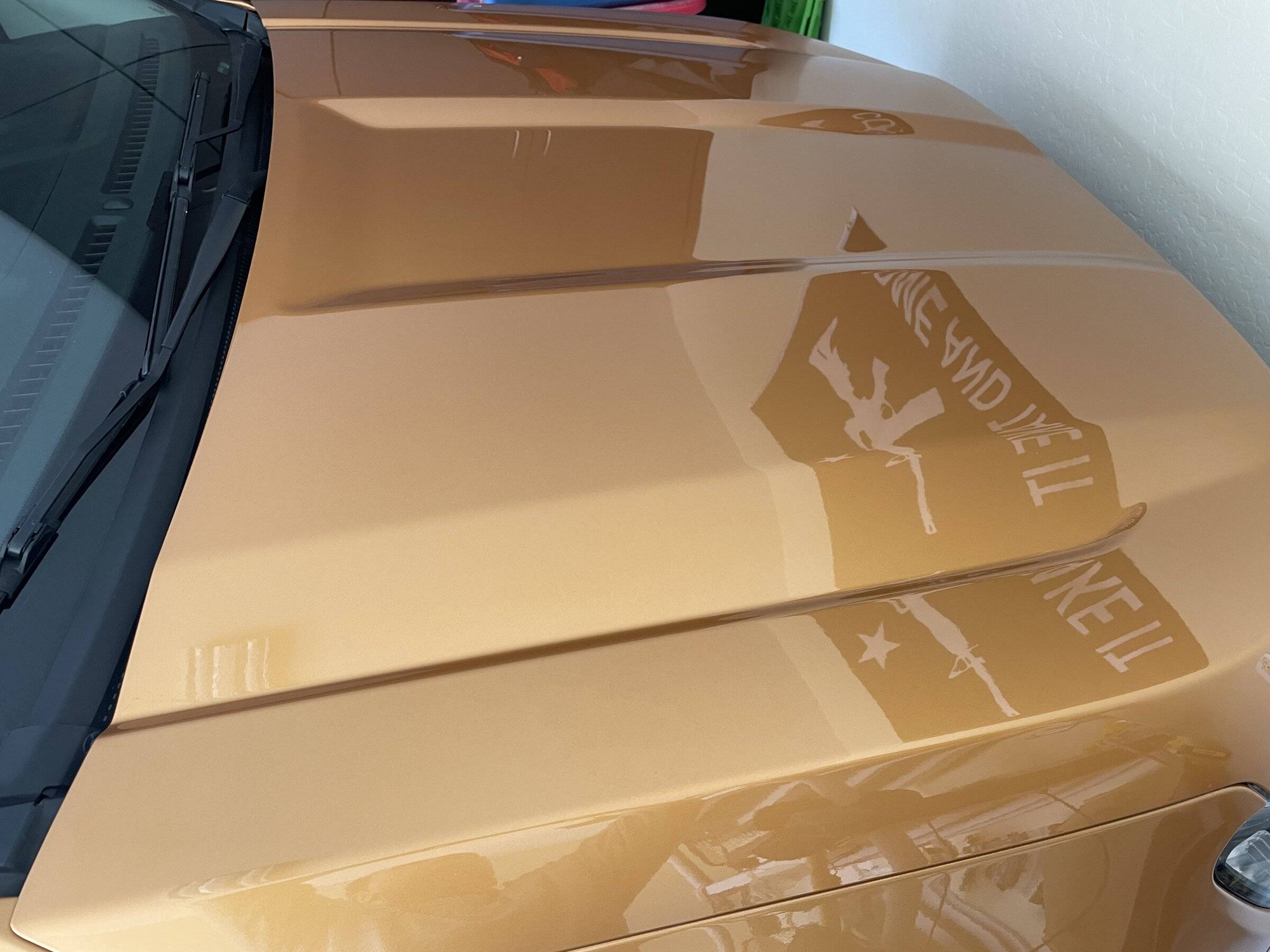

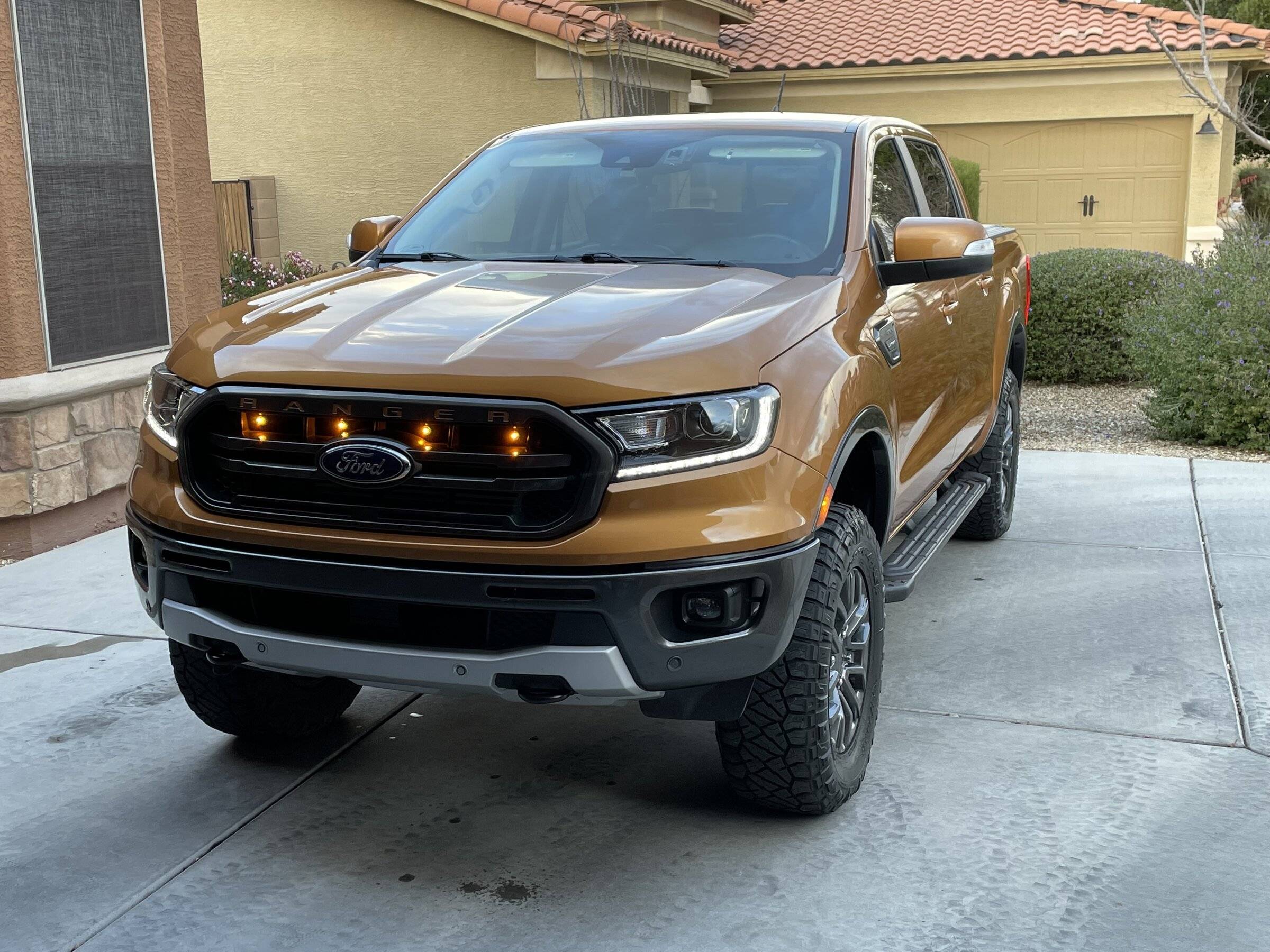

From his question : "Ok...... maybe off topic now.... but do the spray products have any protection?"
I was strictly taking protection. No one mentioned what the process was from start to finish and removing oxidation and road grime. Also READ where I linked my other thread where I talk about the step by step process for applying Graphene. I go into more detail there where is wasn't necessary to here for his question which was about protection only.
You do not need to polish if the surface is free of imperfections and/or oxidation. Just strip off the old wax, clay if needed and apply the Graphene. If there's scratches, oxidation or tar and grime obviously they need to be addressed before waxing.
My truck is free from oxidation and scratches so I use Optimum Paint Prep.
Optimum Paint Prep uses a combination of mild solvents to dissolve old wax, remove polishing and compounding oils, and leave behind a residue-free, squeaky clean surface. Use Optimum Paint Prep before applying Optimum Gloss Coat, or any paint coating, to promote maximized bonding and protection. Before paint protection comes paint cleaning!
Generally, before applying any type of surface protection, be it a wax, sealant, or semi-permanent coating, you want to get the paint shining and perfect. However, most compounds and polishes leave behind oils that can prevent your selected last step product from adhering fully and correctly. To be sure you get the best protection available, you must be sure your paint is fully prepped. And this is where Optimum Paint Prep comes in handy.
Optimum Paint Prep uses a combination of very mild solvents, nothing too harsh, just enough to remove all former waxes, polishes, compounds, or anything else that would prevent your LSP from bonding. Optimum Paint Prep does not contain any oils or surfactants and will leave no residue behind – simply a clean surface!
Because Optimum Paint Prep contains no oils or surfactants, it is perfectly safe to be used on any surface needing a quick clean. Be it exterior or interior, every dirty surface can be quickly cleaned using Optimum Paint Prep.
