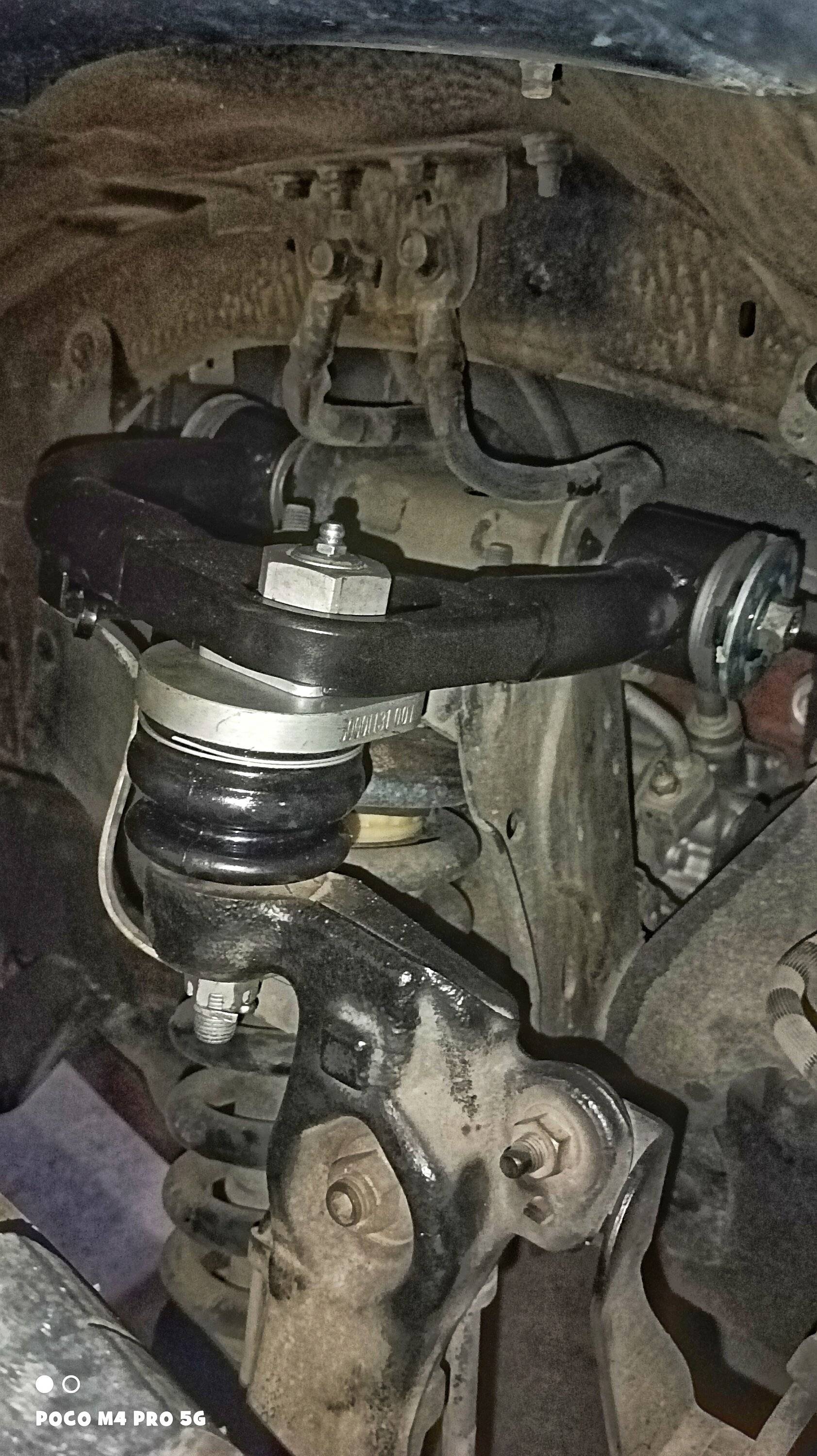

Finally I have it installed after sitting for months in my garage. Paired it with a 3 inch lift kit from Ford rangerlifts. Much better handling than stock. Set it to Letter D adjustment for +1 camber.

I just installed these along with my Eibach Pro Truck 2 kit. The SPC UCAs are a quality piece. Just an FYI, the D setting is for caster. Camber can be adjusted by loosening the big nut to slide the knuckle in or out.
