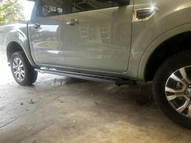

I also had separate shipping; I think the reason is the Boards themselves fit multi-trucks and the brackets are Ranger Only.
Installed mine today, no issues and the instructions are not entirely correct.
Go to Stage 3 Motorsports - Go Rhino (Video Install) Ranger for better install instructions.
Now when I last researched and narrowed it down to specific boards I wanted, it appears you have the option to install the boards (reversed), if you watch the video, you will note the Go-Rhino placard is mounted (forward), there were many comments that they were installed backwards in the video.
As of now, I just installed them the way I would consider the correct way and that is with the placard to the rear. I may try swapping them around to see if I like the look.
You will notice during install that the rear of the board narrows and the board itself will not slide forward (closer to the front fender) due to the bracket length on the most rearward attach point.
So, if you are looking to have the boards closer to the front fender and more space at the bed, then swapping the board (side to side) thus placing the placard at the front, should allow for this.
To sum it up, the board is wider in the front than it is at the back.
So, this is a owner (preference - look) install option.
An alternative would be grind down the bracket that you place on the rear attach point, this would allow the board to slide more forward. (Thus, making it shorter)
Install takes about 1 hour, note this includes the 10-15 minutes it takes to unwrap the boards and brackets. (they are tightly wrapped) :thumbsup:
Note in the pic below, the board is as far forward as it will go, and overhangs at the rear.
If you swap this board to the Driver's side the issue will be reversed.
Installer Preference.

Thank you for the update and advice. I’m installing mine tomorrow. Will update. They look good on your truck!

Those seem like they stick out pretty far. One thing I don't like about the stock Tremor boards.
