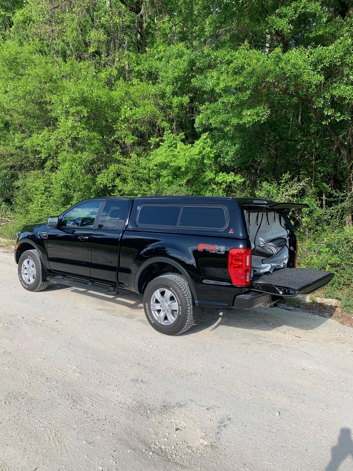

Alright, here it is. Before even buying my Ranger, my wife and I had a plan to build out a fun vehicle for camping. We've tent camped several times and enjoyed it and with Covid we couldn't travel like we planned so we decided to spend money on ways we could do things together away from most people. Covid might be over before I get this thing done though lol.
There was a lot of back and forth on what kind of camper to build. Trailers are out, I don't have space to store one. I really looked hard at the GFC style pop up campers but the prices are pretty high and I live in Florida so logistically it would have been difficult or very expensive to obtain one. I didn't really want a RTT because this new vehicle would be a daily driver and not only do I have a height restricted parking garage at work, but I don't really want to look like I'm on an expedition every day I drive the truck. I came across the Topper EZ Lift and was sold. It checks all the boxes for us.

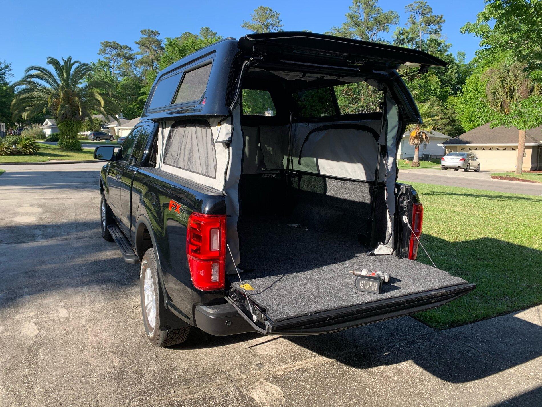

I specifically sought out an SCAB FX4 for this build because we had to be able to lay down in the back and I wanted the 4x4 capability. I ordered a Leer topper making sure to get it carpeted and I also got the roof tracks for future additions. When it was installed I had them use about 2 extra feet of wiring for the brake light and interior light for the lift system.

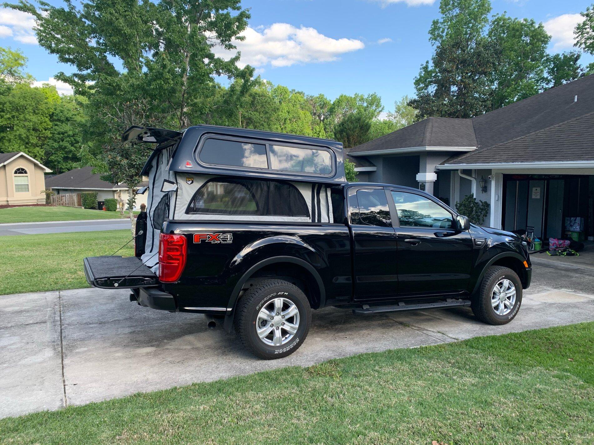

The canvas sides of the kit attach to the truck bedrails with adhesive velcro and it also uses velcro to attach to the topper itself. Admittedly it's not a perfect system but it attaches well enough there shouldn't be any issues with bugs getting in. Rain could be another issue but a simple tarp staked down over the whole thing acting as a rain fly should work great. I hope. If we get caught in a torrential downpour I'll just lower the top completely.
Speaking of lowering/raising the top. it only takes about 20 seconds. It's fully electric with no hydraulics. It can lift about 900 lbs total. So If I want to break camp for a day and go explore, there isn't a huge effort required. It's also a very secure way to store all of my gear. I can lower the top, throw my stuff inside and lock it up. Keyless entry on the topper is nice as well. The factory FOB locks/unlocks the topper with the rest of the truck.
Now at the time of writing this, I have the EZlift installed but I haven't built out the inside yet, or taken it out and camped with it. I keep going back and forth on how to build it out. The plan is to keep it mostly simple and light weight so I can remove it easily if I need to haul something large. Most of the time the camping gear will stay in the truck though. It needs to sleep 2 people and I like the idea of a fold away style bed but just not sure yet.
