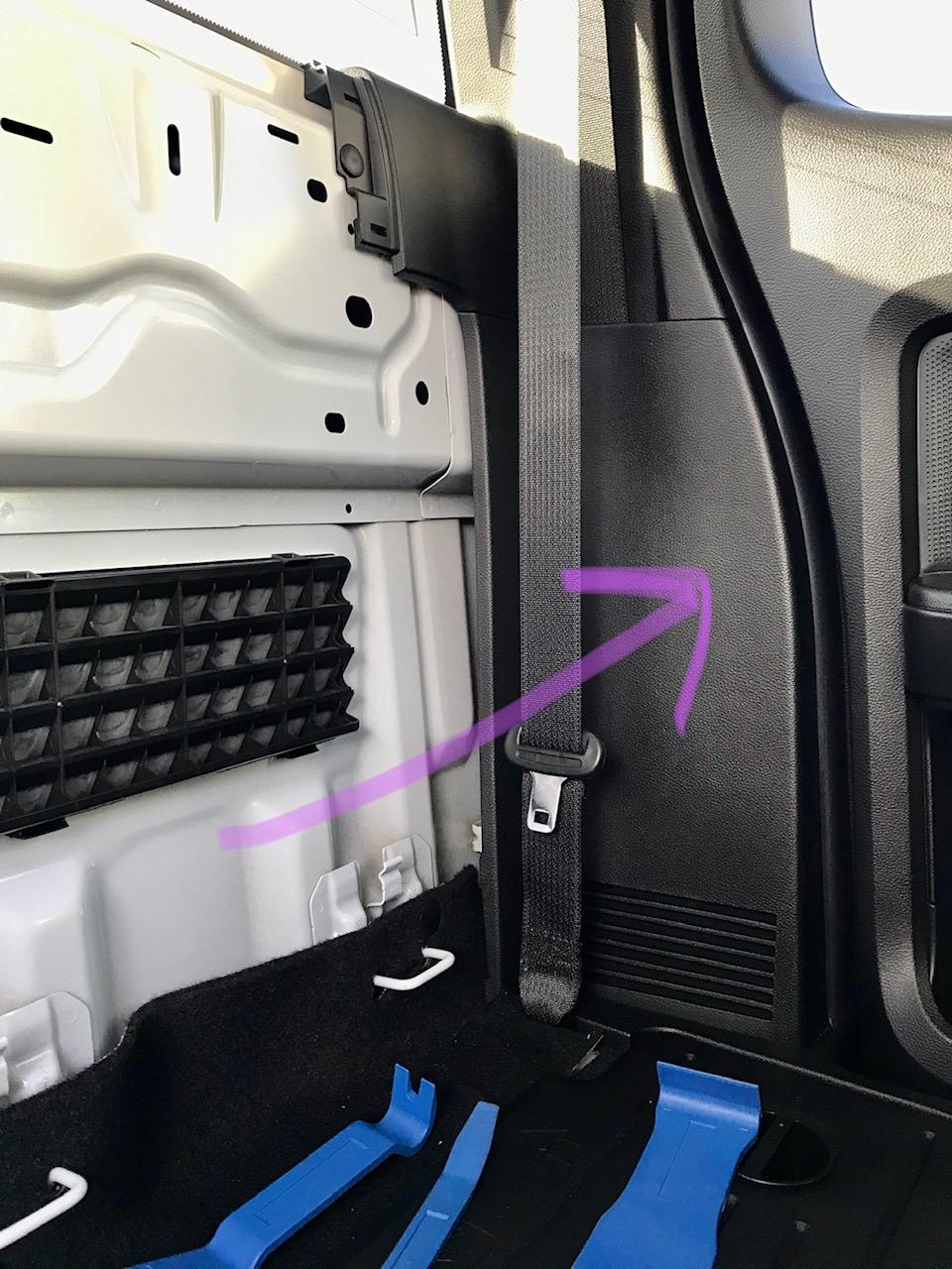

I've deleted the rear seats in my SuperCab in order to construct a gear platform, therefore no need for the seatbelts. I ordered up the trim panel from the XL model to clean up the rear wall but having difficulty figuring out how to get access to the retractable seat belt mechanism. Searched online for a tutorial but no luck in directions on how to remove plastic. Really don't want to yank and pull and risk breaking mounting tabs without knowing what's back there. Anybody remove this panel yet?

Yeah. You have to remove that panel to do the factory Brake Controller install. Start with the door seal and then the bottom of the door with the dust plate or whatever they call it. Work your way around, slowly. The C pillar trim, where the seatbelt comes out of the wall, is two separate pieces. Bottom comes out first (where your arrow is pointing).
Most of that is just the plastic connectors, but based on the fact that you have those plastic pry bars I think you know what you're doing.

Thank for the tips Jake. I worked on it a bit today before the rain started but was not successful in getting the lower panel to release. I'll have another go tomorrow. Did you actually remove the door seal or just work behind it?

The rubber door seal just pulls up and presses back into place over a seam. It's not glued in or anything. Just pull it out. I only removed where it needed to be out of the way and left the rest in place. Makes it easier to put back.
