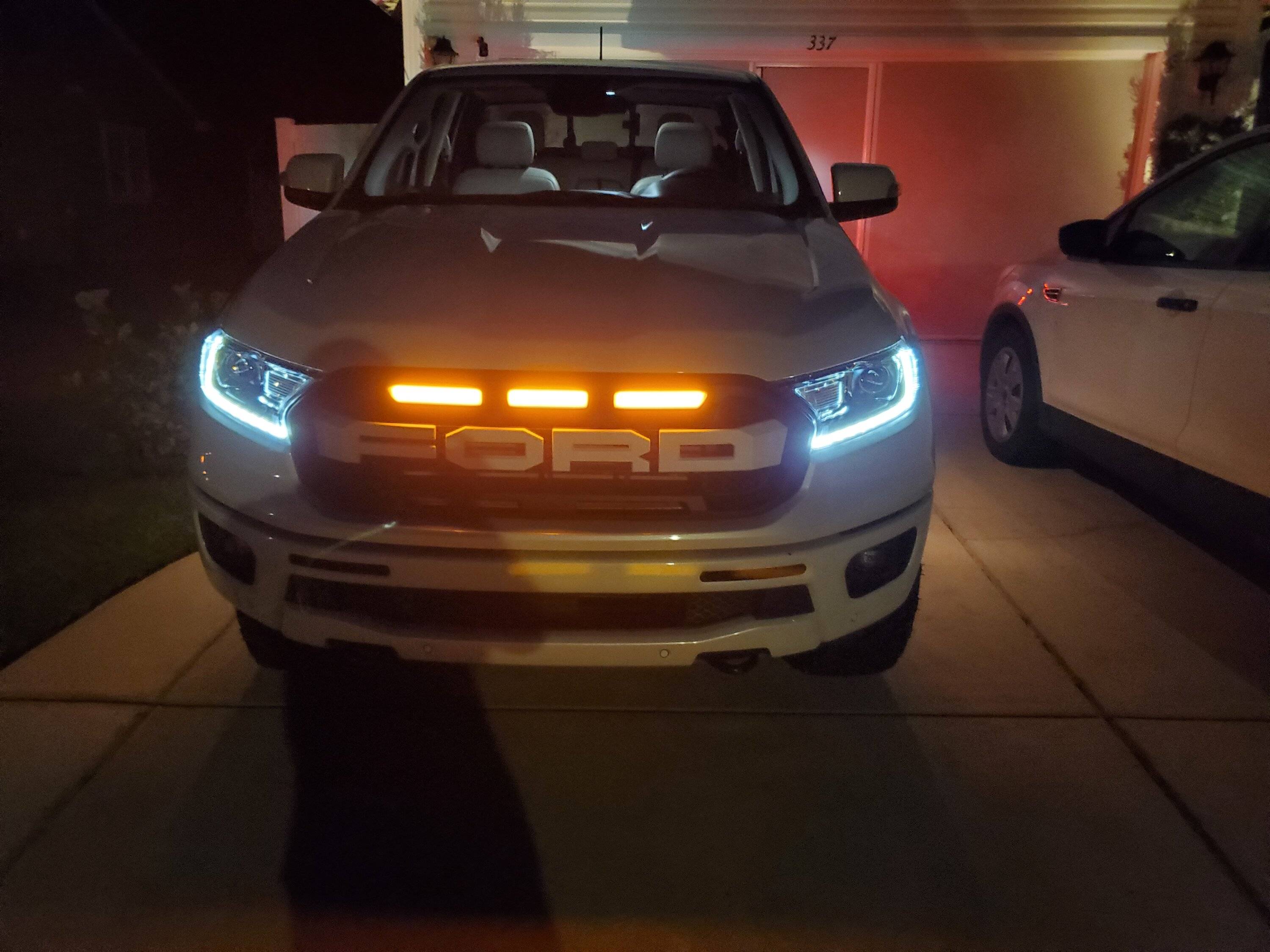

The_LoneRanger
Alan
Jun 16, 2025
Austin, Texas
2020 Ford Ranger
I had the exact same problem everyone else is having with these aftermarket raptor grille LEDs.
Whenever I would start my truck the side marker & LEDs would power on but usually turn off after 15-30 seconds. Sometimes they'd stay on for the whole drive or sometimes cut off in the middle of the drive. ?‍♂
I don't think that the grille's LEDs are the problem but that they're drawing too much power to be installed at the side markers as suggested in the instructions.
I fixed the issue by wiring the grille's LEDs directly into the headlight. I wanted the LEDs to work in sync with the side marker/day time running lights. Which ended up being the Green/Orange wire and ran the ground to the battery since it's right there.
They've been working perfectly for months now. ?
