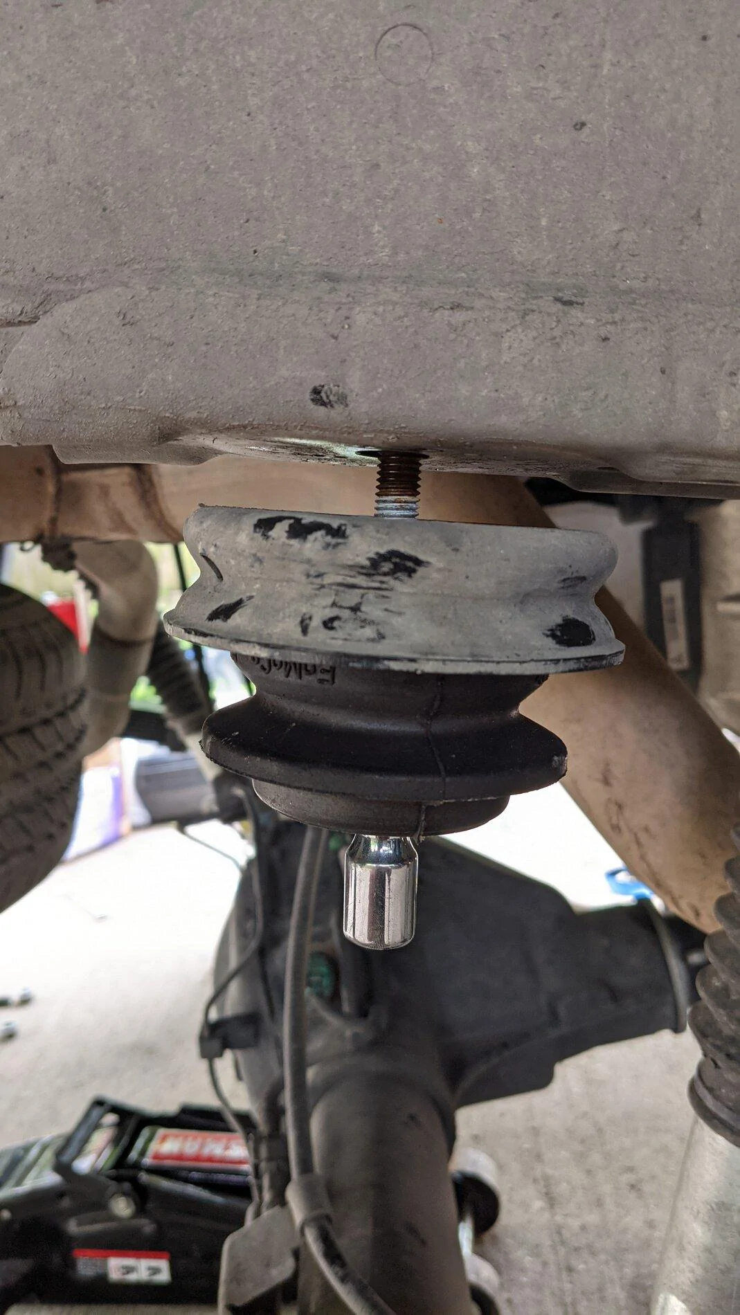

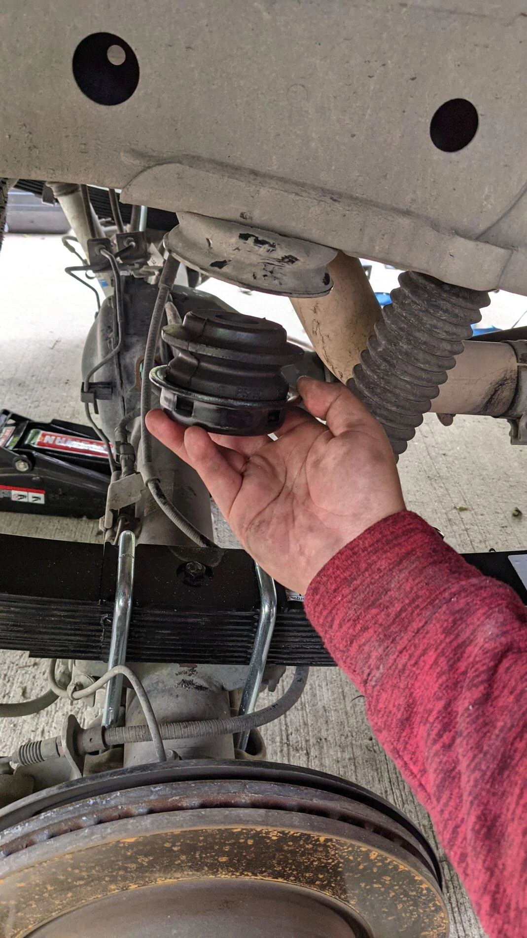

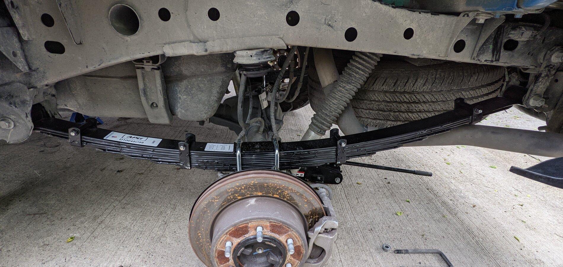

Has anyone installed these? I just finished installing my deavers but I'm not sure how these go on. It looks like they pop right in, considering I just popped the oem's right off. Haven't gotten it yet.

Nothing to add to your question but I must say those leaf packs look stout. Let us know how they perform and what other suspension mods you’re using in conjunction with them.

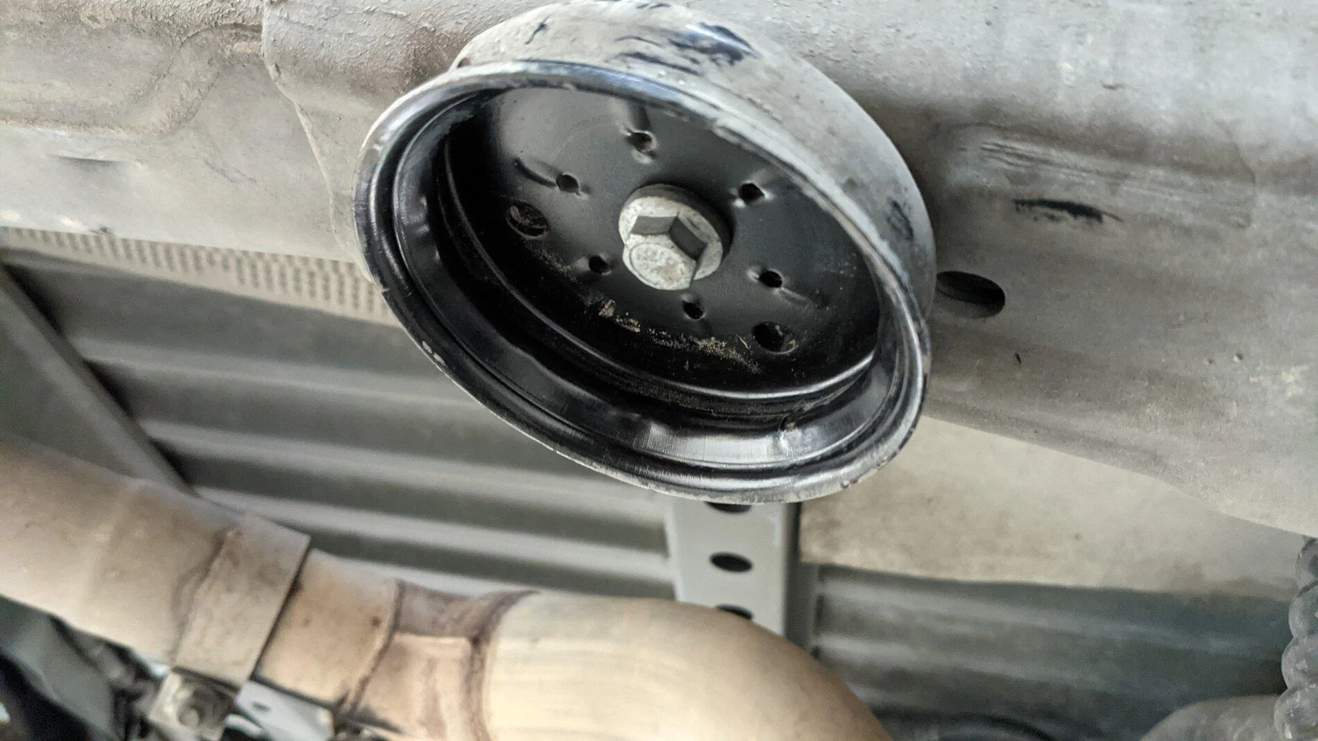

Wait I think I have it upside down and I use this screw

Ok I got it, it does use the factory bolt.

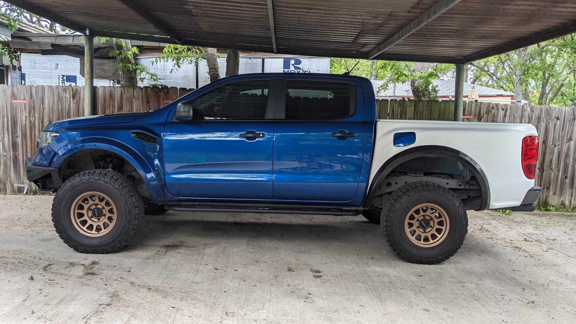

Done. Rides better.
The back right fender was at 42-1/2" now it's at 44".
The back left fender was at 41-1/2" now it's just under 43-1/2".
I didn't want to raise the rear but damn it looks good.

Update. The rear settled back down.

Hey man probably out of the blue noticed you got the deavers installed I just put mine on and it just seems like the “ranger lean” is more pronounced have you had this problem, did it settle? Or should I go back under and see if I did something wrong

Yea it settled and is more even than before.

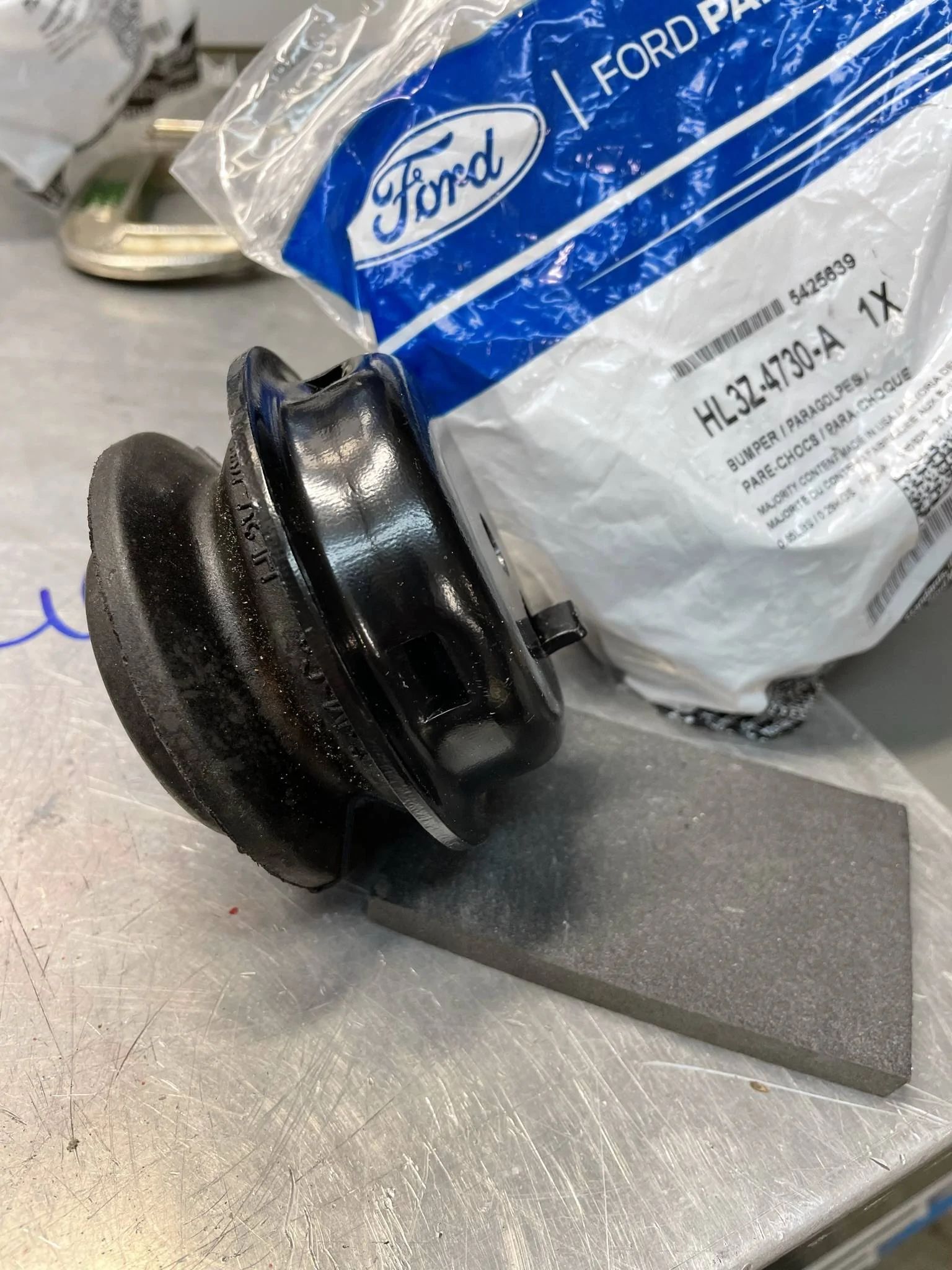

The Raptor bump stop is a complete stop, so you don't need any part of the original stop.

Any idea which raptor bump stop this kit includes? Looking to find this one so I can get some leaf springs and just add the bump stop myself. Will save me quite a bit of money.
