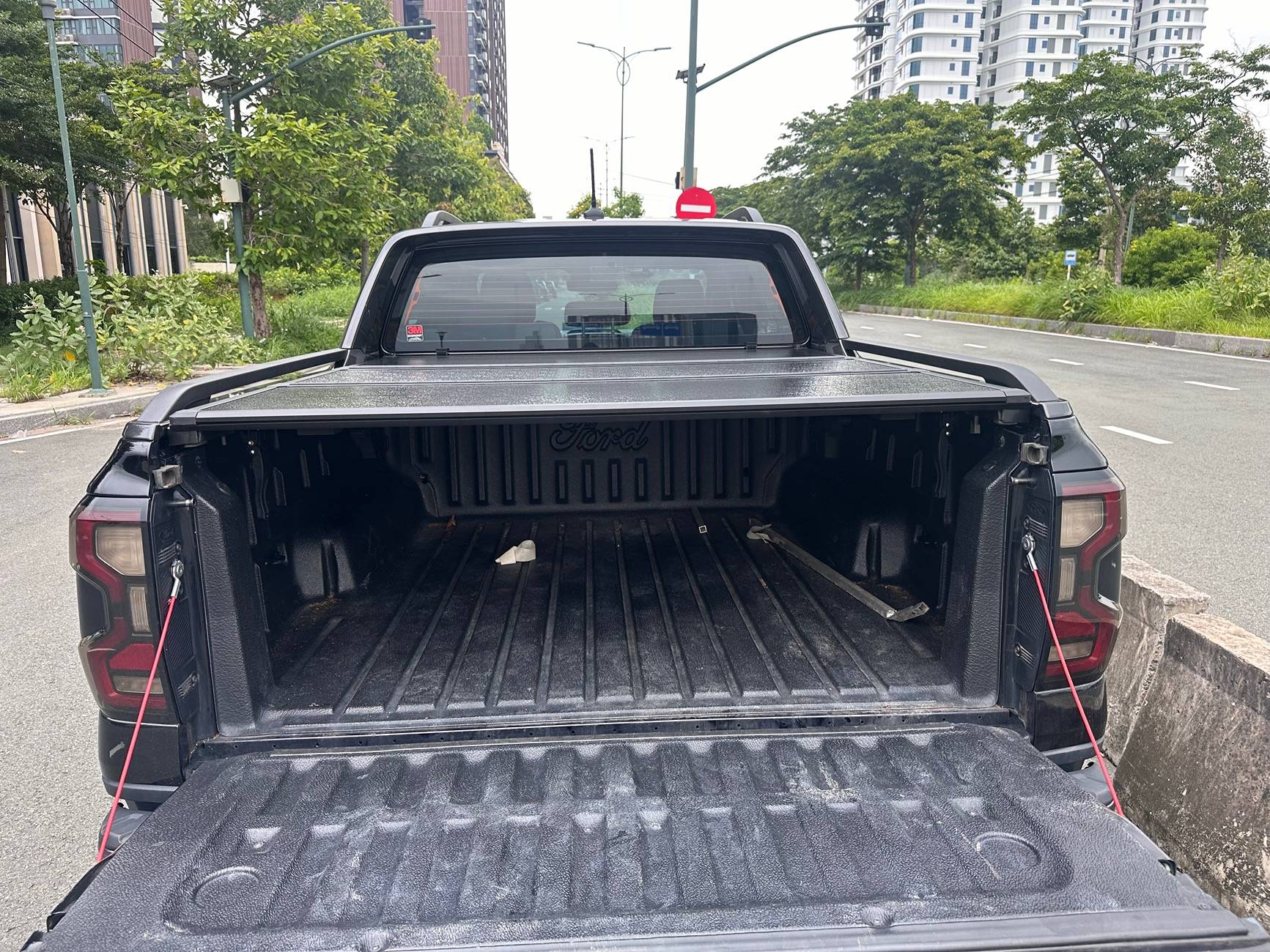

I need to install a solar battery system for the Ranger. I want to run the control wire into the cabin.
Anyone know where to run the wire into the cabin from the back of the truck? Please help me. I need to find an existing location to ensure no cutting or drilling, and to ensure it does not get wet from the rain.

Right rear underside of the cab is a factory grommet. The install instructions for the Sport bar designated this to run wires for the third taillight in the bar.
