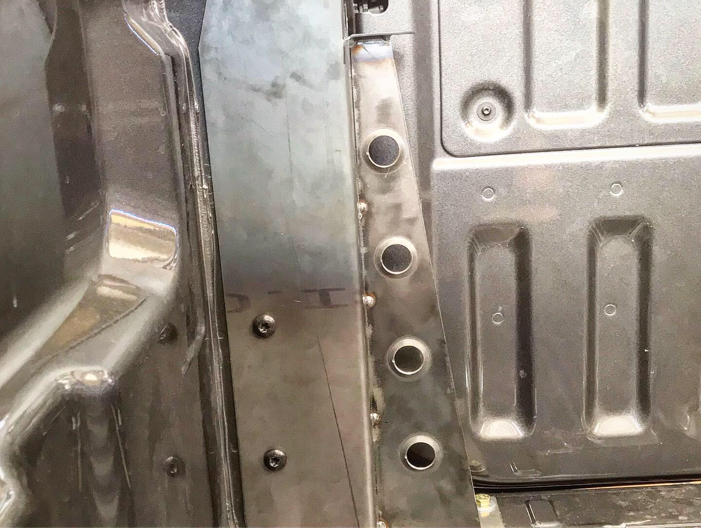

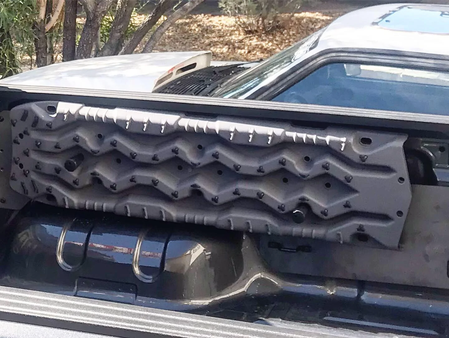

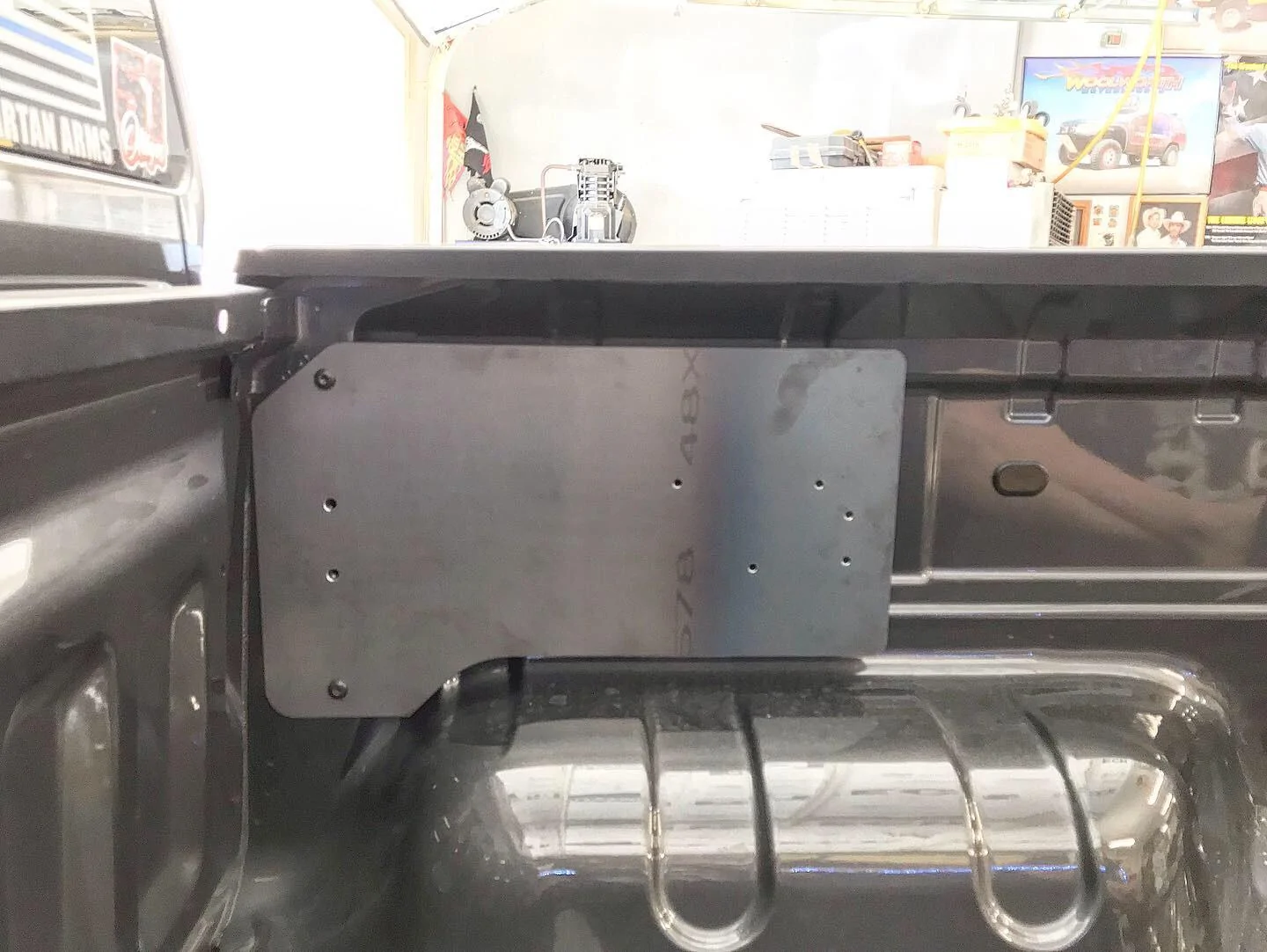

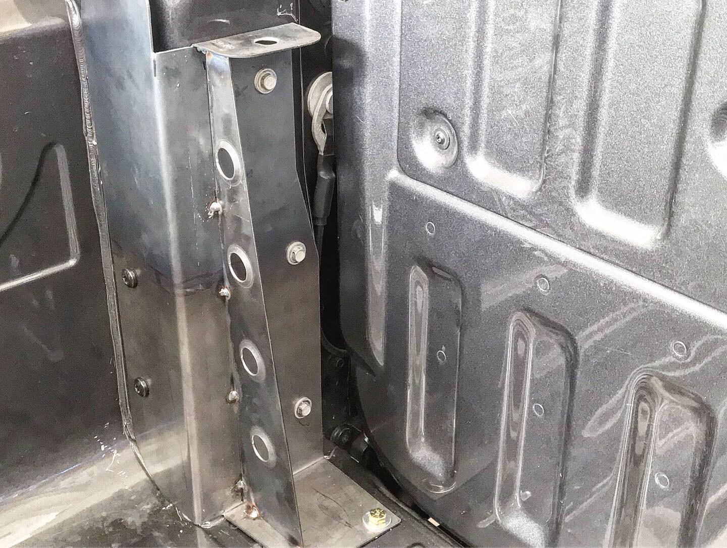

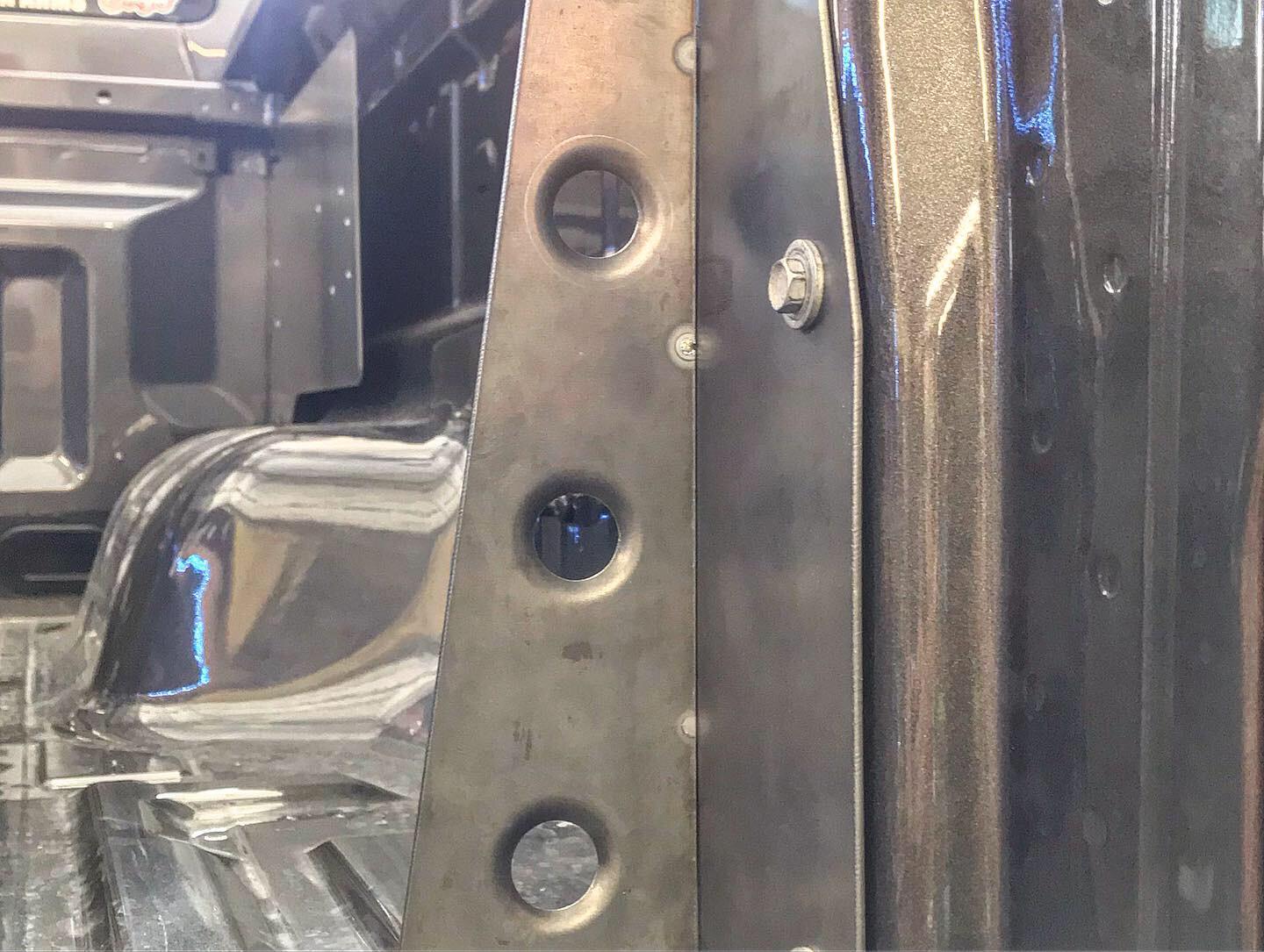

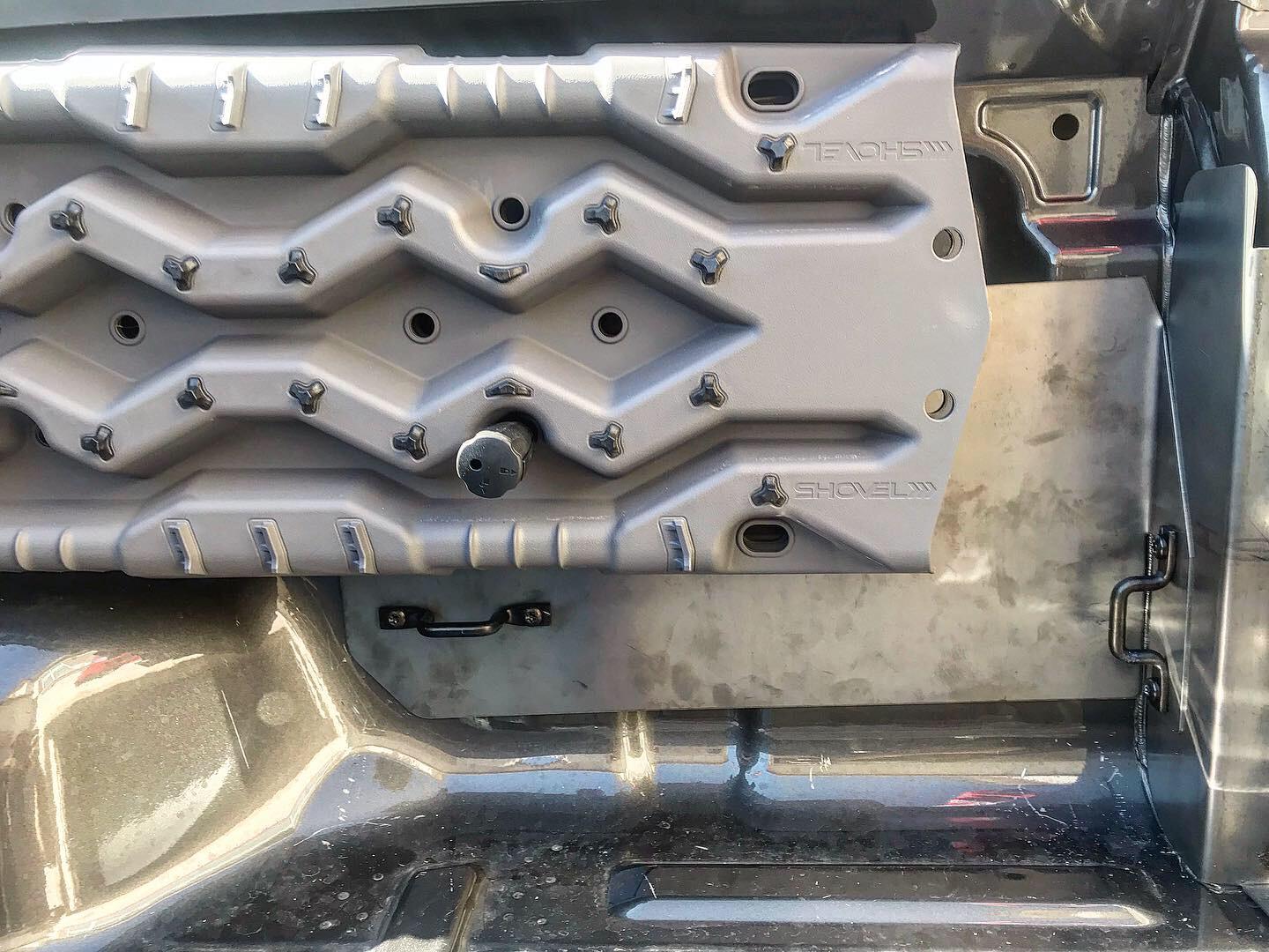

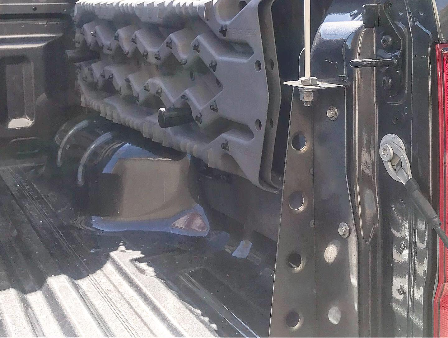

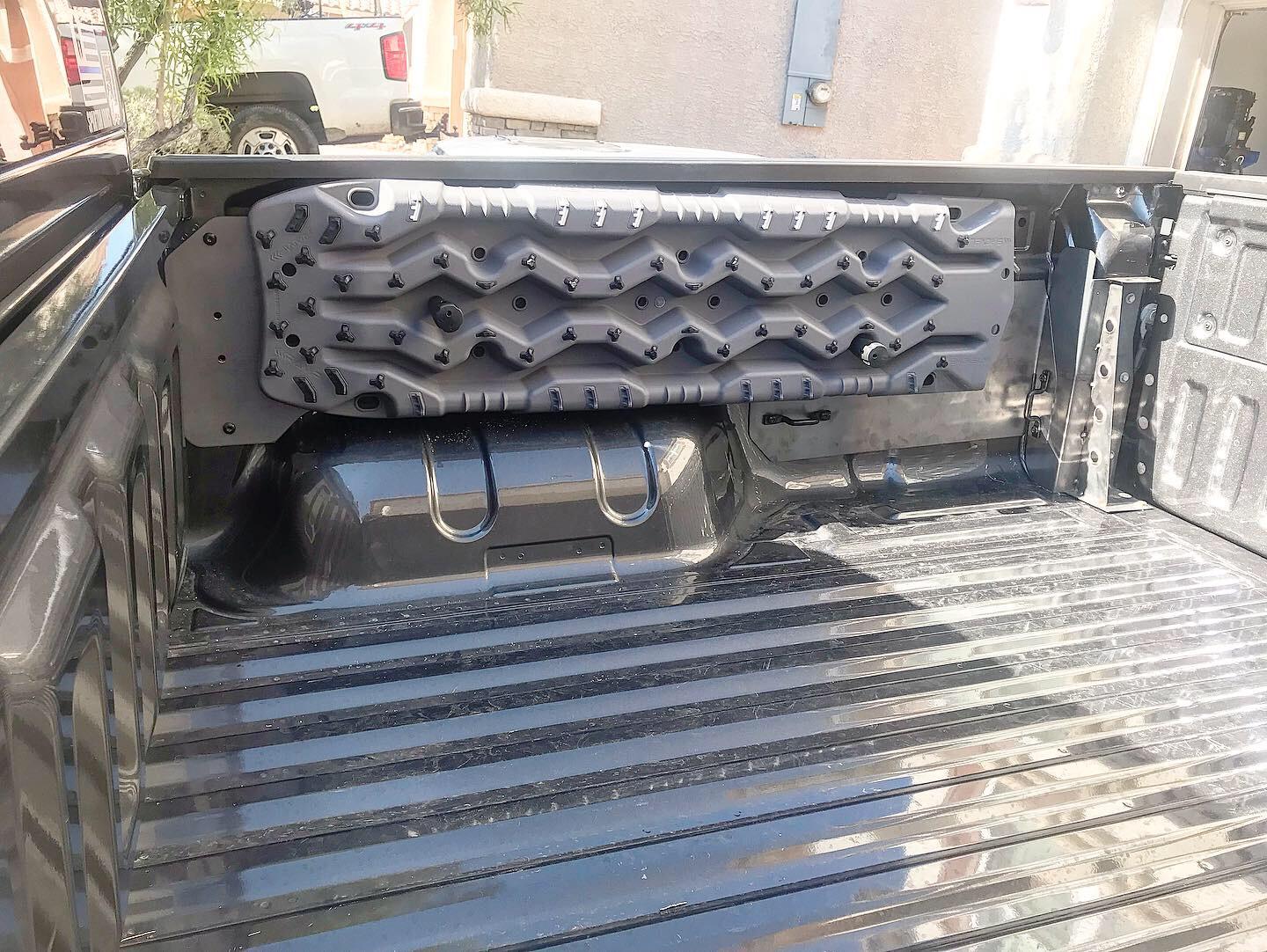

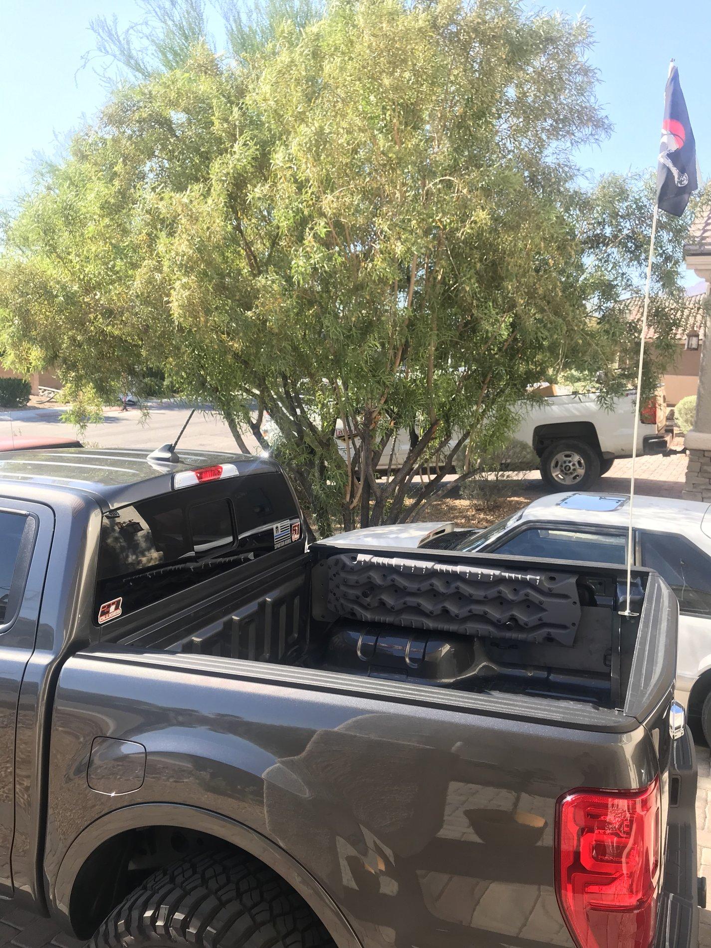

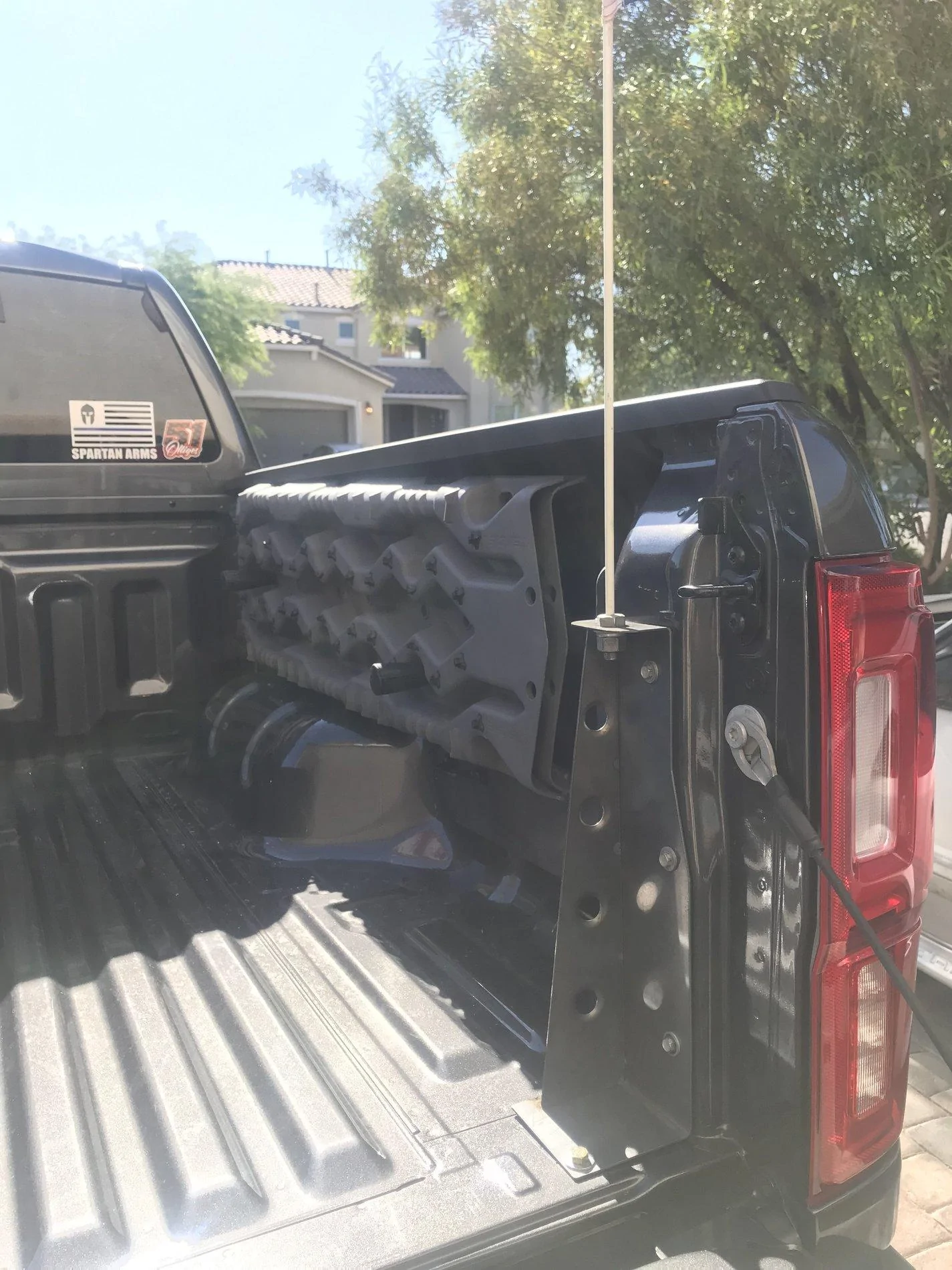

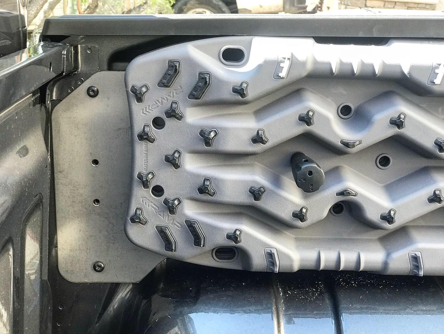

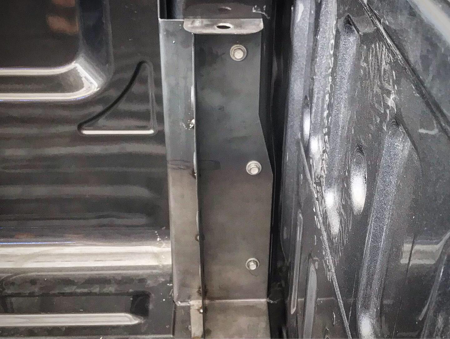

Just final test fitted some new products ready for production. Two piece recovery board (stuck board) brackets. Uses all factory tow strap anchor points. No cutting or drilling. Universal mounting holes for different brand recovery boards. Tred Pro used in mock up. Also bolt in bed supports with flag/ whip mount. Only requires one 5/16” hole to be drilled through floor of bed for strength of the bottom plate. Prototype pictured I used 16 gauge flat plate. Final product will be 1/8” flat steel all laser cut. Making final adjustments for spray in bedliner variations and thickness. Will not work with plastic drop in bedliner. Let me hear your feedback. Made in the USA.
