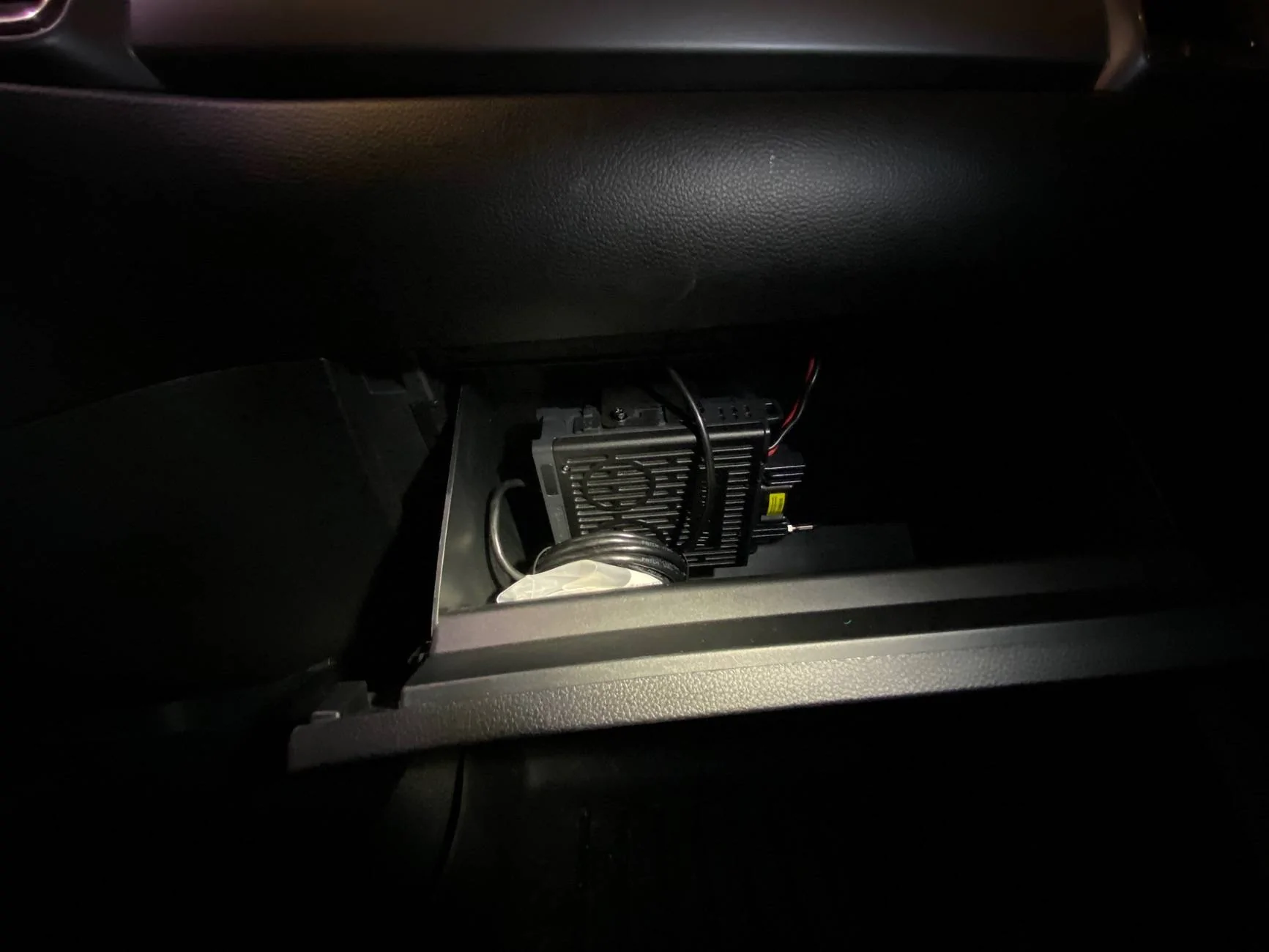

I have my GMRS remote faceplate mounted to the Builtright dash mount. The main radio body is mounted in the glovebox with power and coax run through the passenger side grommet.
Once I removed the dash tray for install, there was a pretty clear opening in the dash going from the tray area down to the glovebox which allowed me to run the faceplate cable. Not sure if that helps or not.
Trying this soon on my truck, do you by chance have a picture of how you mounted the main radio body in the glovebox?
I removed the glove box and used the mounting bracket as a template on the backside. Drilled mounting holes and secured the bracket inside. I accounted for enough space to plug in the programming cable.
Awesome, Thanks for the pic!
