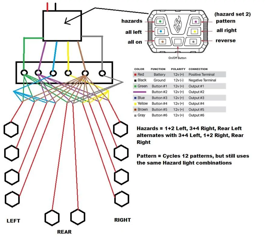

I think I have this mapped properly, but always welcome a second set of eyes to spot any goof ups.
First thing understand this feniex controller is set into pattern mode which means lights wired to button 1 (green) and button 2 (purple) will alternate between each other with whatever strobe pattern is selected. In this mode button 1 turns them on and button 2 is your pattern changer (when the controller is in normal mode, these buttons operate like any others).
I didn't say this was going to be pretty, but I couldn't think of another way to show my mapping that was not clustered up without making it a very large picture.
I have made the Feniex wiring harness lead to behind the passenger seat (back wall grommet) where I will be installing a terminal block. This way I run a single primary line from each light into the cab, then split them with pigtails off into the terminal block.
