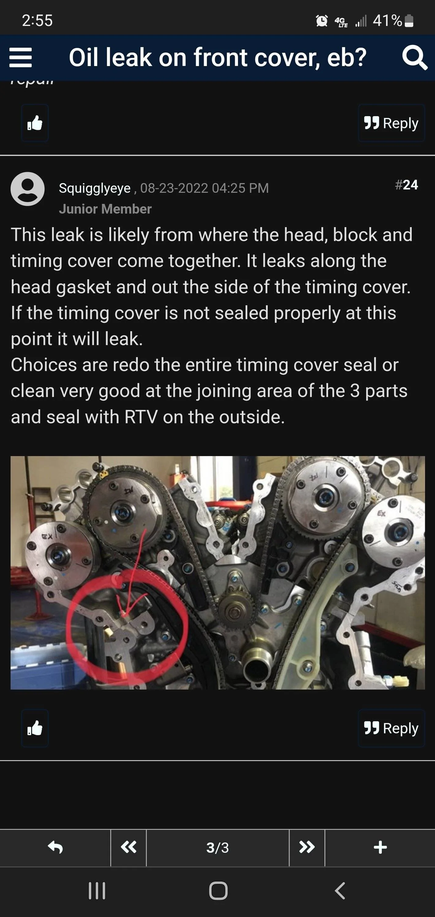

Well I have a update on the F150, we were driving it and began to smell burning oil at a red light. And of course at less than 14 days of buying it we brushed it off as another vehicle. The next morning on my commute I'm the sole vehicle at a stop sign and the smell hit the cab again no denying it this time. I popped the hood and found the timing chain cover leaking. I bought Motorcraft rtv took it to my mechanic after researching we could seal the outside it was where the head, block and timing cover come together. And it developed a misfire at high rpm enough to put the check engine light on. I bought plugs and coil boots, ford recommends changing those when plugs are changed.

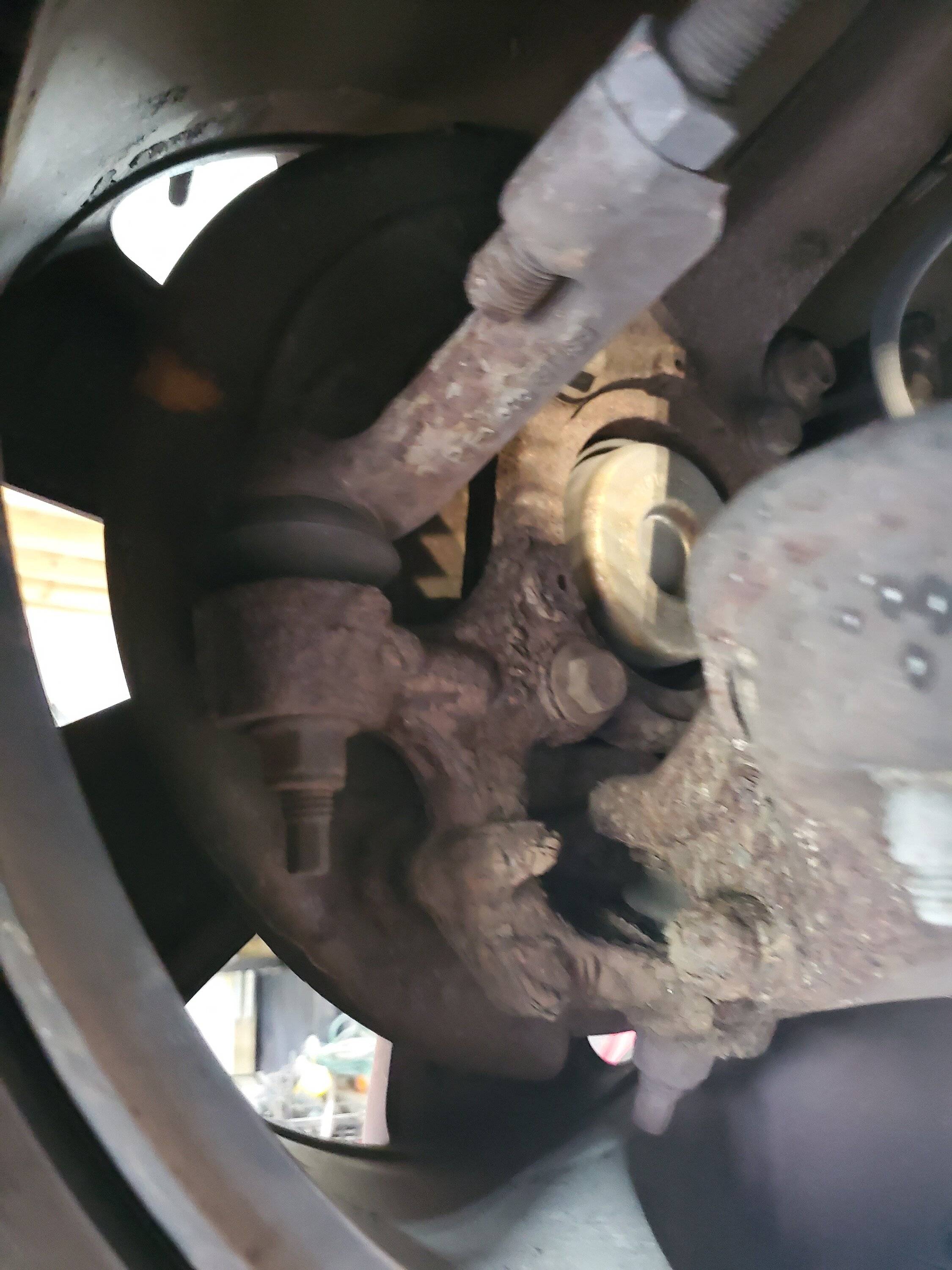

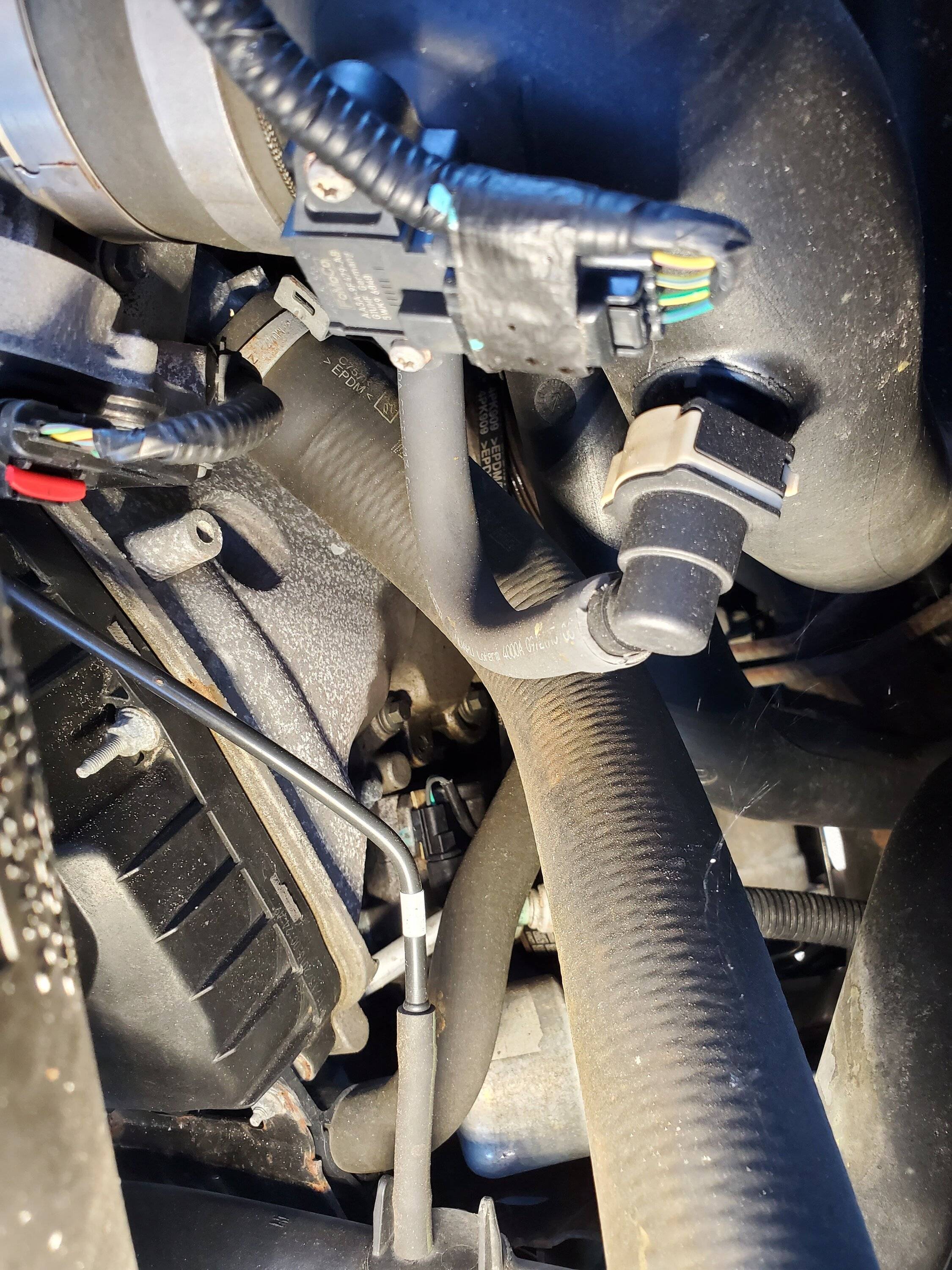

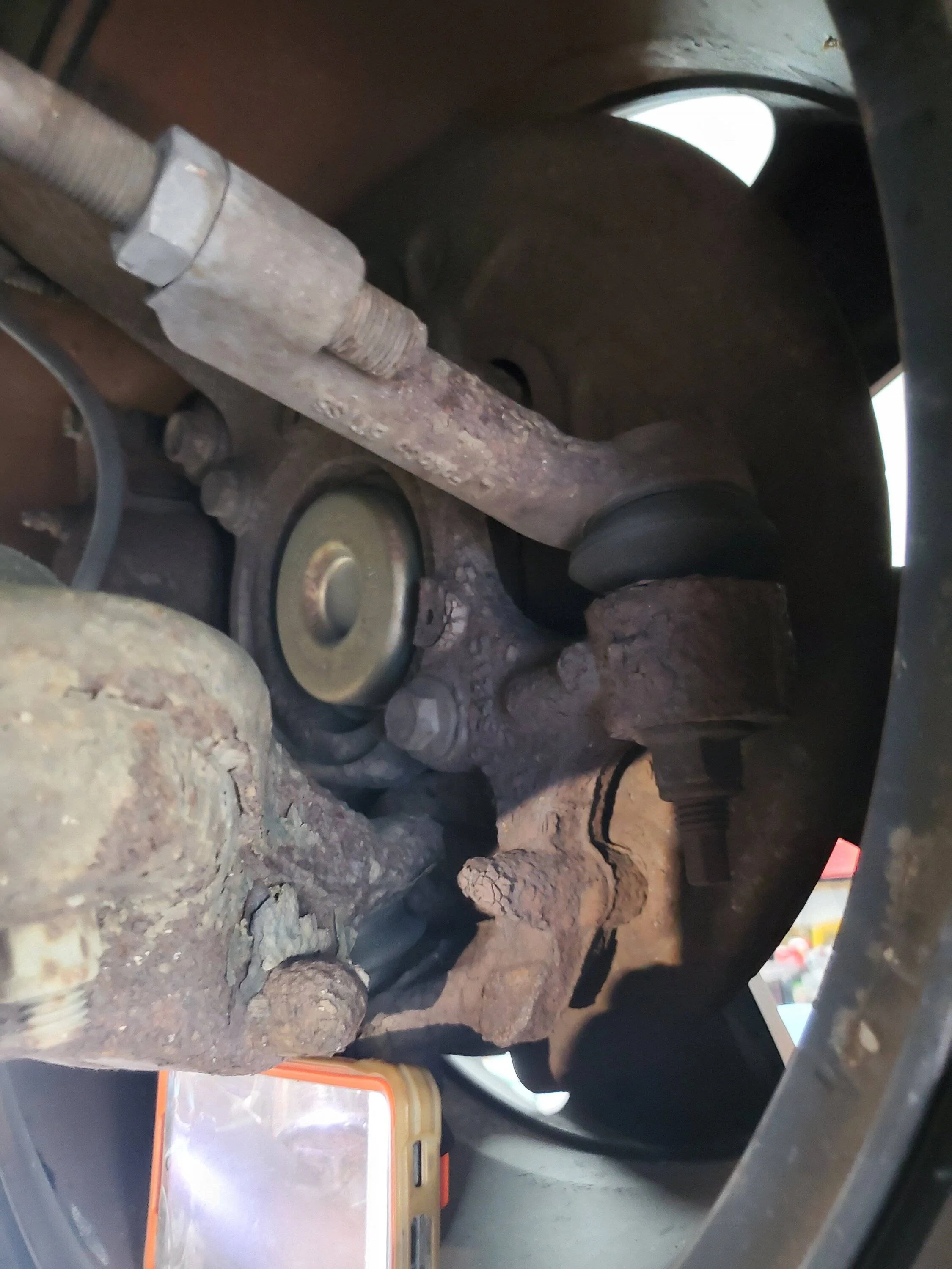

I get it to the mechanic we put it on the lift it's worse than I thought I have a valve cover leaking, the middle plug seal in the valve cover on the opposite side leaking. A turbo leaking coolant, the vacuum pump leaking, the water pump starting to leak. The remote oil filter block is wet, the rack and pinion plugs below the oil filter are saturated.
And for an extra kick in the nuts the front knuckles and lower A-arms rusted badly.

Here's photos of the timing cover leak and knuckles.
