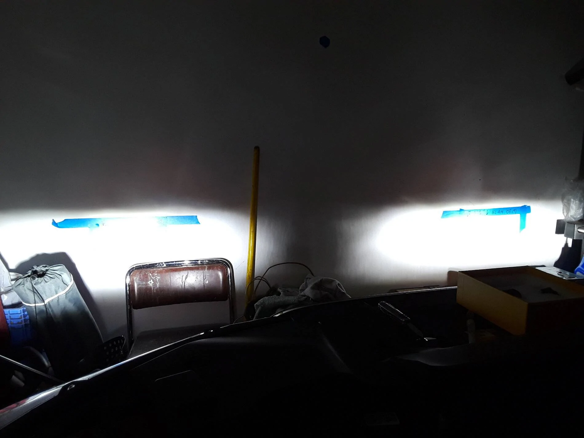

I did buy some Auxito H11 based on comments here! Thank You!

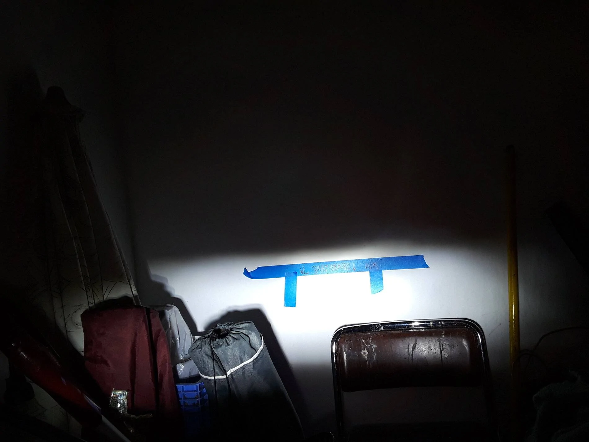

Clocking at original and 3/9 created a lot of glare.
I was getting close to sending the LEDS back.

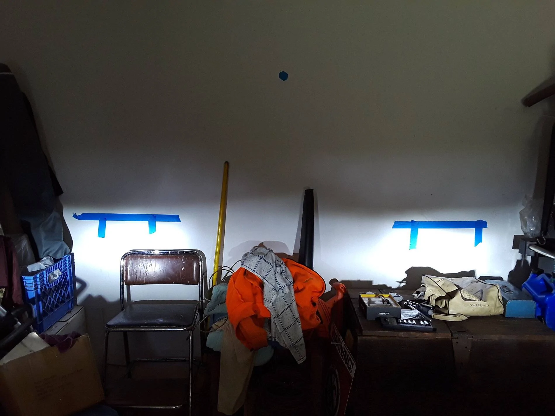

This morning I went out, released the set screw, installed the locking base, then turned the
LED to various settings and found a sweet spot where glare was reduced and beam pattern improved.

Good call on the set screw and beamer rotation. I know there are a few posts on it in all the lighting threads for headlights. Some bulbs are fixed and you are out of luck as far as that availability goes.

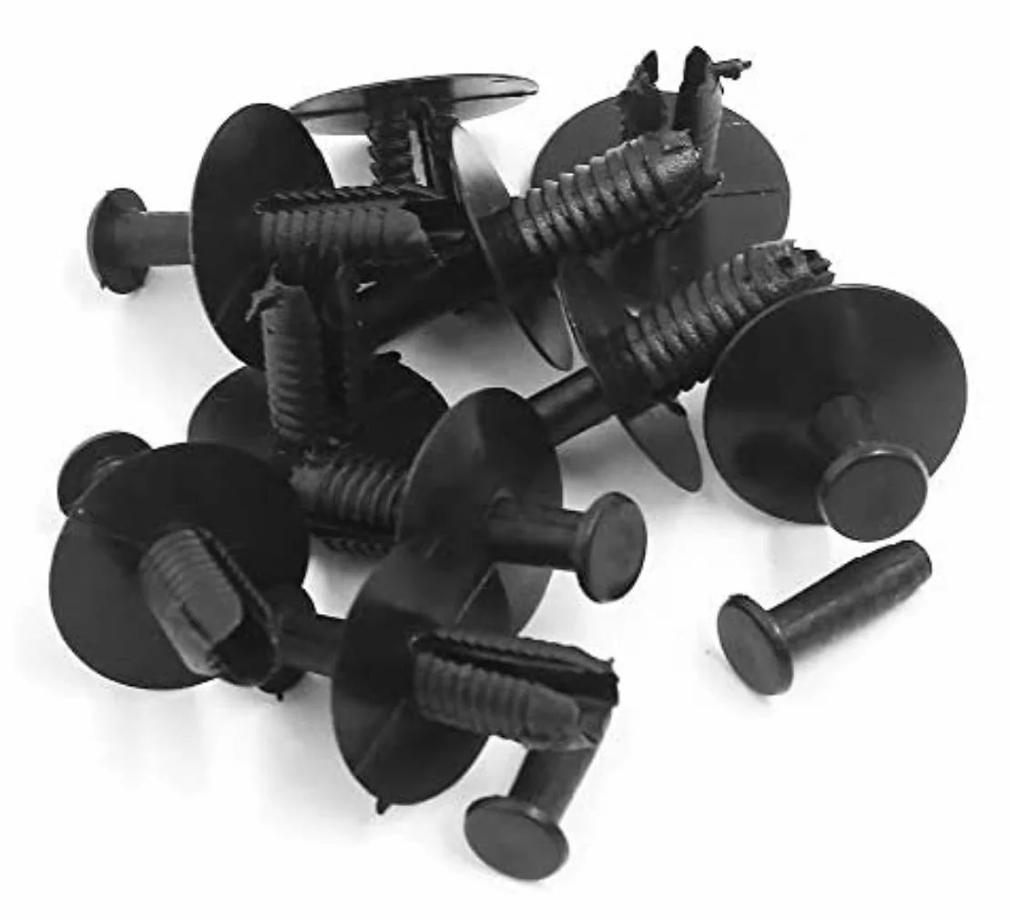

Got to agree with Rob here. Only thing about it that I didn’t like was the plastic rivet type they used. Changed mine over to pop head type and it’s as easy as it gets now, that’s with leaving the tire on too!

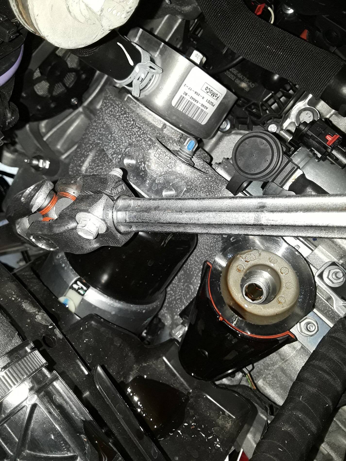

First oil change 3-20-2021 at 4628 miles. I am not a fan of this BS. Pull the skirt retainers and move the flexible protection. I would rather have it dump straight down. I need to get a larger drain pan for the 6qt capacity.
I prefill my oil filters before installing. Straight up get completely filled,
side mount filters get 3/4 fill.

To each his own. I found it very easy to get to and to change. And that drip tray works perfectly for me (once I figured out where it drained to). Changing the oil in my Ranger is significantly easier than changing the oil in our C-Max.

First oil change and I was not happy.
I may give it another chance.
