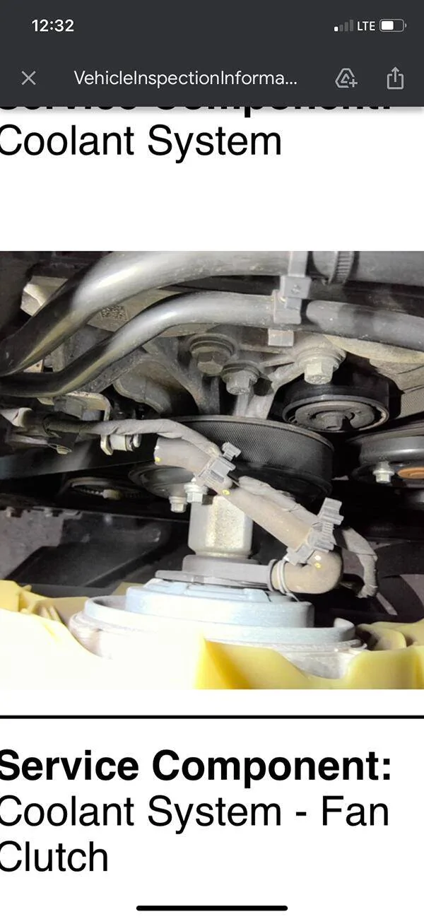

Went to another mechanic, they ran a pressure test on the cooling system, didnt find anything on the cooling system but found this hose (picture attached down below) disconnected. I looked up what that hose does and it looks like its an anti-rotation device that also protects the wire next to the clutch fan.
Went to Ford dealership and they told me that that hose was part of the clutch fan and wanted to charge me $1100 to replace it. Crazy right?

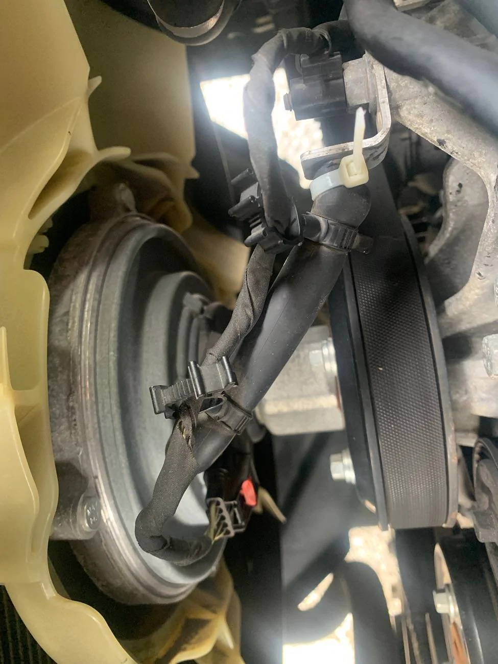

So I zip tied it myself thanks to other posts on the forum. (2nd picture attached down below) Thinking I solved the problem, went back to the highway and still overheated.

But for broke down on the road - I would replace the T-Stat and Coolant Cap, but with the Fan Clutch showing evidence of (support hose damage-failure) that would also be a high on the list of things to check but as I said the only way to fully test it is with a scan tool.
