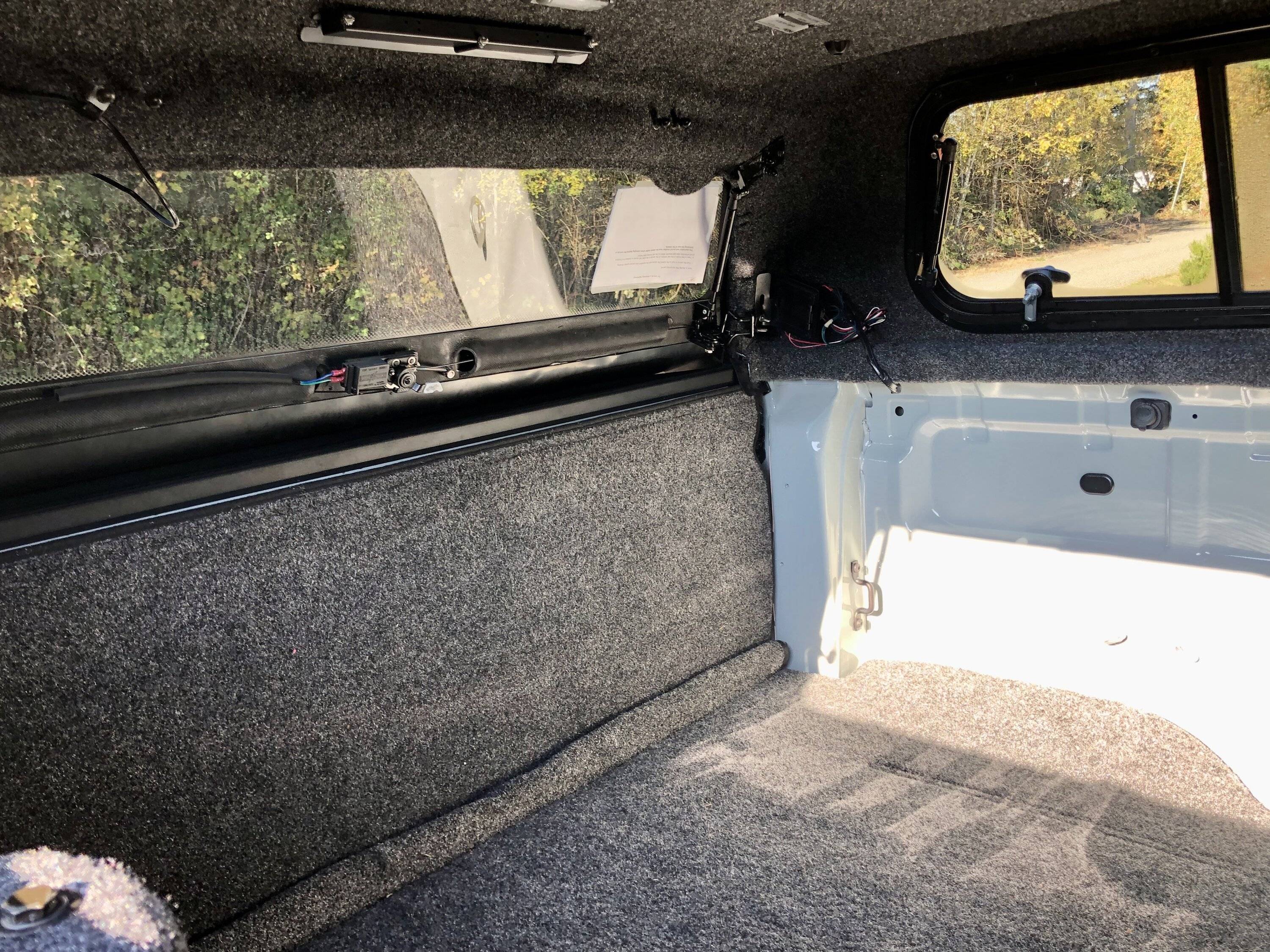

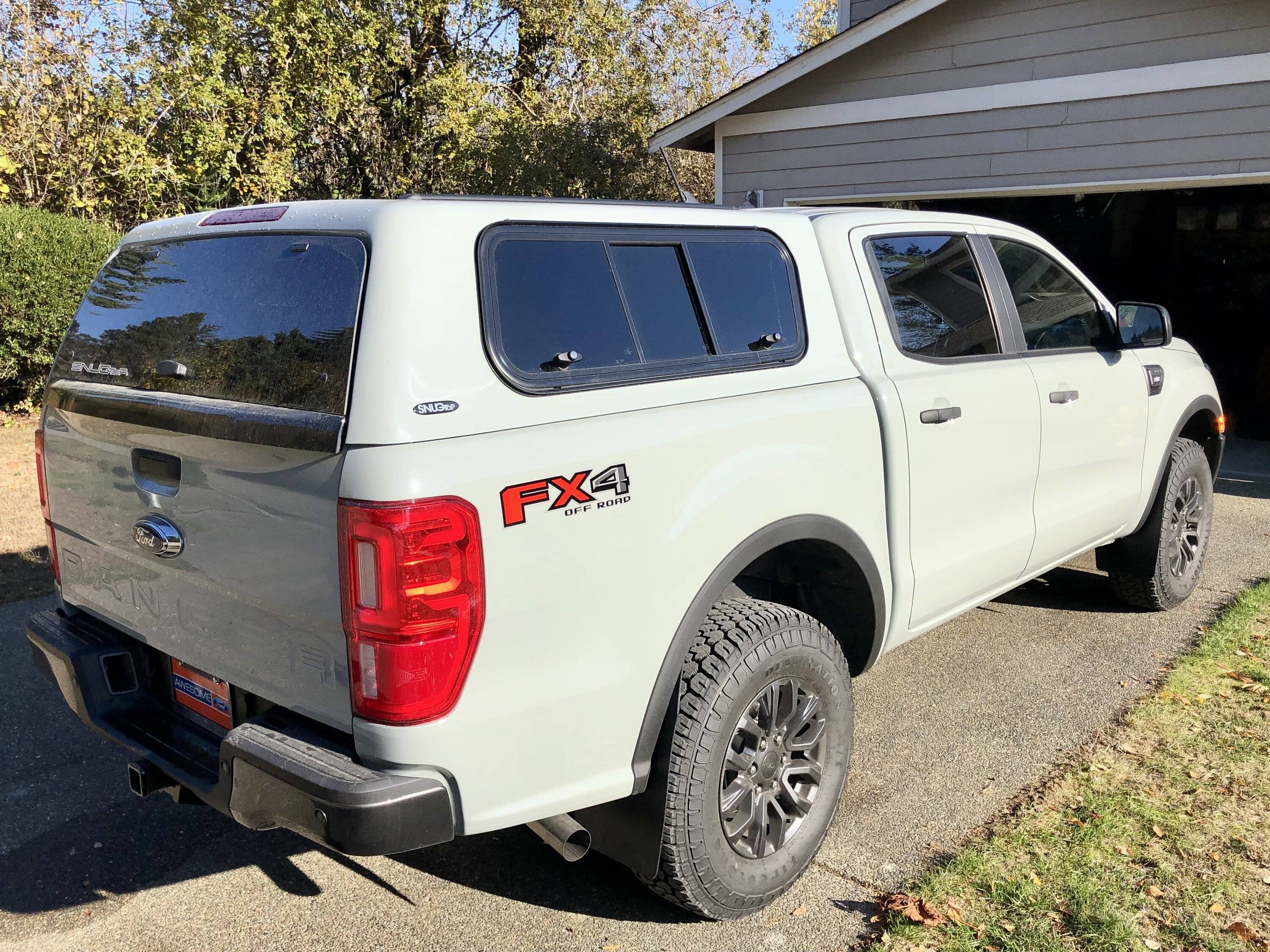

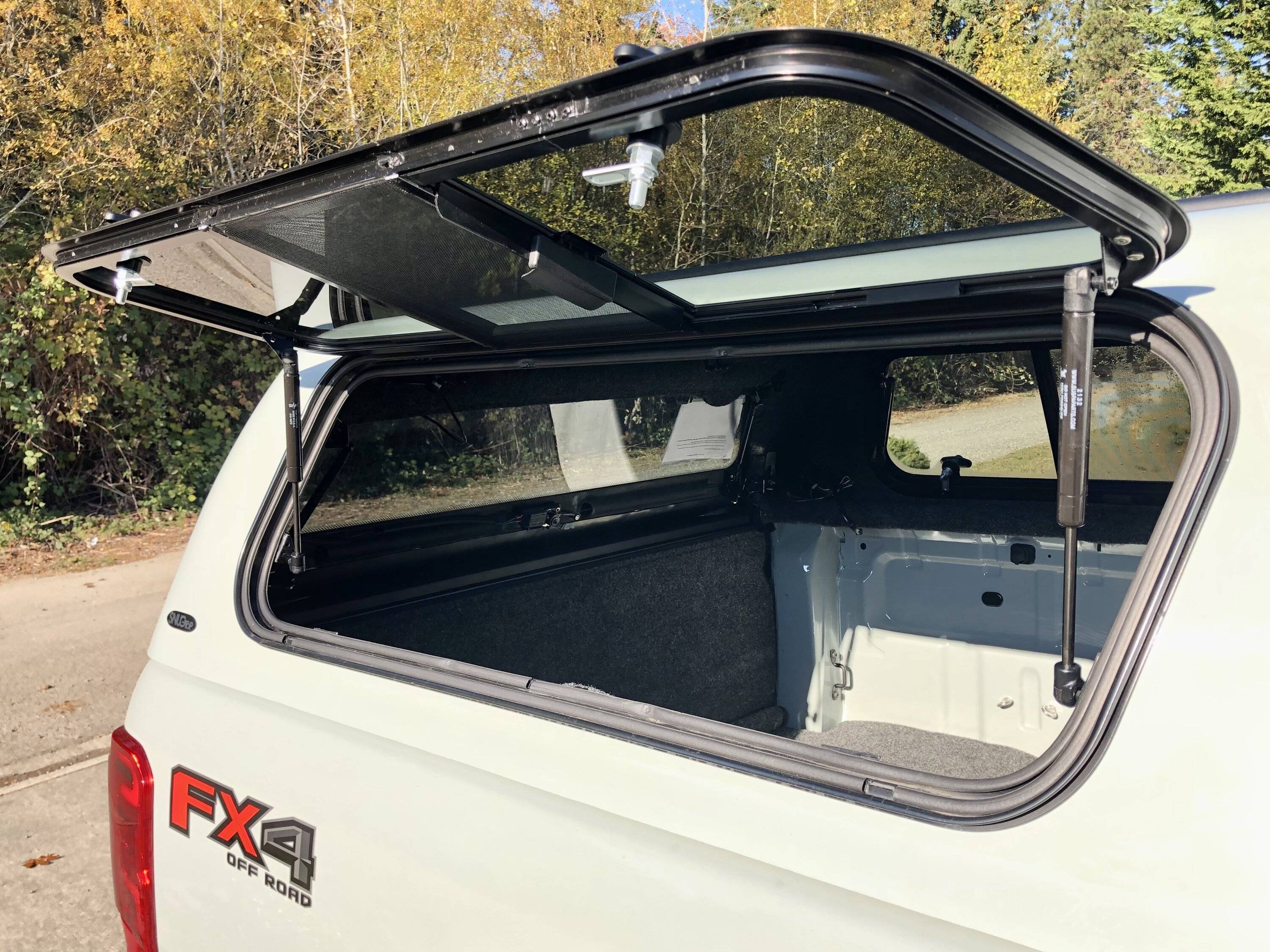

Waited 2 months after ordering, received and immediately went camping.
Initial impressions are good! Fit and finish are acceptable, at minimum. Paint match is great. Hardware and components appear to be decent quality. No janky rivets or screws that I can see. Haven’t done a heavy rain or car wash test, I’m bracing myself for leak tests.
Due to the high bedsides, the canopy and windoor depth is a little narrow. So glad I got the windoors, used those a ton while camping. With multiple layers of tinted glass between driver and the rear outside, rear view mirror functionality is restricted. I got used to that by the long drive home.
Multiple quotes, best out the door price (including 10% sales tax) was $4002, optioned with Ford key fob sync lock, windoors with vent slider, tilt down front window and roof tracks. I installed a BedRug, too, which I love.
I’ll report back with problems, hopefully won’t have to!

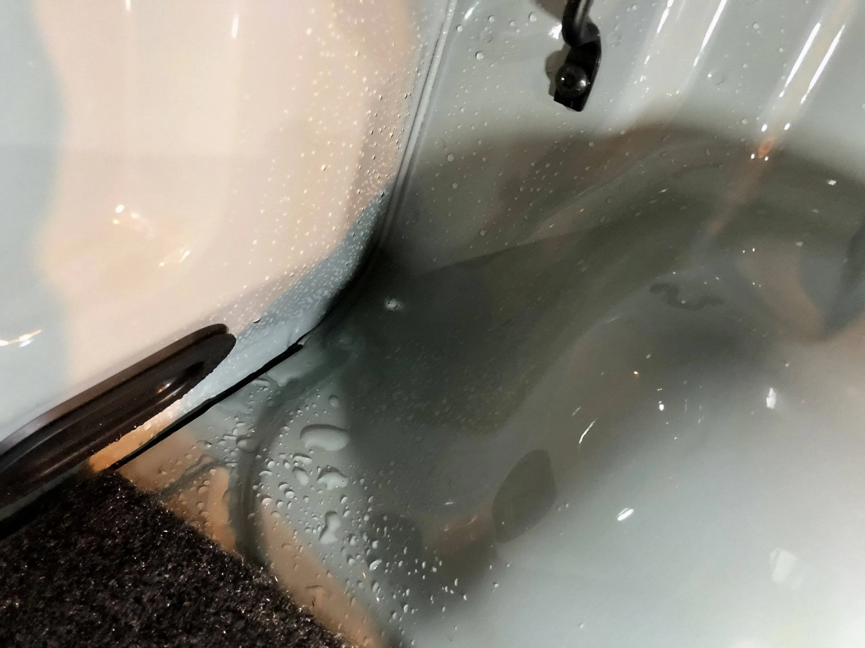

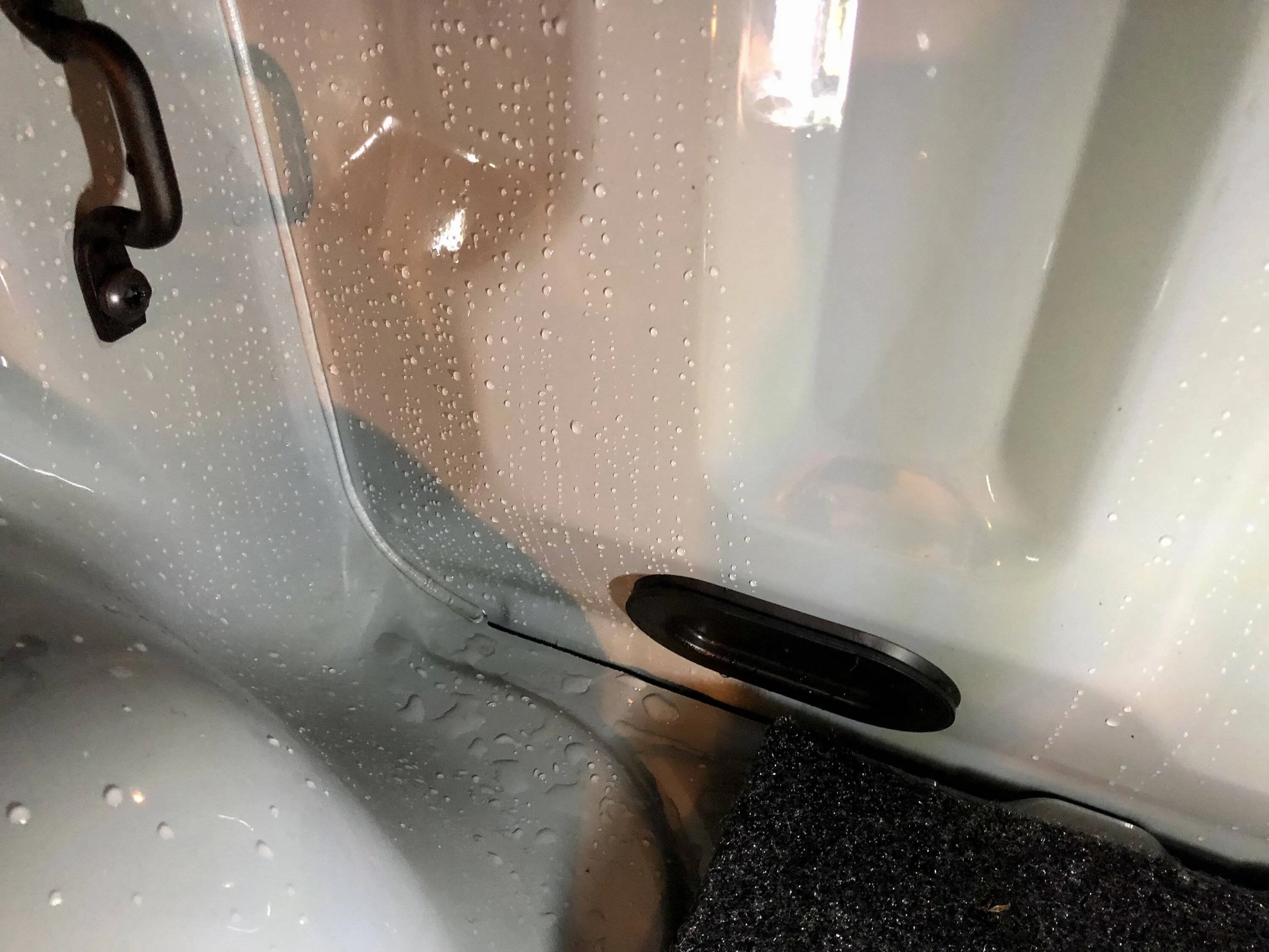

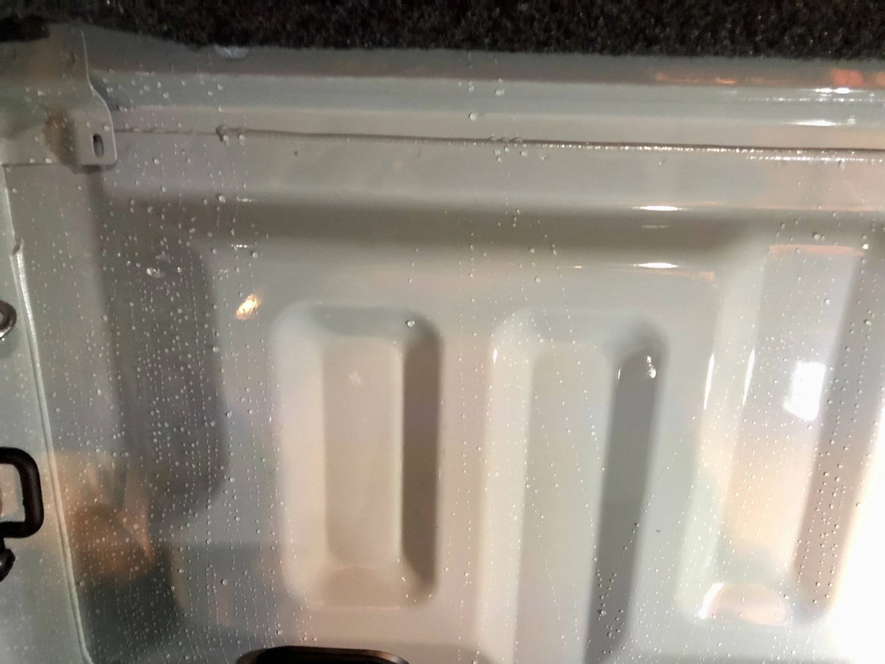

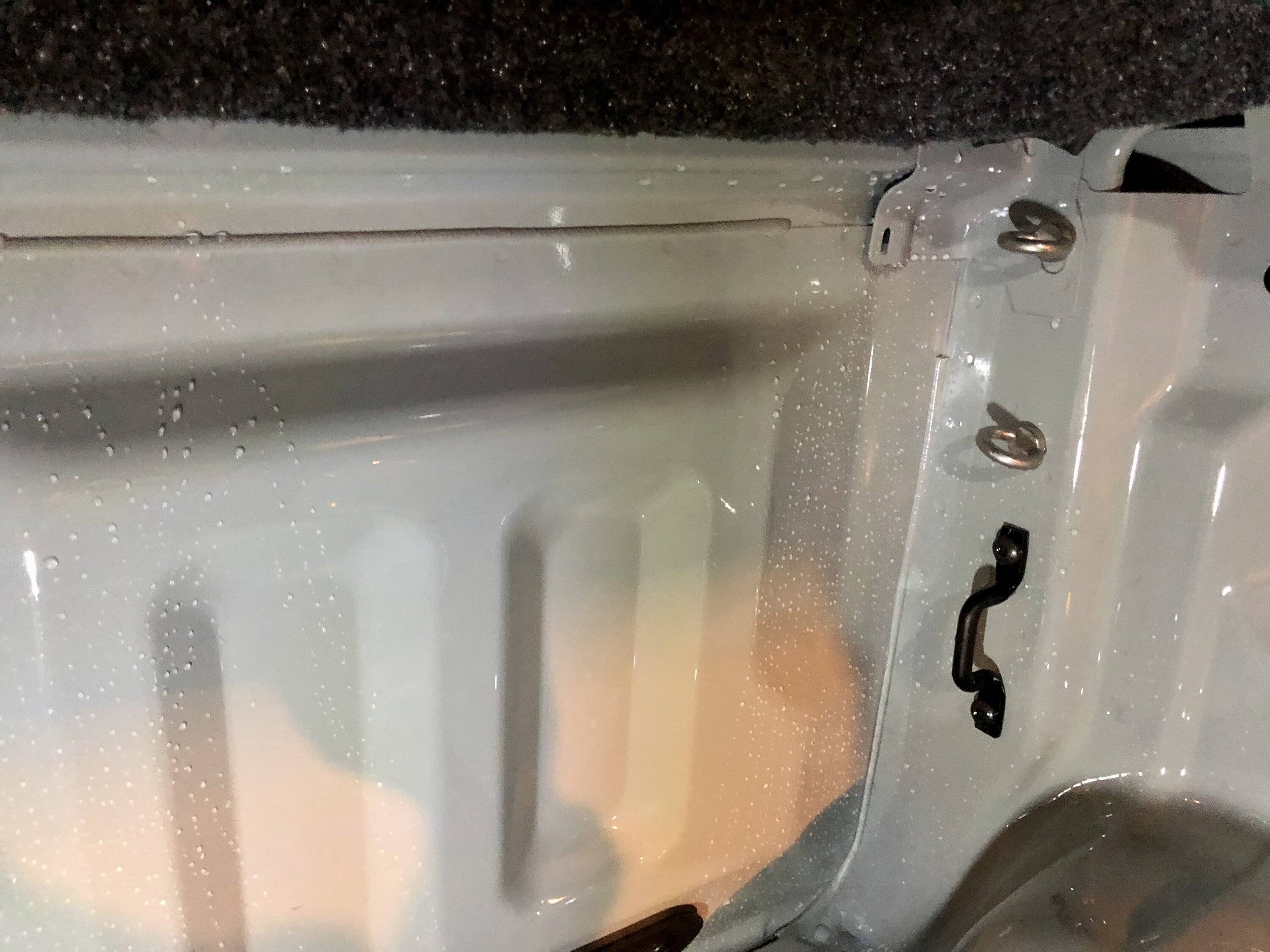

UPDATE - after the hose and heavy rain test (driving and parked), no windows or back latches leak BUT the seal between canopy front and the front bed cap leaks some water.
The Ranger front bed rail is lower than the sides. Snugtop and others use a gasket material to address this. Snugtop uses a double bulb rubber gasket, but this is obviously not enough. You’ll see the rain water collected in the photos below. It’s drops of water, not huge pools. This was after very intense rain and freeway driving in western Washington. So, it didn’t let in all the water as that would be an ocean with these prolonged heavy rains
Some minor drips are expected, but for $4k I’d like a better seal. I’ll call my dealer and see what they will do about it. Again, I’d call this an install issue, no other part of the canopy leaked (except on the rearmost bedside, at the open tailgate gap but that is Ford’s fault, not Snugtop. This is minor intrusion, btw).
Photos of front of canopy. Might need to zoom in but you’ll see all the droplets of water on the vertical and floor surfaces.
