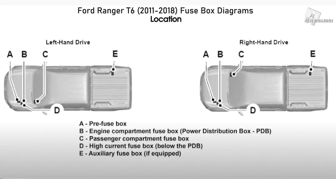

does this help?
I will look for that panel tomorrow in the TRUCK BED. Who would have thought to put a fuse panel there. Hmmmmm
thanks again for your reply.
I will let you know what I find.

If this truck had that AUXILIARY FUSE BLOCK behind a panel on the right side of the bed, just past the RIGHT WHEEL WELL, it would have separate fuses for these lights but this truck does NOT have that fuse block so I will concentrate on the wires.
