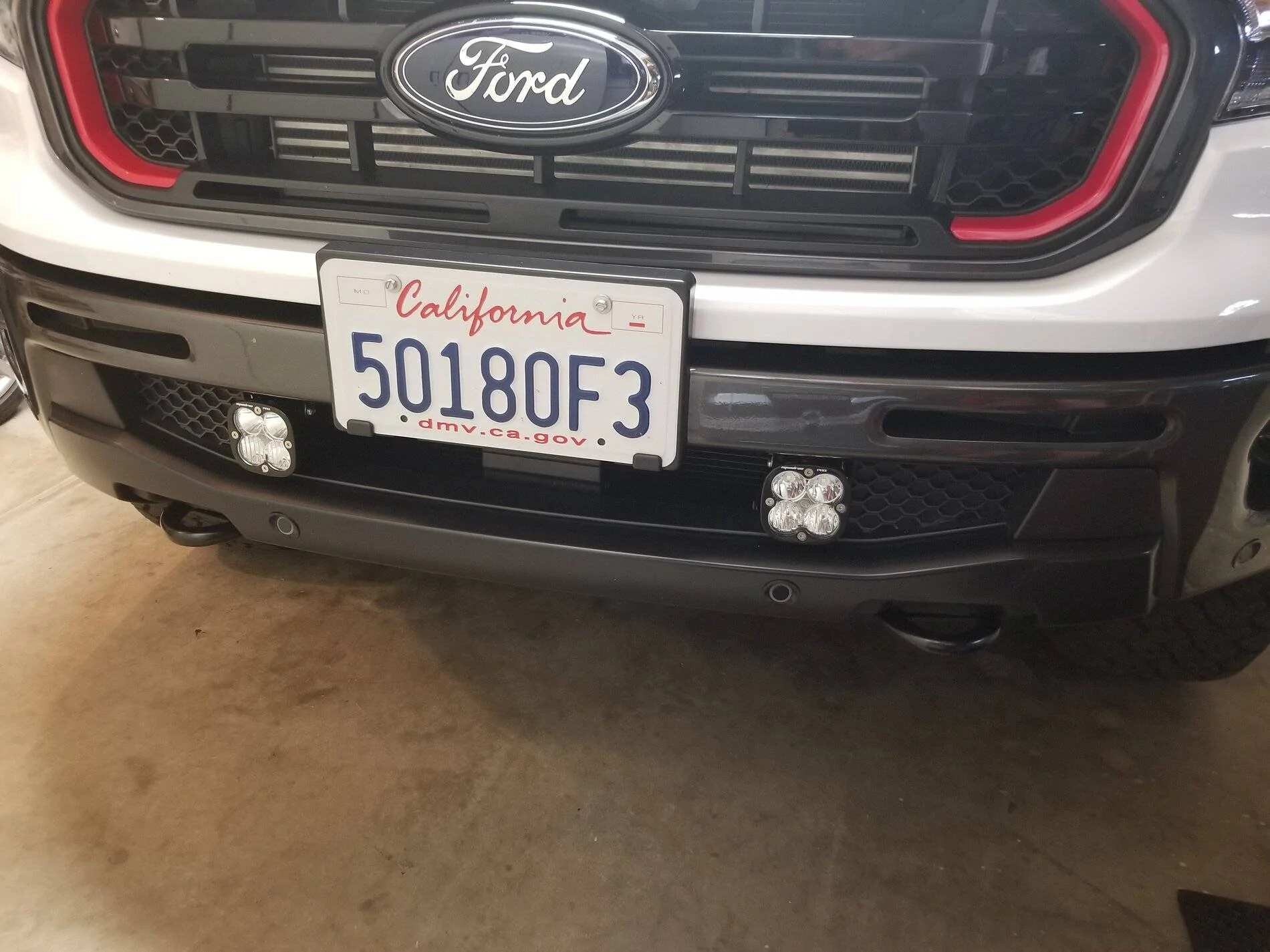

Can you provide specific guidance-method for aiming @Baja Designs Squadron Pro Combo pattern lights mounted in the grille cutout in the outer most location? This is a Lariat with OEM LED headlights and LED fog lamps. The purpose for these lights is off road and to supplement factory lighting in very dark conditions.
I have aimed them using my garage door and the pattern of the high beam, low beam, and fogs as a guide. Now the hot spot slightly overlaps the low beams at the top of the cut off.

My suggestion would be to have them hit a wall about 20ft away at the same height they are now. To have them meet the headlight beam on the garage door means they are on an upward angle and the further away you get the higher they are going to shine providing you sky illumination and not our in front where you need it. My 2cents.
