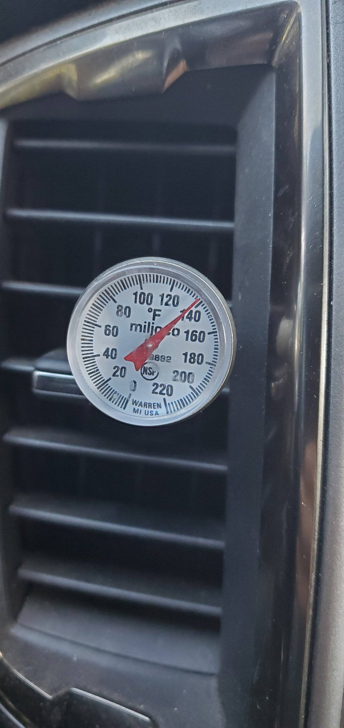

I have put an HVAC thermometer in the vent, this morning it read 100F so it works good, havent found a heat button yet LOL I just figure it does it based on outside temp?
AC works good too I just leave the thing stuck in the vent :)

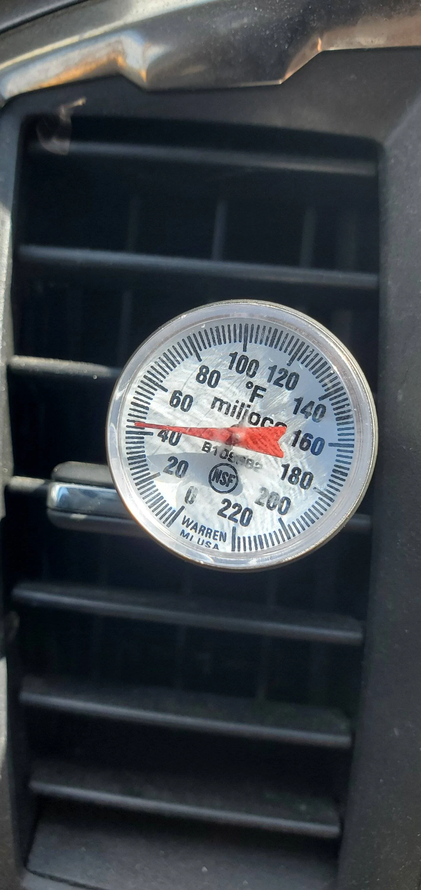

the right picture when the heater was on.... WTF you could cook an egg in whats coming out of the vent!
Dgc333
Aug 24, 2021
1,743
4,113
21 Ranger Lariat
The thermostat needs to open before you get any heat. How long was it running when it started blowing warm?
I have never owned a vehicle that required the thermostat to be open to get heat. When the thermostat is closed water does not circulate through the radiator but is still circulating through the block and heater core.
All of my vehicles you start to get heat as soon as the temperature gauge starts to move. Certainly don't get full heat until the engine is up to operating temp and the thermostat is open but there is still air blowing that is warmer than ambient.
