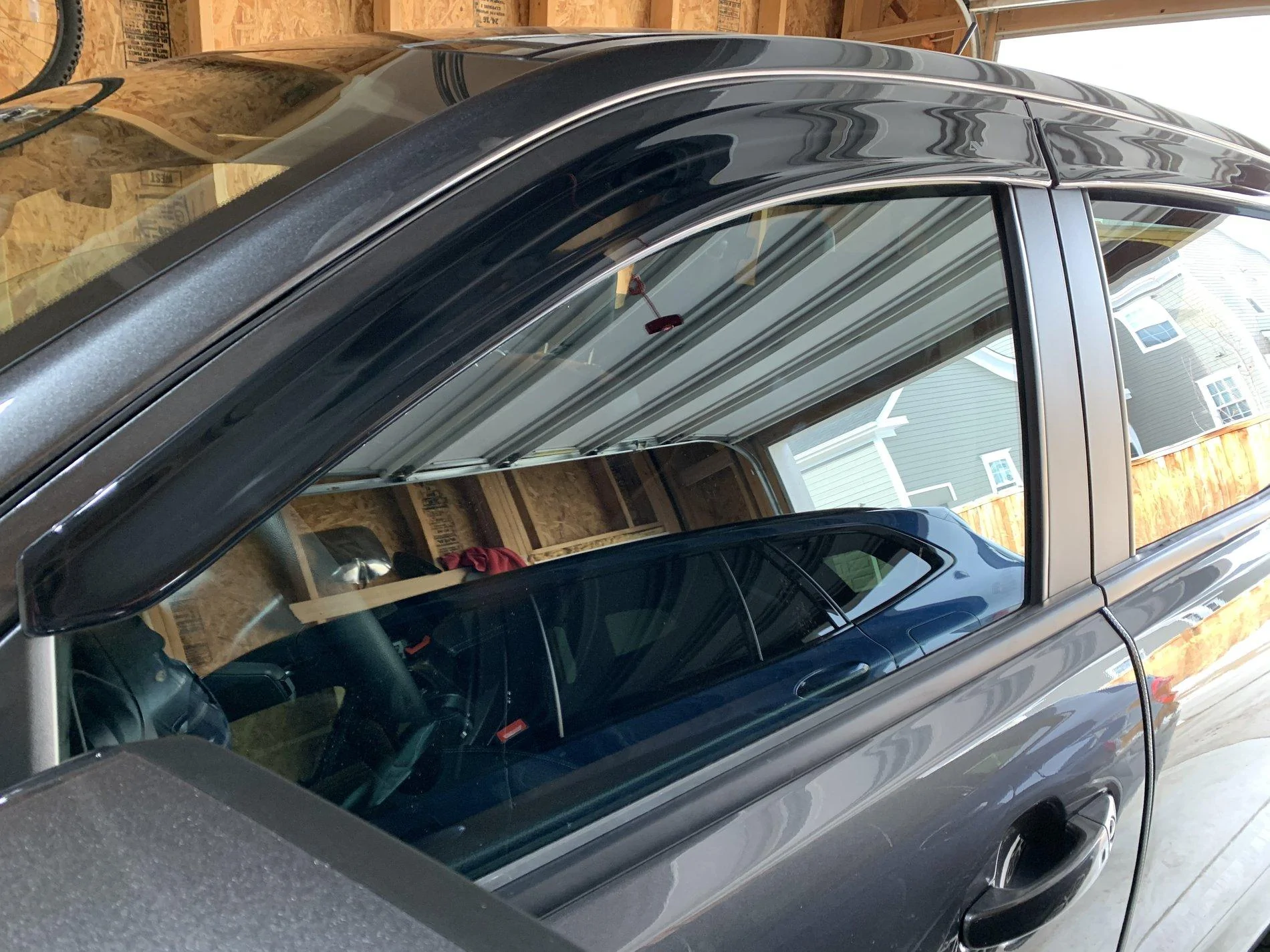

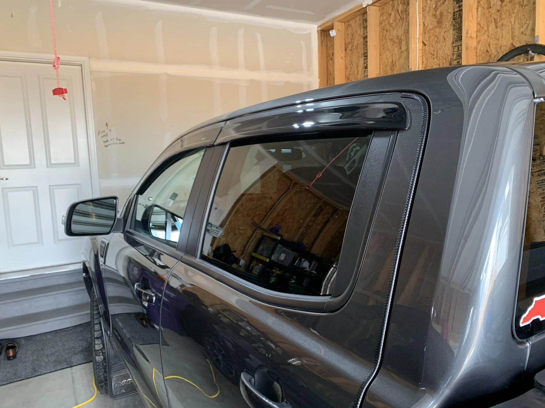

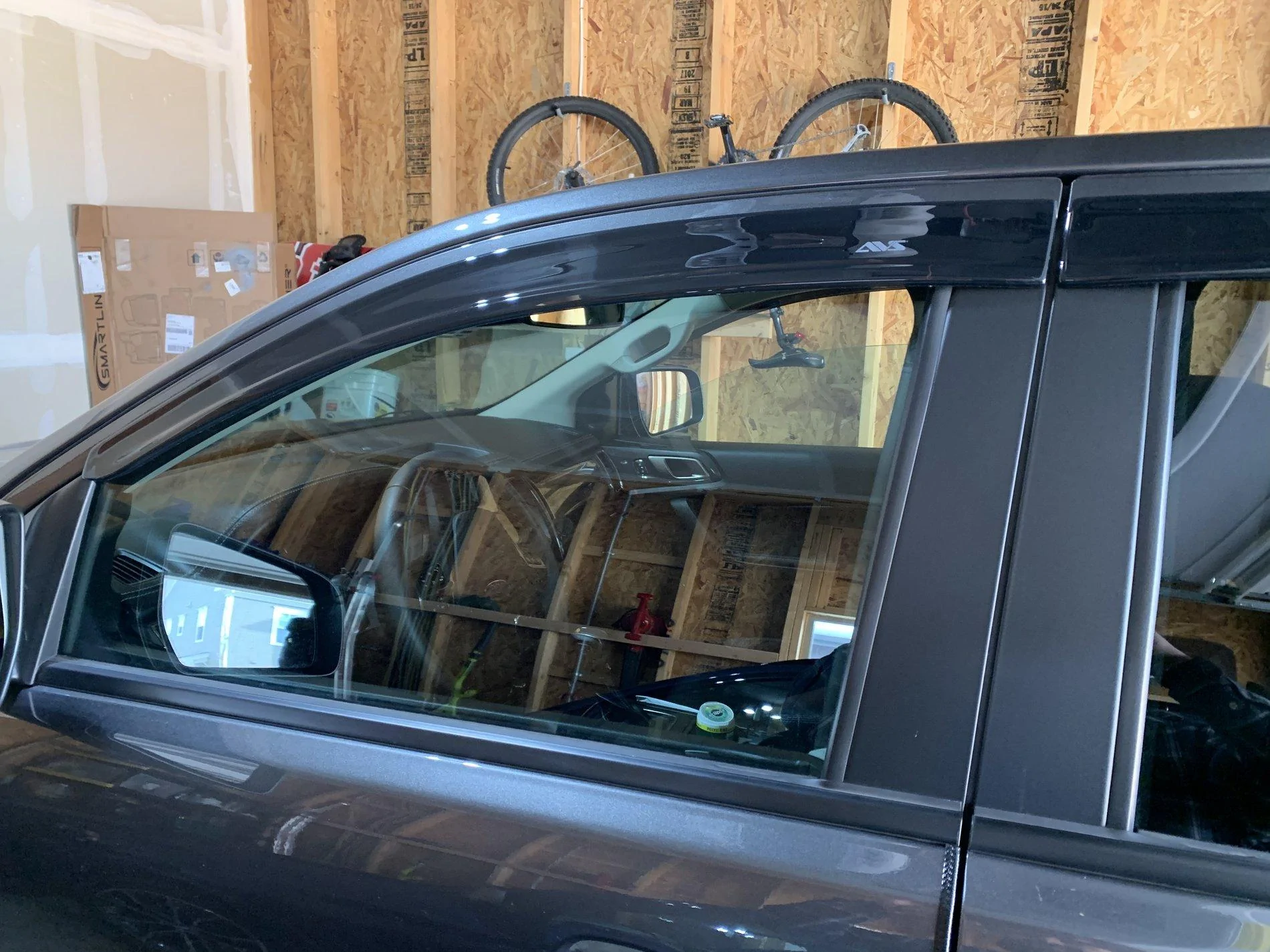

2019-2020 Ford Ranger SuperCrew AVS Front & Rear Low Profile VentVisor Side Window Deflectors (Dark Smoke)
Easy install just above windows. Fit well. Look good. Allow in air without letting in the elements. Big fan of using these to let out steam and moisture without using the windshield air/defrost.
Purchased at Stage3motorsports. Only took a few days to arrive. Link below.
https://www.stage3motorsports.com/8...e-VentVisor-Side-Window-Deflectors-Smoke.html

Nice! I have the Weather Tech In-channel deflectors after having the stick on style on my Focus and honestly I'm kind of bummed out by them. One of them hangs up the window because it's not totally secured to the frame on the inside. :( These look great though! Definitely effective too!

I’ve never had visors that went in the windows. I’d be worried they would do what you’re saying. So far these work well.

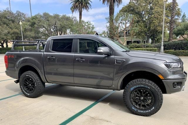

Sick!!! You're truck looks great. I'm doing exhaust next then lift and tires. What lift did you end up doing?
It 2.5” leveling kit. Might be doing an inch in the rear too. Going to see how much sag there will be once I get my RTT and gear in the back.
Gotya...when i do the leveling kit i might add an extra leaf in the back. Will be towing a boat and don't want the uneven ride sag look. Looks good bud. Bought two new cars and doing minor mods now..waiting for some deals to do more. Cheers

Pay attention to the ends that stick to the plastic B-pillars. Mine had started to pull away after about a week. I prepped properly, religiously, but they still pulled away at two spots. I ended up cutting another piece of 3M tape (use this regularly for work) and doubling up at those points. No issues after that. They looks great and work even better.
