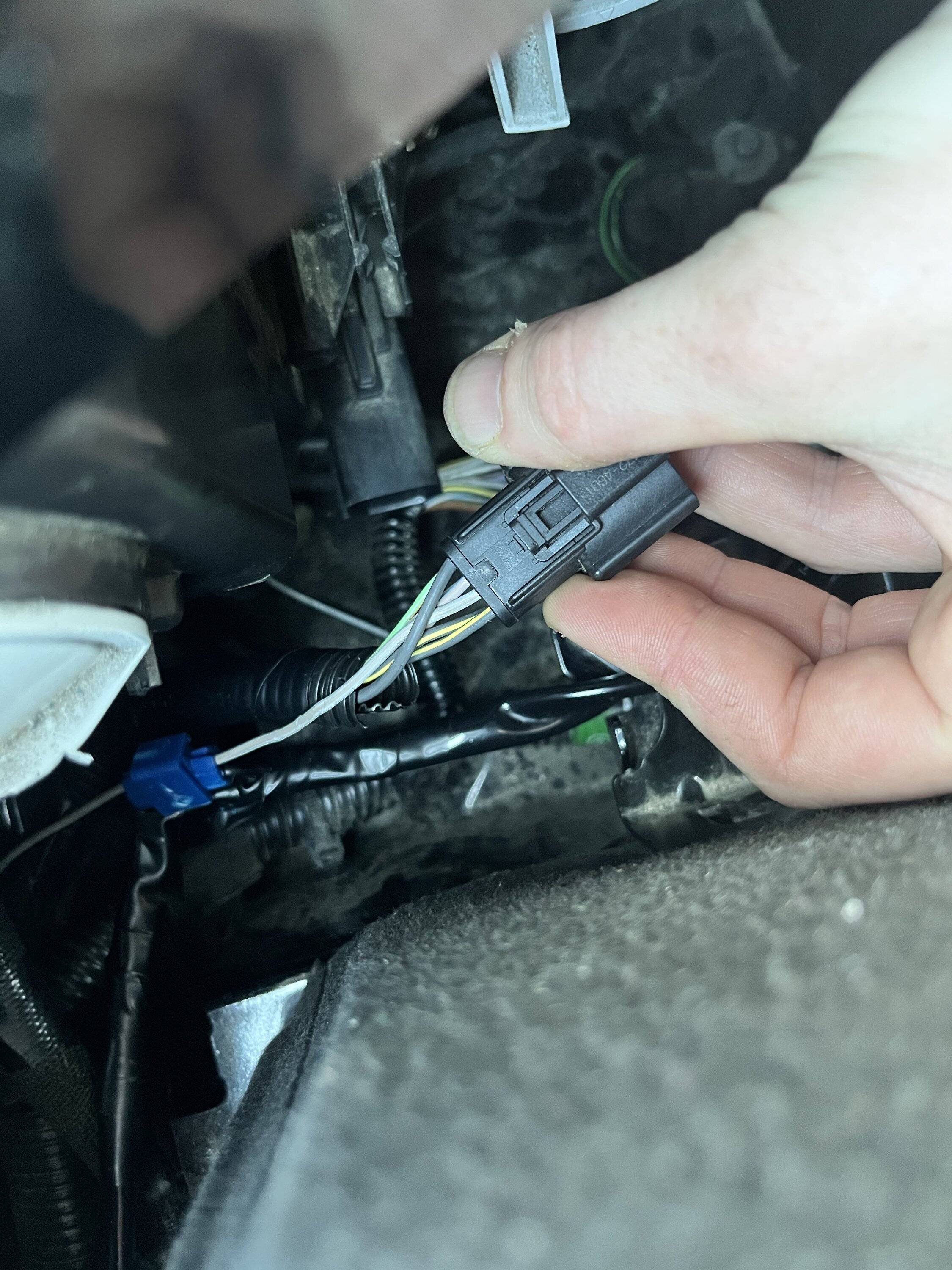

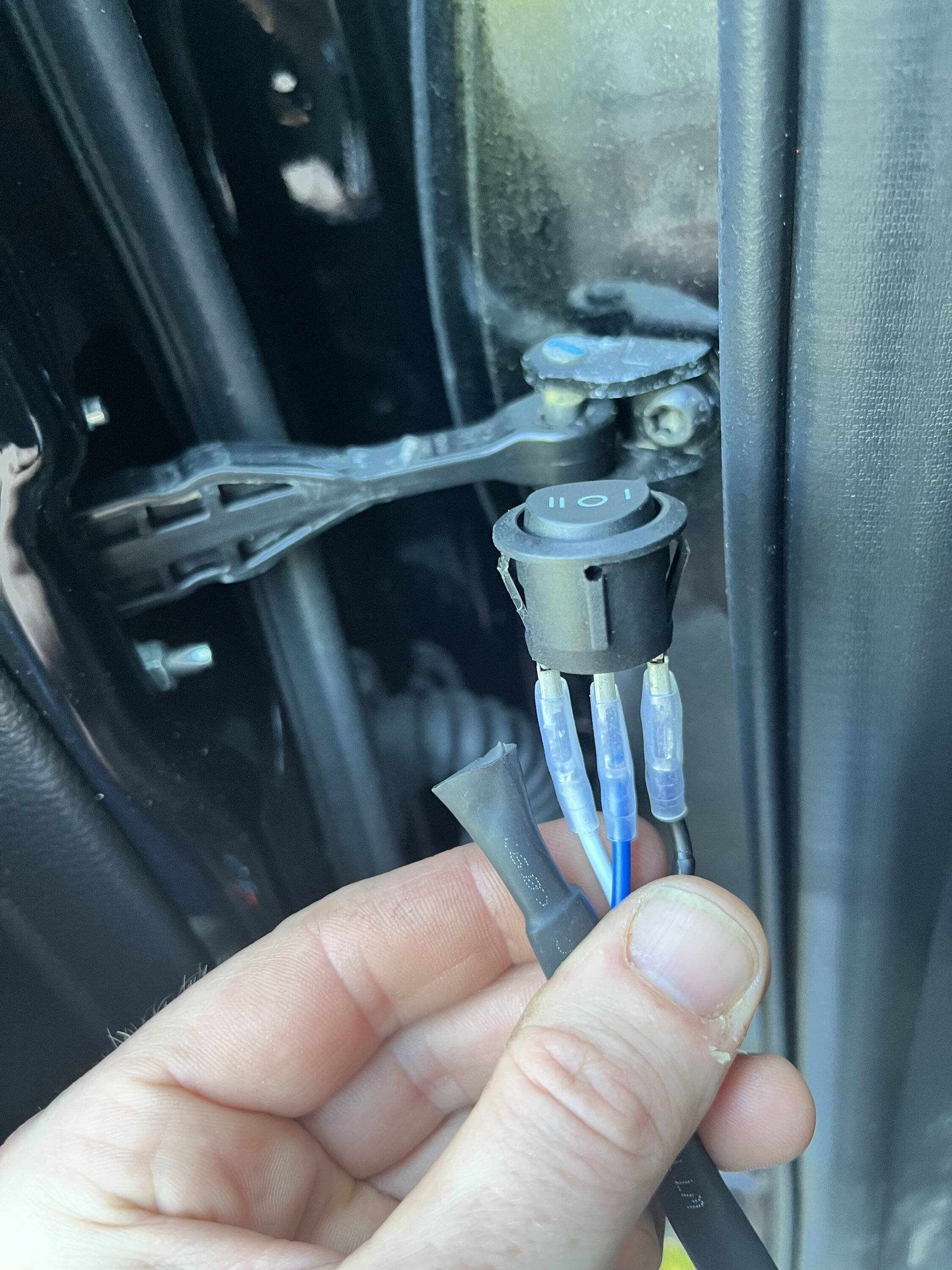

Hi and thanks- I do have a relay. I’m running the 12v, the switch, and what I thought was the high beam trigger into the relay via the switch. If that makes sense.
I tapped into the high beams here, the third pin.
Position I works fine(independent). Position II does not work. The black wire is tapped into the high beam.
Reverse the the sides see if same thing happens. Maybe a faulty switch where one position is not working correctly.
You can also test by removing the switch completely so the only way to turn them on is the high beams which would also indicate a switch problem.
Troubleshooting is all about isolating.

I was on my second switch already so I assumed a wiring issue. I am a noob when it comes to wiring but I think I originally tapped the ground into the high beam? I spliced the blue wire into the brights and now we are all good. Thank you for the suggestions!
