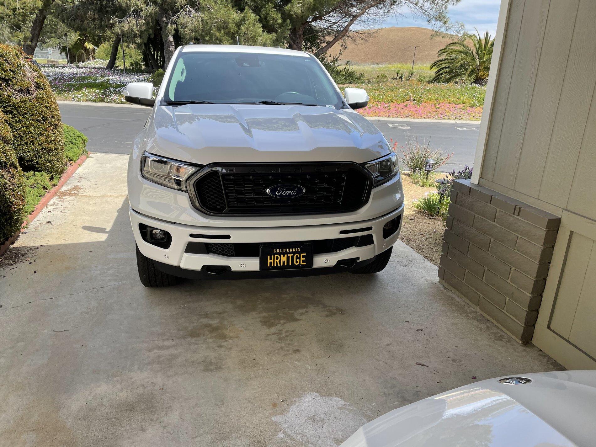

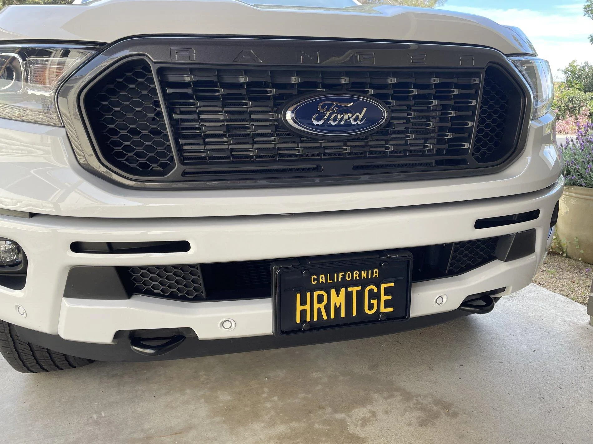

Relocated the front license plate bracket where the big gaping hole is above lower valance. Now I don’t need to add Putco valence insert and front end looks a lot cleaner. I don’t have adapted cruise control so it works for me. All you have to do is flip the bracket and screw it in the same holes. I got off what was the lower tabs to put license plate frame on
Feel nice and secure

I like the look. Especially for a light colored truck.
Only down side is it's blocking air flow to the intercooler. I'm guessing that's why Ford mounted it higher.

That's what I was thinking. It does look a ton better Eric. Have you had any overheating issues?

Just did it but I think it will get plenty of air. I think the reason they did it was because that’s where the adaptive cruise control sensor goes if you have that. Probably half the size of a license plate so not expecting any issues

I soils also mention I redrilled the holes on bracket so it sits properly
