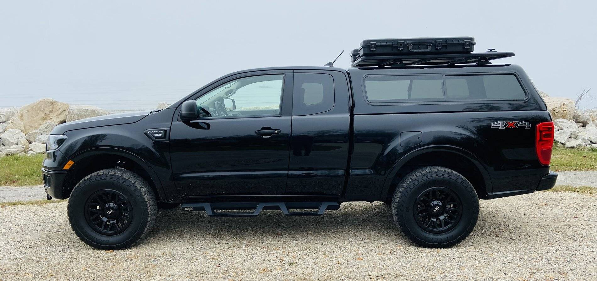

I haven't got my 2022 Ranger SuperCrew 4x4 yet, it has been scheduled for April. I just dont like the front end rake so I've been looking at the BDS leveling kit. I will keep the stock size tires on it and only plan to do light offroad with it. I have looked at the Fox 2.0 adjustable front strut and rear shock kit. I just need some of your opinions of what would be the correct way to fix this?

The Fox adjustable coil overs are set at 2” out of the box. Install them as is and you’ll be close to level. The rear shocks will not affect the rear height. No need for the BDS level kit. If you think you need to go a bit higher, the Fox fronts can be adjusted before installing. I am set at 2” in this pic - canopy settles the back end a tiny bit - most on here report that 2-1/2” level kits do the trick - with mine set at 2”, I am level with the canopy and a few tools in the back, so most of the time, it’s level - in this pick, it’s empty.
I hope this gives you an idea of what to expect and you won’t regret the suspension upgrade.
