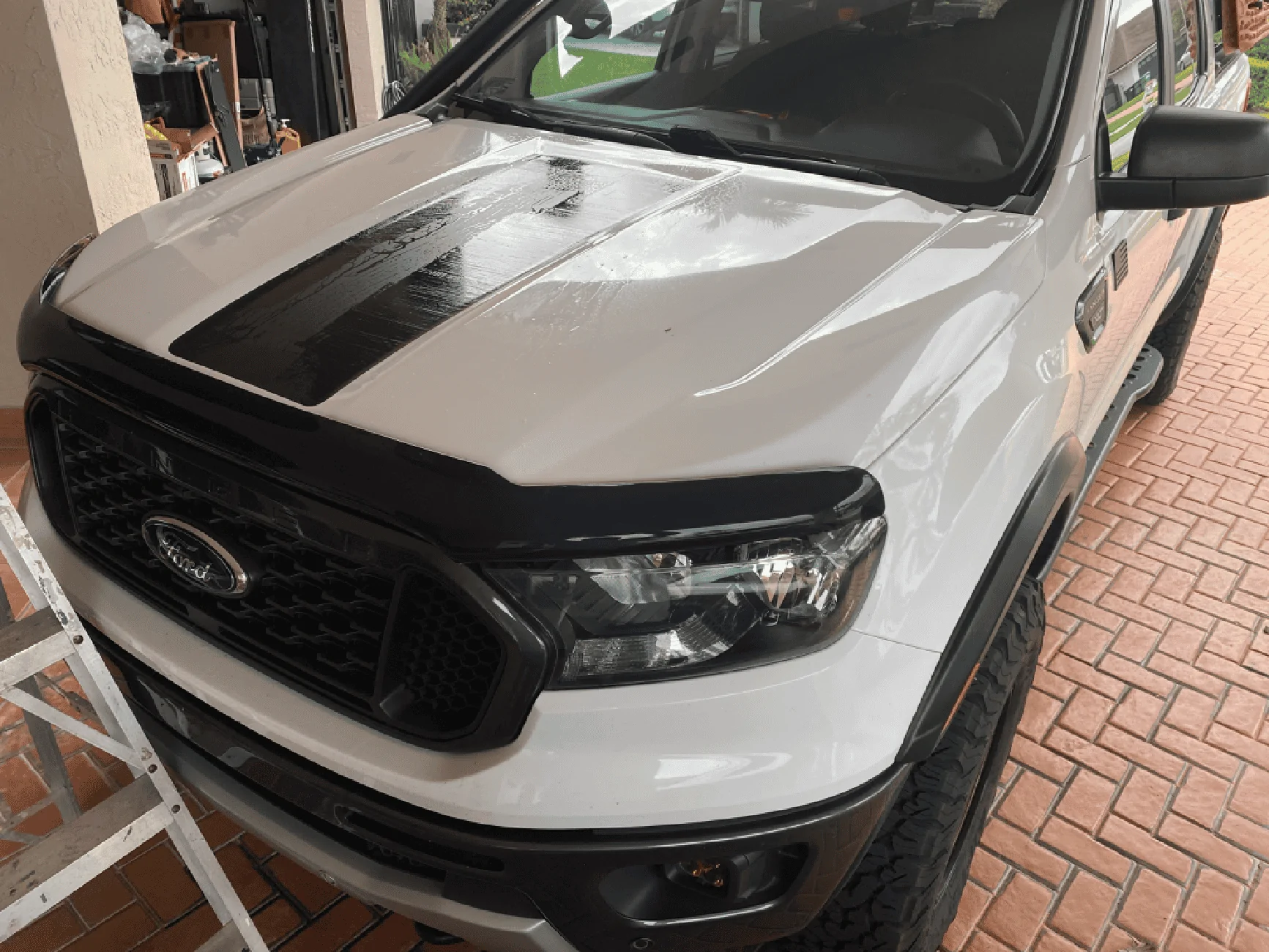

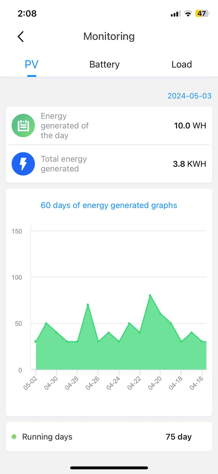

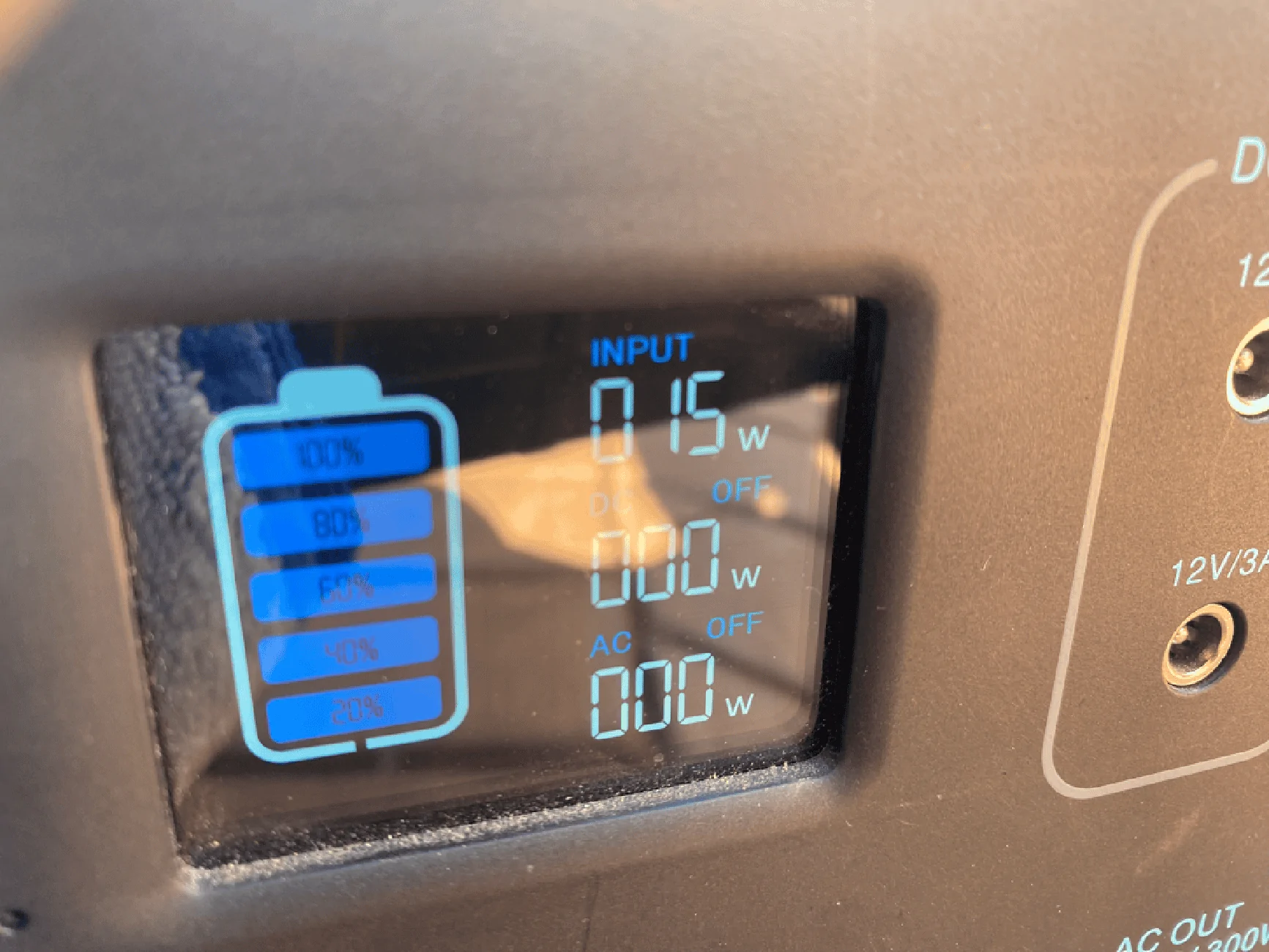

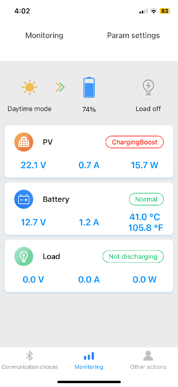

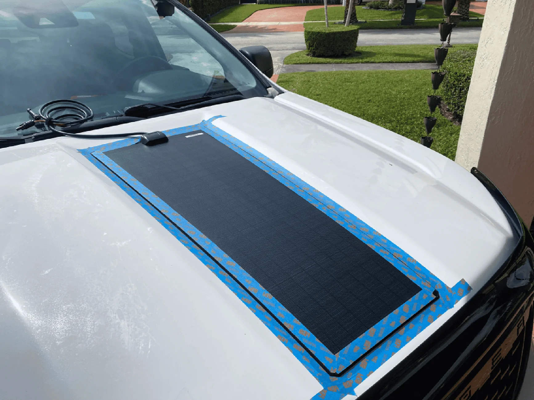

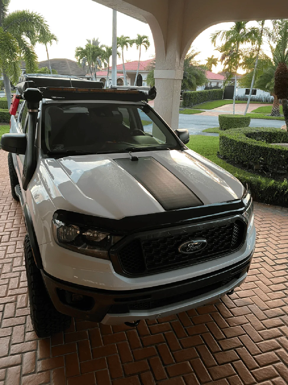

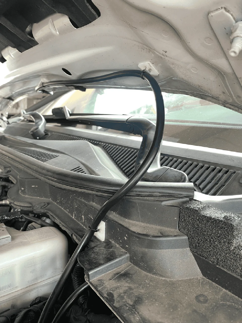

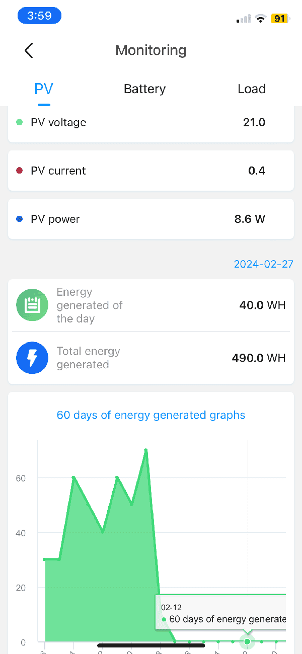

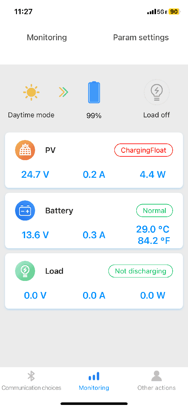

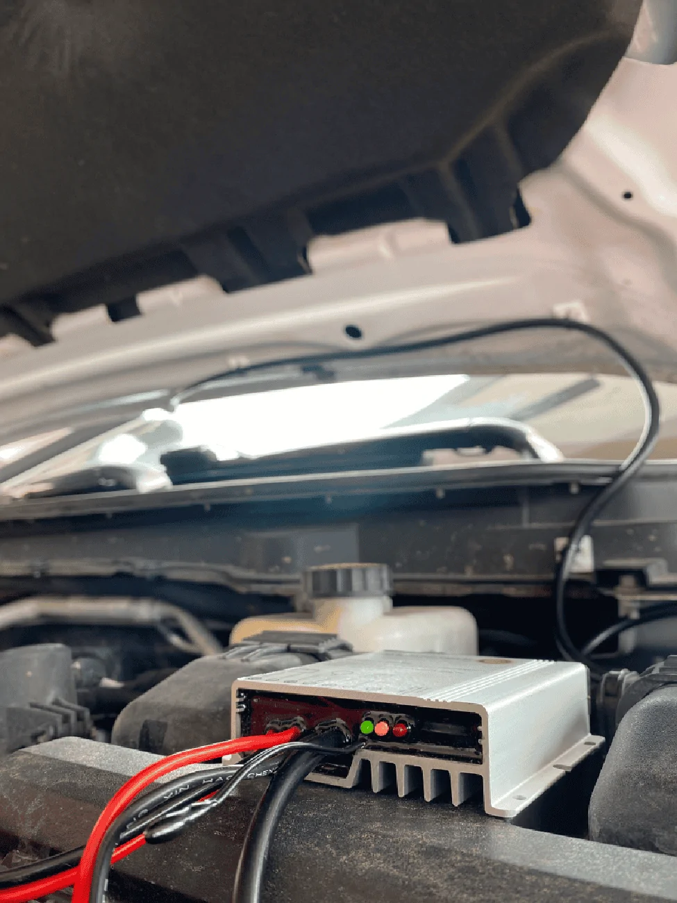

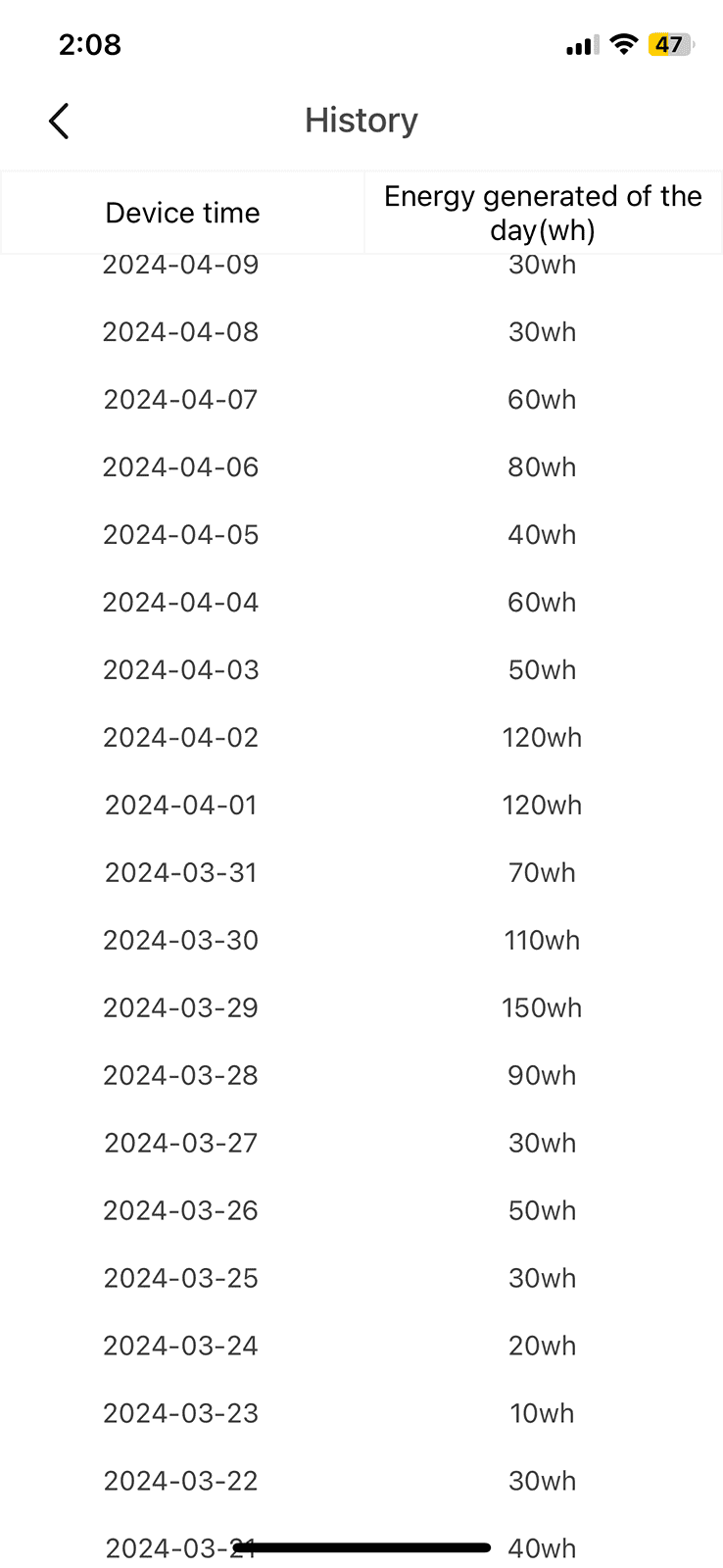

Update on the solar panel, it’s still mounted, and did not become a kite.
In the last 70+ days it has generated 3.8KWH per the app for the charge controller. In one of the photos you can even see where I was even in the triple digits in the end of March/beginning of April.
So far I am pleased with the kit overall. I would do it again as it fits the reason I wanted it in the first place. As I do not run a load on the system, I am fine with the single panel unit. If I were running a load(12v Iceco) then I probably would’ve looked into the three panel kit.
