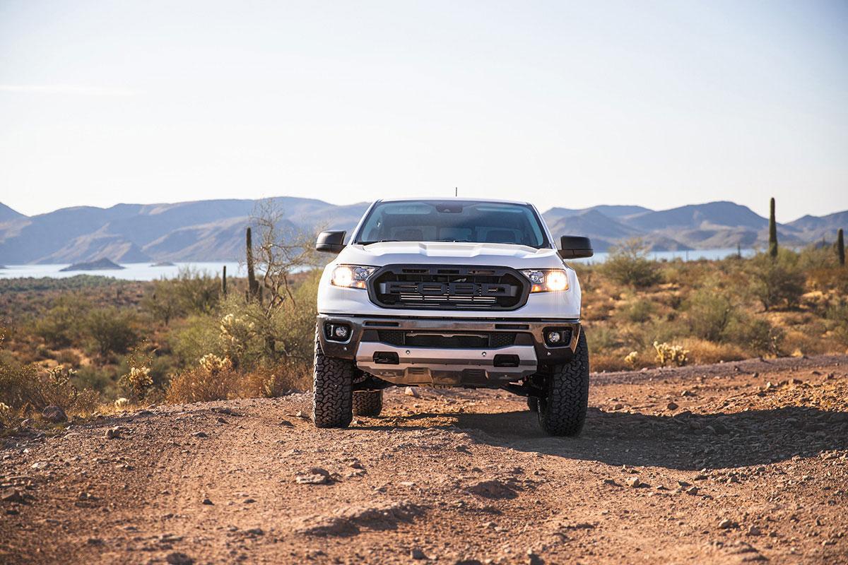

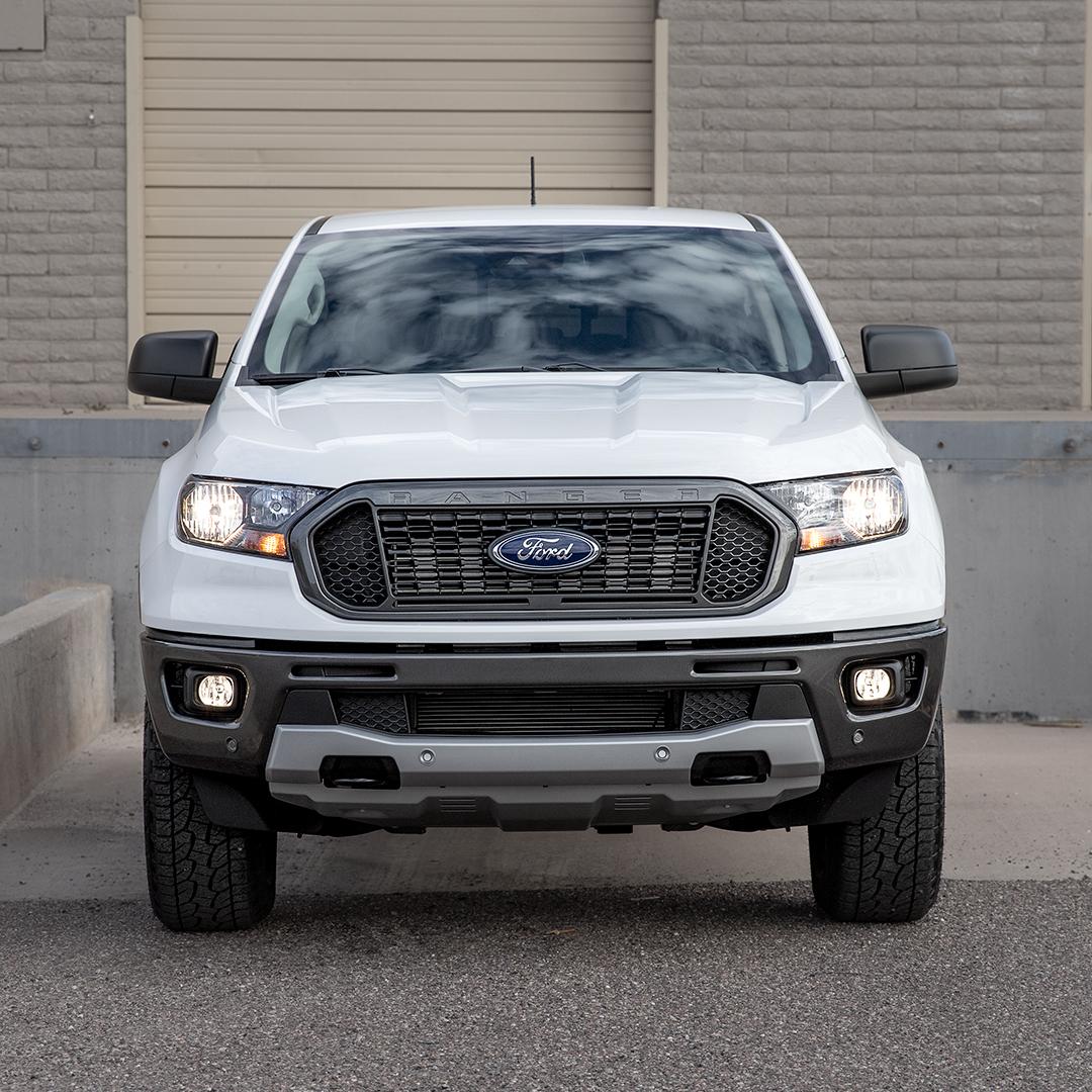

We don't have any of photos of the 1.00" spacers installed as of yet, but we do have head-on shots of no spacers on stock wheels and the 1.50" spacers with the 285 wide wheels.

On our truck, we used the stock wheels, 1.50" spacers, and 285/70R17 BFG KO2s at 2" of leveling and we had to remove the front crash bar and heavily the trim the rear. If you go with a smaller tire (like a 275/70R17), you may be fine at 3" of leveling.
