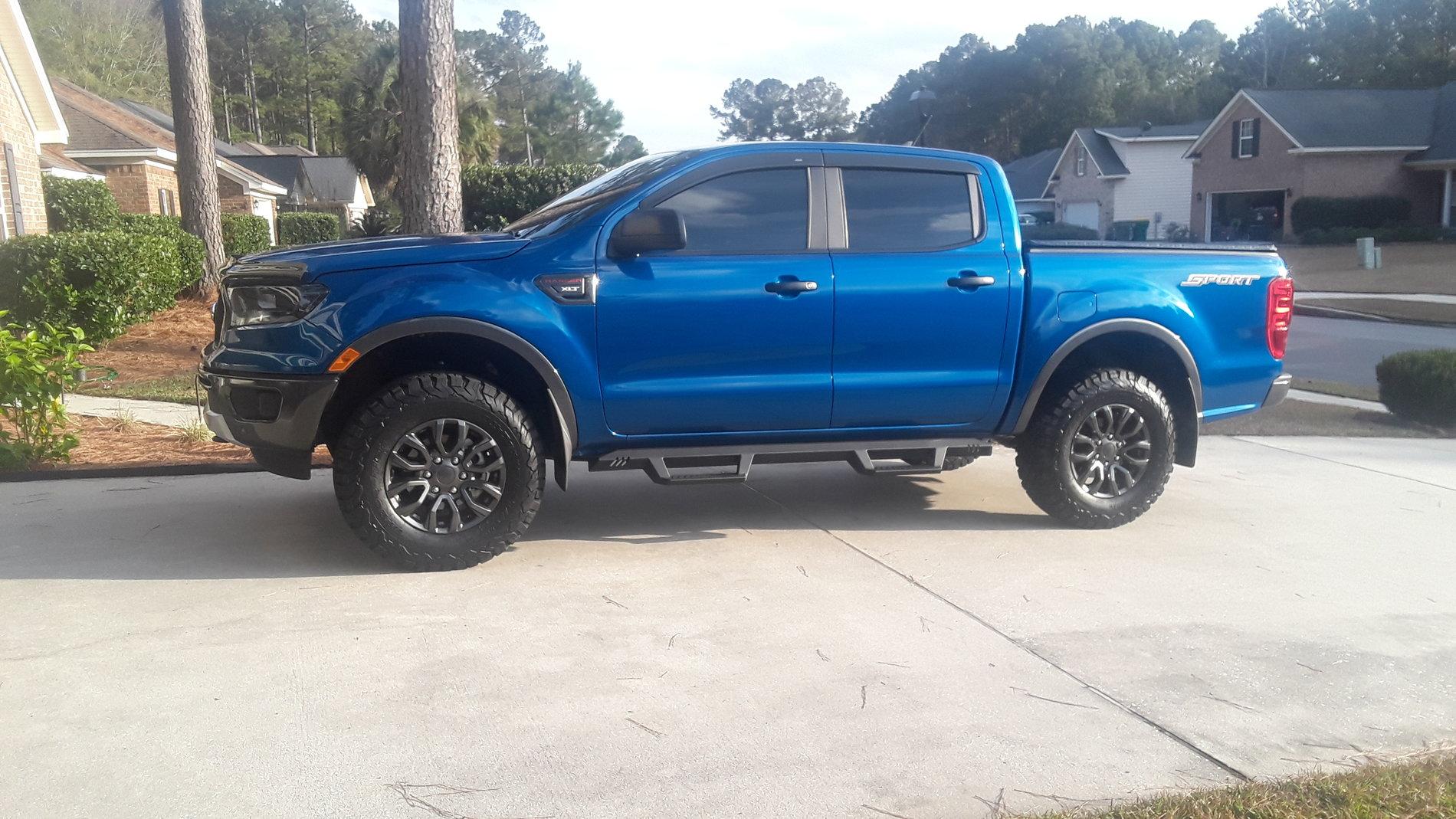

2wd, 275/70/17 - 3" level, no rubbing or cutting.

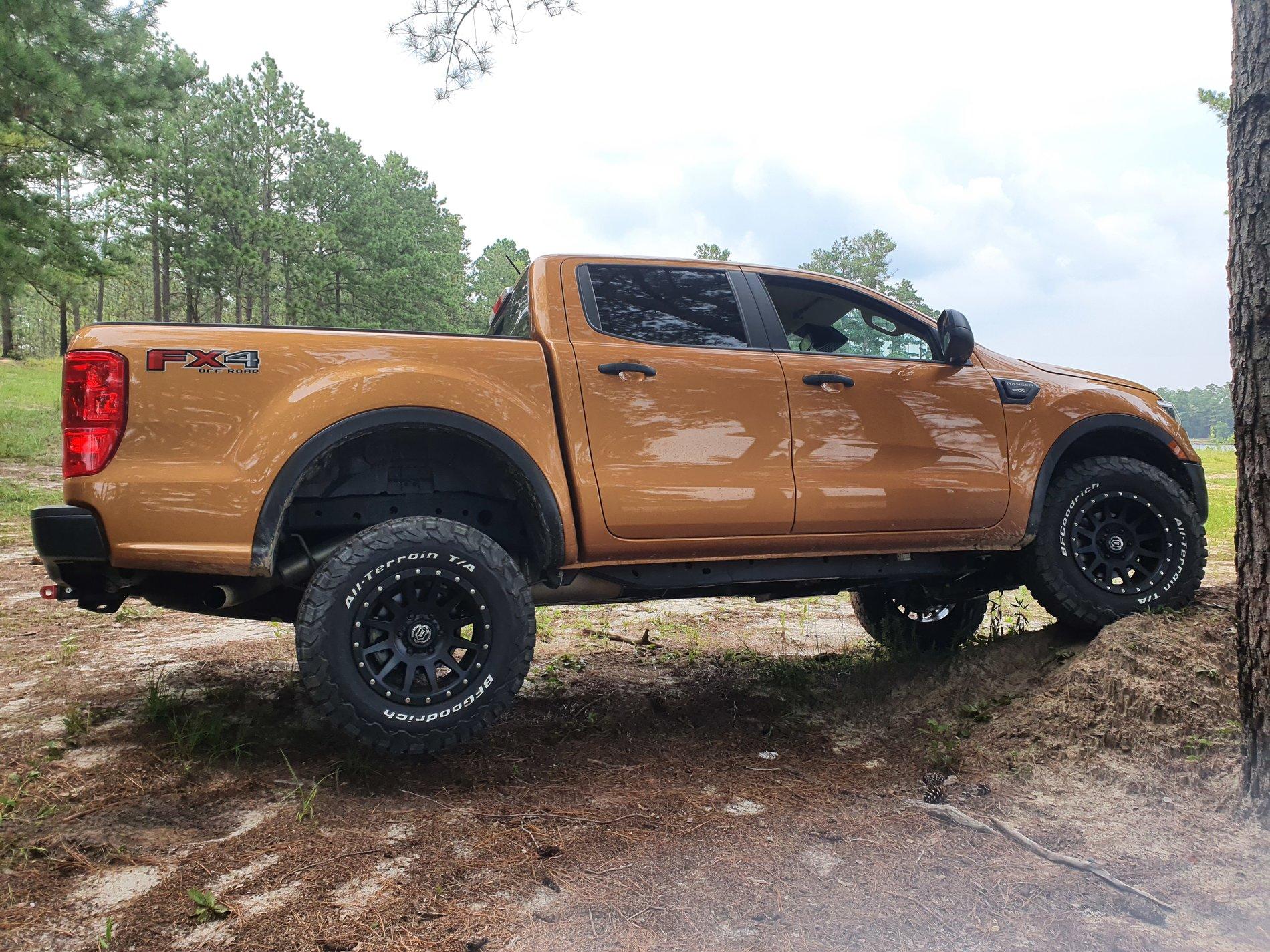

Everything depends on your personal preference but IF you wanna go bigger tires, I strongly recommend that you either upgrade your wheels or use adapters. IMO you will want to reduce by at least 1.25" (~30mm) from the factory offset. The OEM Ranger wheels have a factory offset of +55. So I'm recommending you get to a +25 offset wheel or a 1.25" adapter/spacer. That will offer 5.75" of back spacing... plenty of room for 275/70r17. With factory wheels and tires you can't even fit a finger tip between the tire and knuckle... it will be extremely tight with 275/70r17.
I went with BFG TA KO2s and Icon Compression 25mm offset 17 x 8.5 wheels... Take a look and decide for yourself.
NOTE: I did have to do some minimal trimming on the driverside crash bar... other than that no issues.
I've been thinking about getting those wheels. I have same tires. When you said drivers side crash bar, was that front or rear, just curious because of mud flaps? Would after market crash bars take care of the problem as well? The wheels look great by the way.
Your truck looks perfect! Nice work man!
Did you have to use spacers to keep the tires from hitting the knuckle? I’m thinking of going the same route. with the stock 255 Hankooks there’s only a pinky fingers width space. I’m wanting to go with the 265/70/17 same BFG tire as you went with.
