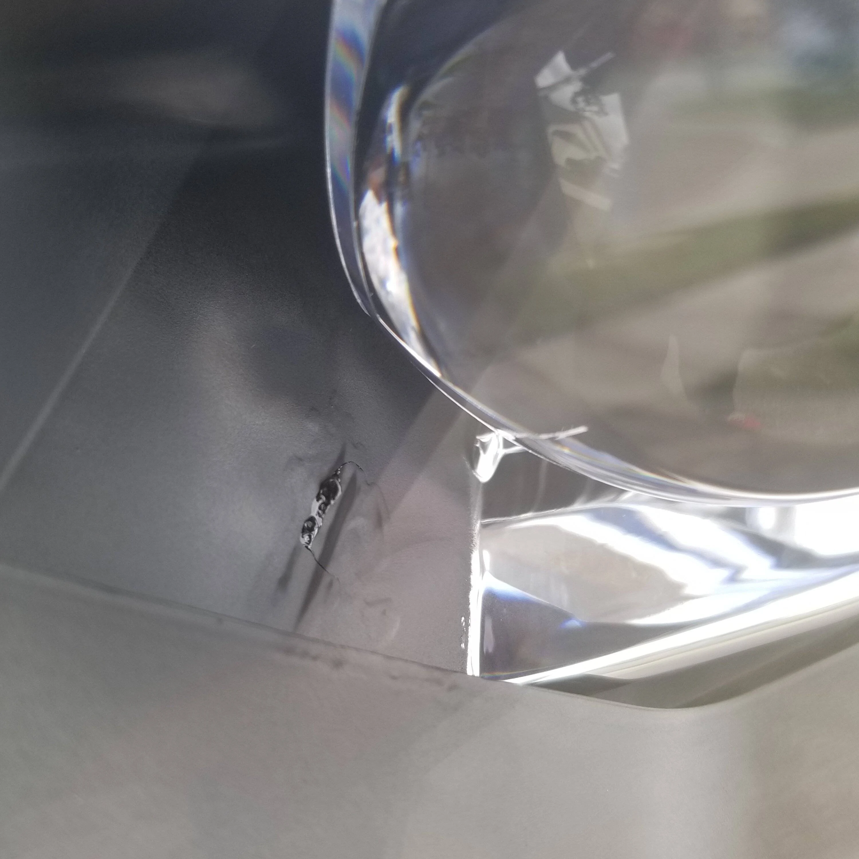

2022 they changed the fuse box this is my second pair getting blisters in headlight next 2 each bulb and do you have 2 lights low beam or all three
