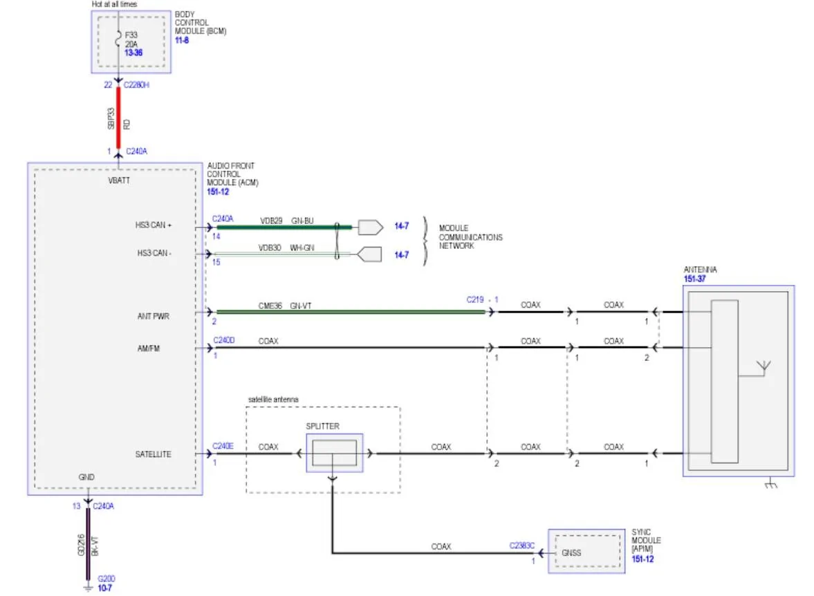

Here is the wiring diagram that contains the antenna system. You should probably check the cable connections for the antenna, power to the antenna, splitter connections. The satellite part of the antenna and splitter would be used for the GPS receiver.
Now that is very helpful!!! A rock-solid satellite signal eliminates the main coax that runs straight through the splitter. I don't know the antenna details, but GPS is around 1.5 GHz and Sirius XM is around 2.3 GHz. The antenna MIGHT share the same antenna connections for both bands and be a dual band design or it might spit internally to two different antennas.
This is great seeing that diagram!
It looks like the problem is either the antenna itself, the splitter, the coax from the splitter to the GPS receiver, or the GPS receiver itself. It can't possibly be a "ground" like they thought. Antennas in the GHz range don't depend on the vehicle chassis ground since the wavelength is in centimeters.
I have test equipment that would isolate the issue but I can't personally meddle in a warranty issue. A cheap $100 Chinese NanoVNA could likely determine the real issue.

I could sweep the antenna system, cables, and splitter with a $100 nano-VNA but that isn't my job and I don't know where the cables run or what type of connectors they use. Some simple test gear would verify whether the antenna system up to the GPS antenna port is working. At least this would eliminate everything up to that port.
