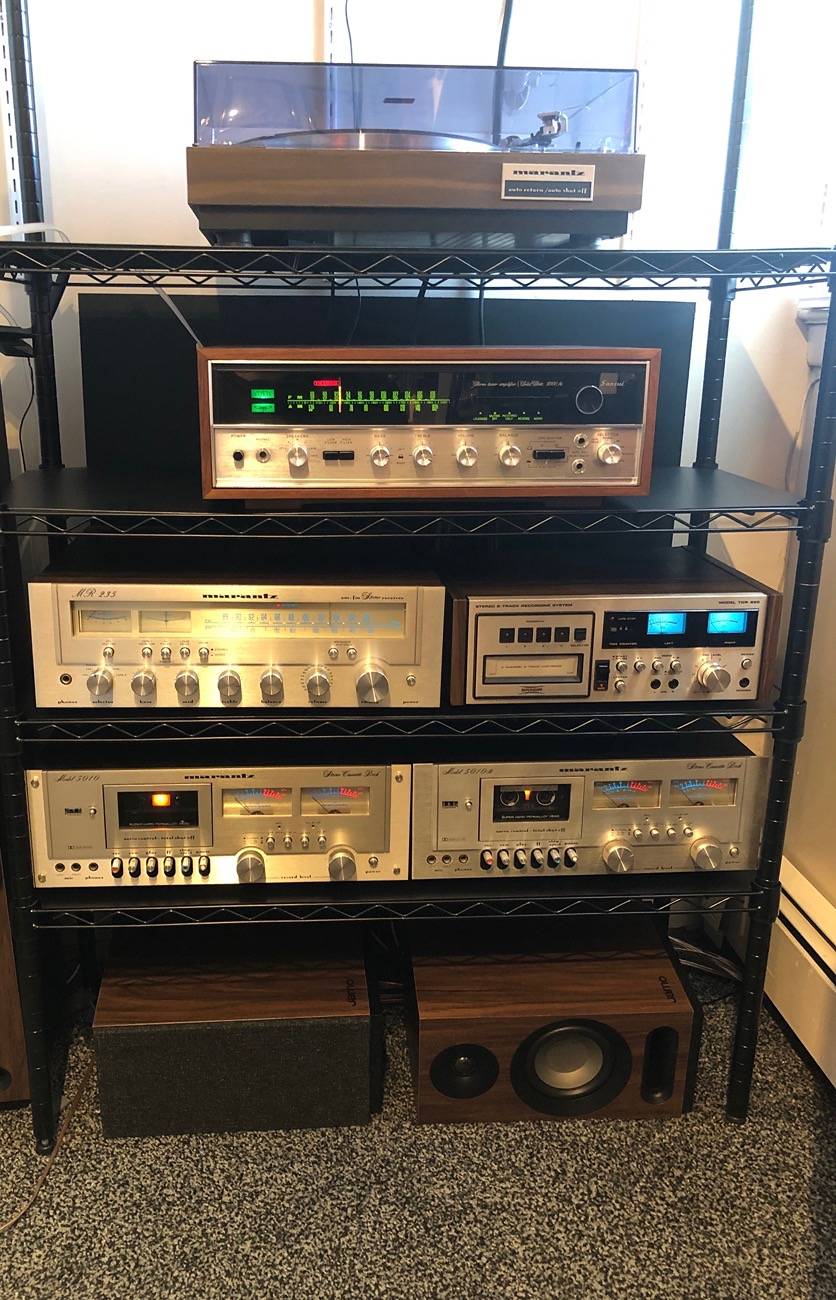

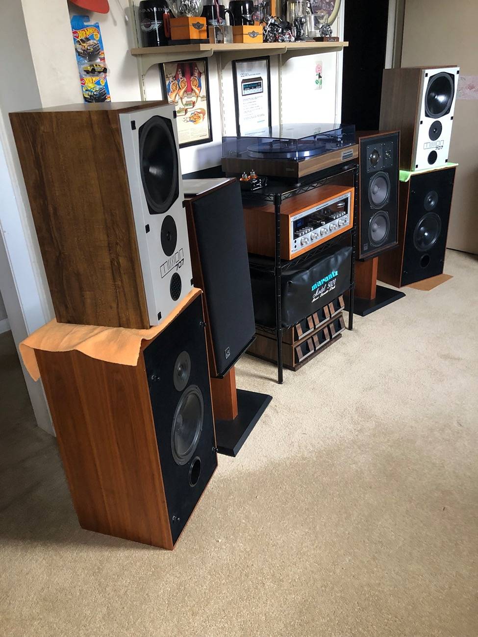

There’s nothing better than listening to vintage audio. Receivers, turntables, cassette decks etc. I’m 60 but very old school. I love vintage. I still have my Marantz MR235 that I purchased in Macy’s 1978. I‘ve been collecting vintage audio for most my life.. Big Marantz and Sansui guy. My best and most favorite receiver is Marantz 2270, 2240 in wood case, Marantz 5020 cassette deck in wood case, Mararantz 6300 turntable. Favorite speaker are my ADS L710’s, Dahlquist M905’s, Dynaco A25’s and Sansui SP 1500’s. also have several other receivers like Sansui 5000A, 551, 221 and Sansui 2050C Turntable. Few other Marantz cassette deck like 5010, 5010B, 6100 turntable, KLH model 24 audio system and so many different sets of vintage speakers. In fact today i’m waiting on a Sansui RA-500 Reverberation Amp to go with my 5000A. Cant get enough of vintage Audio, I have them everywhere in the house and garage. They all have their own distinctive warm sound. Here’s a pic of just some of my equipment.

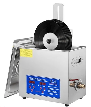

I purchased a Velvor ultrasonic cleaner with a record cleaning attachment. The motor that rotates the albums ran too fast for my liking so I swapped out the 24VDC 1 Amp wall wart down to a 6VDC 500 mAmp one that I had on hand. I would have gone to 3VDC if I had one close by (I keep old wall warts just for this occasion). The motor does not require a high amp wart. It runs on a 0.5 amp wall wart without the wart even warming up.
The unit takes a little over a gallon of distilled water, and I have found that I can clean about 30 albums before the water becomes contaminated enough to be replaced. But this really depends on just how dirty the albums are.
Keep water temp below 90F. Ambient temps are fine. There is no need to use the heater unless the water is very cold. LPs can warp if they get too hot. I fill the tank to within a 1/4" of the LP Label.
The package comes with a little drying stand that holds ~30 LPs ~1/3"-1/2" apart. It doesn't look like much but it works well.
You will be amazed at the amount of crud that comes off the albums.
One last thing, the machine is not loud, but the frequency is annoying. My cycles run from 5-10 minutes. 10 minutes if they LPs have never been cleaned, and 5 minutes when needed after that.
You can stack 8 LPs on the rail to be cleaned, but I only stack to 5 as I want at least 1/2" space between the LPs to allow the cleaner to do its thing. The dirt will coalesce over time at the bottom of the tank, turning into small muddy clumps. The funny thing is that you don't even see the dirt on the LP. I may drop to 3 just to determine the optimal cleaning number.

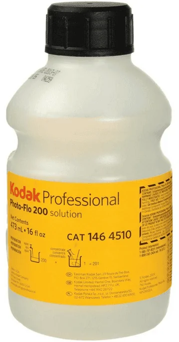

I use distilled water with 1/2 cap of Kodak Photo-Flo 200 Solution, 16oz. A little goes a long way! This bottle will last a very very long time. I do not use any soap. Soaps do the same thing but it may leave a film unless you rinse and you don't want mineral deposits from hard water settling into your LP groves as the water dries.
  • It decreases water surface tension minimizing water marks and drying streaks on film; speed dries
  • Reduces Streaking and Water Spots
  • Promotes Faster Drying
  • Wetting Agent for Film Processing

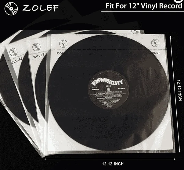

To protect and keep the LPs clean I use these antistatic slip covers. I tried several others and these are the best that I have found for a reasonable price. Once the LP is dry in the stand I simply place the slip cover over the LP, then pick it up by the slip cover, flip it and let the LP settle the reset of the way into place. I try no to touch th ealbum except on the edges and label. I place the open end up in the original album jacket.

WOW! Just WOW! :like:
Things of engineering beauty.

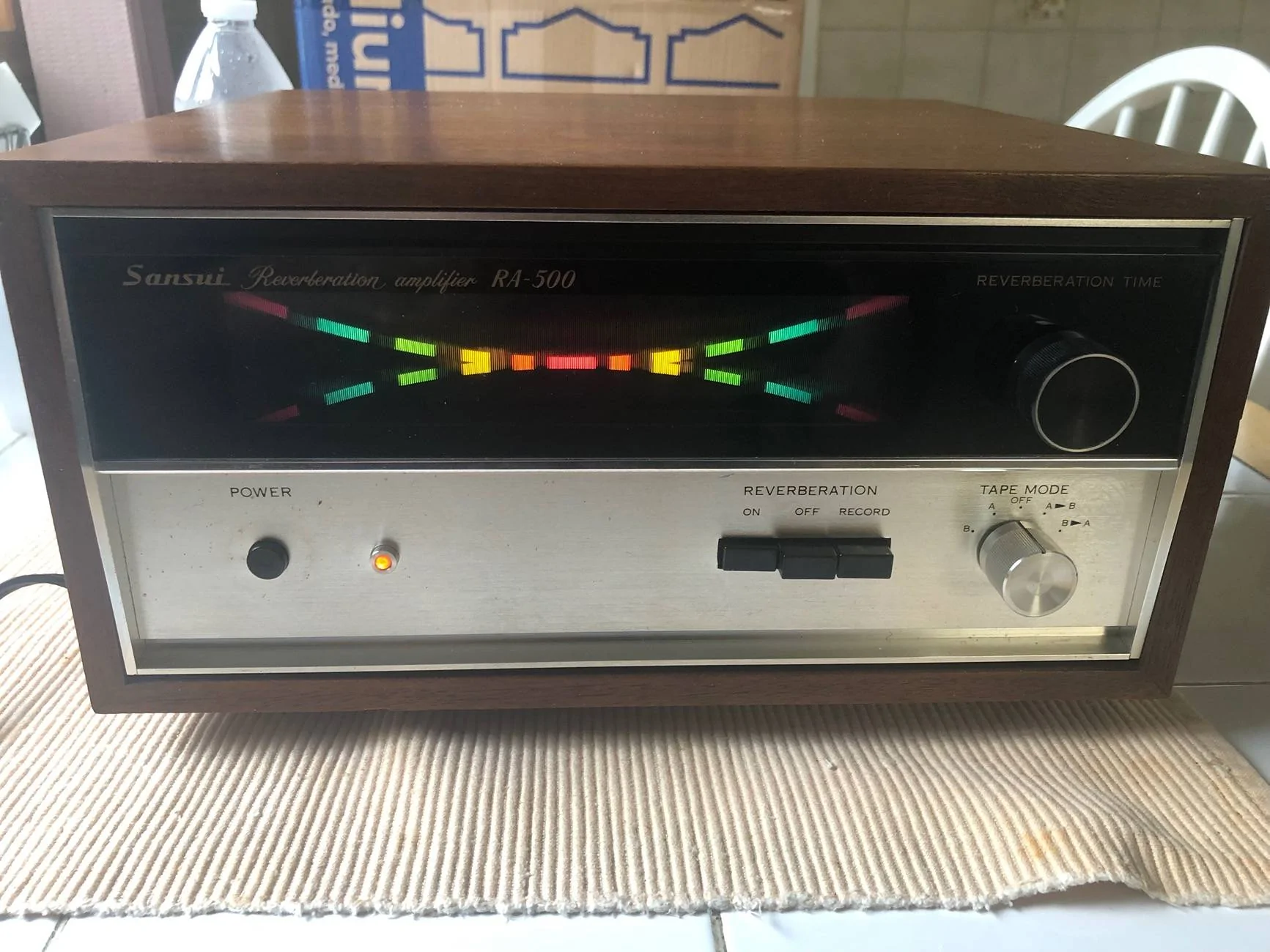

Just received my Reverberation amp! Cant wait to go through it and hook it up. Ty FedEx for not smashing it!

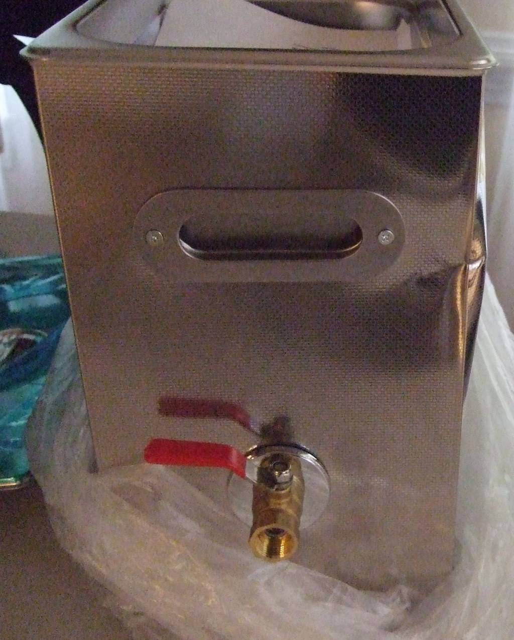

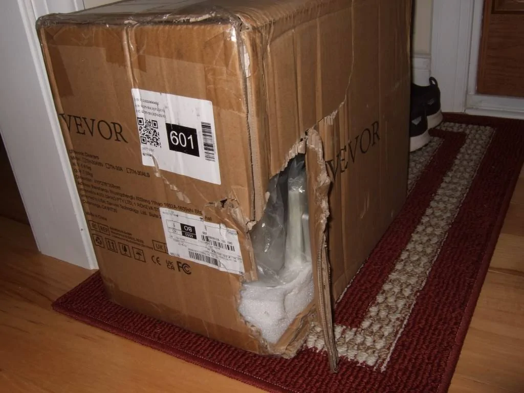

My first Ultra Sonic cleaner came damaged

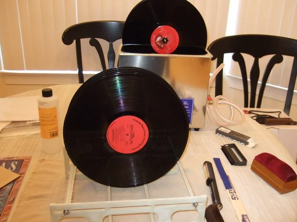

Here's the LP cleaner at work

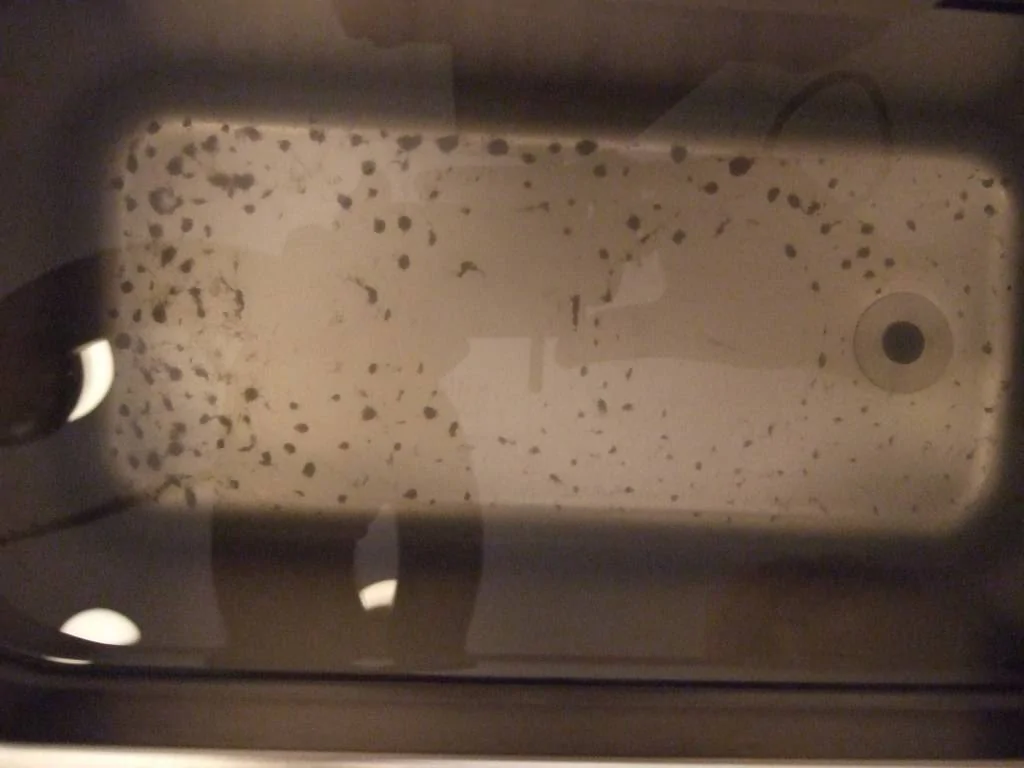

And here is the result after ~60 LPs. I won't go this long as the more dirt suspended in the water the less effective the unit becomes. Mind you, the LPs didn't look all that dirty, but you could hear it when playing them. I limited the second bath to 30 LPs this last time around and the tank was just beginning to show debris in the bottom. Distilled water is cheap, old LPs not so much.

There’s nothing worse than receiving damaged goods especially irreplaceable vintage equipment. Ups is the worst! Once I received a KLH System, after opening it I noticed a crack in the dust cover. Then I checked my by Blink camera and watched the FedEx guy slam the box on the ground. I contacted the seller with pictures of the damage and the video. He filed a claim with FedEx and I won the case. 2 weeks later I got a PayPal refund from the seller for the full purchased price. So I ended up getting the entire system for free. But it took me months to locate a replacement cover.
