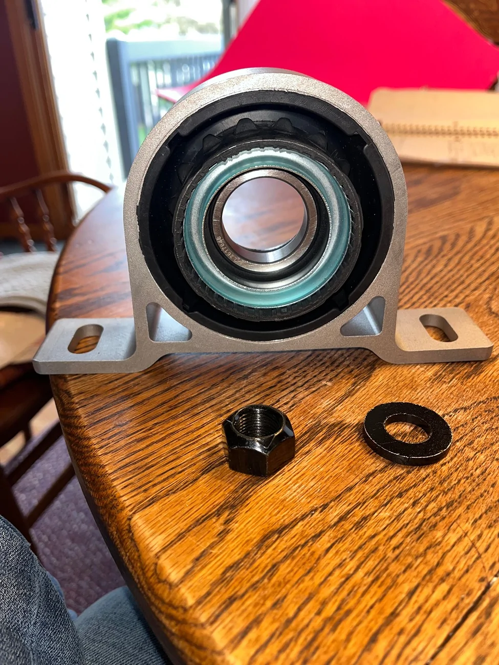

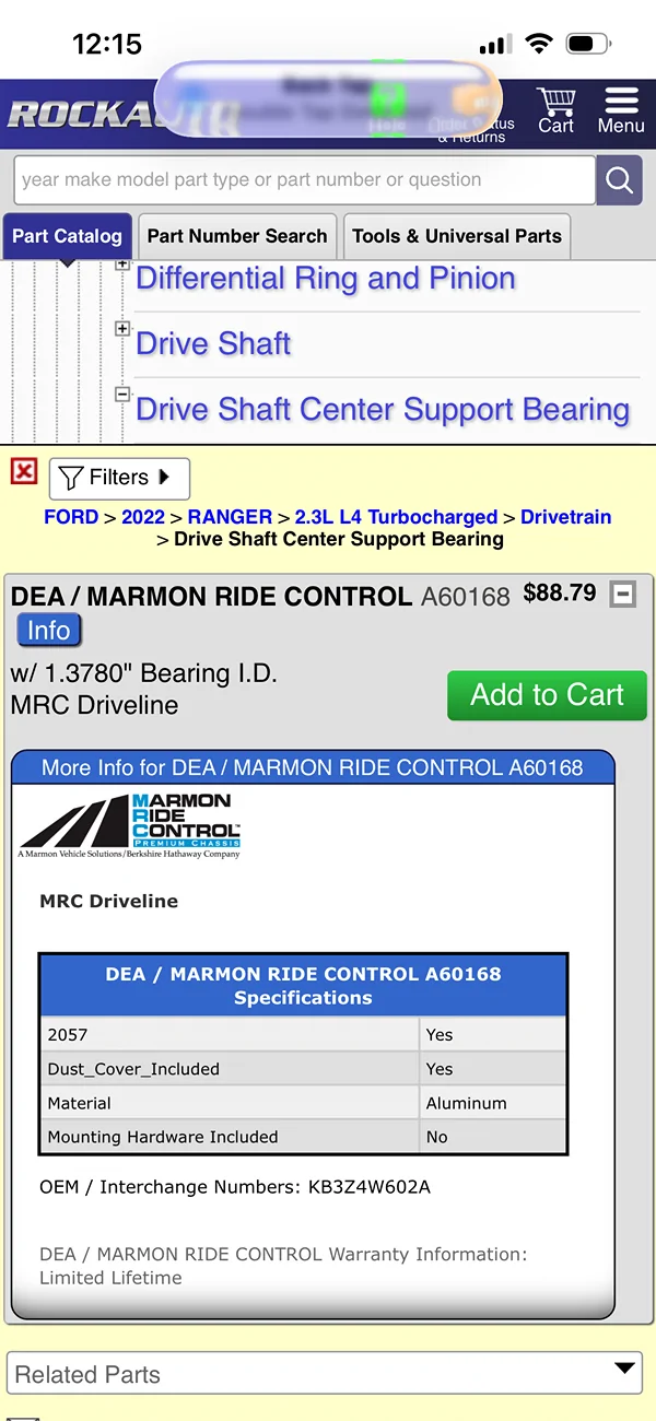

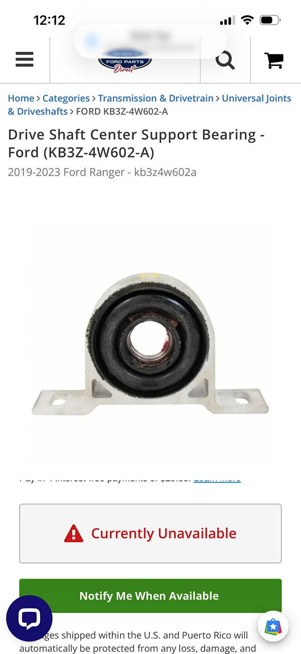

FYI - Just got this today from Rock auto. Looks to be a direct replacement to the Spicer/Ford one. I ordered it to have on hand because I destroyed mine to replace it with the JXB performance one. Didn’t want to be without if that didn’t work out.
Much cheaper than the Ford and made by Marmon Ride Control and comes with the nut and washer.
Good alternative if you can’t get or don’t want the OEM one.
