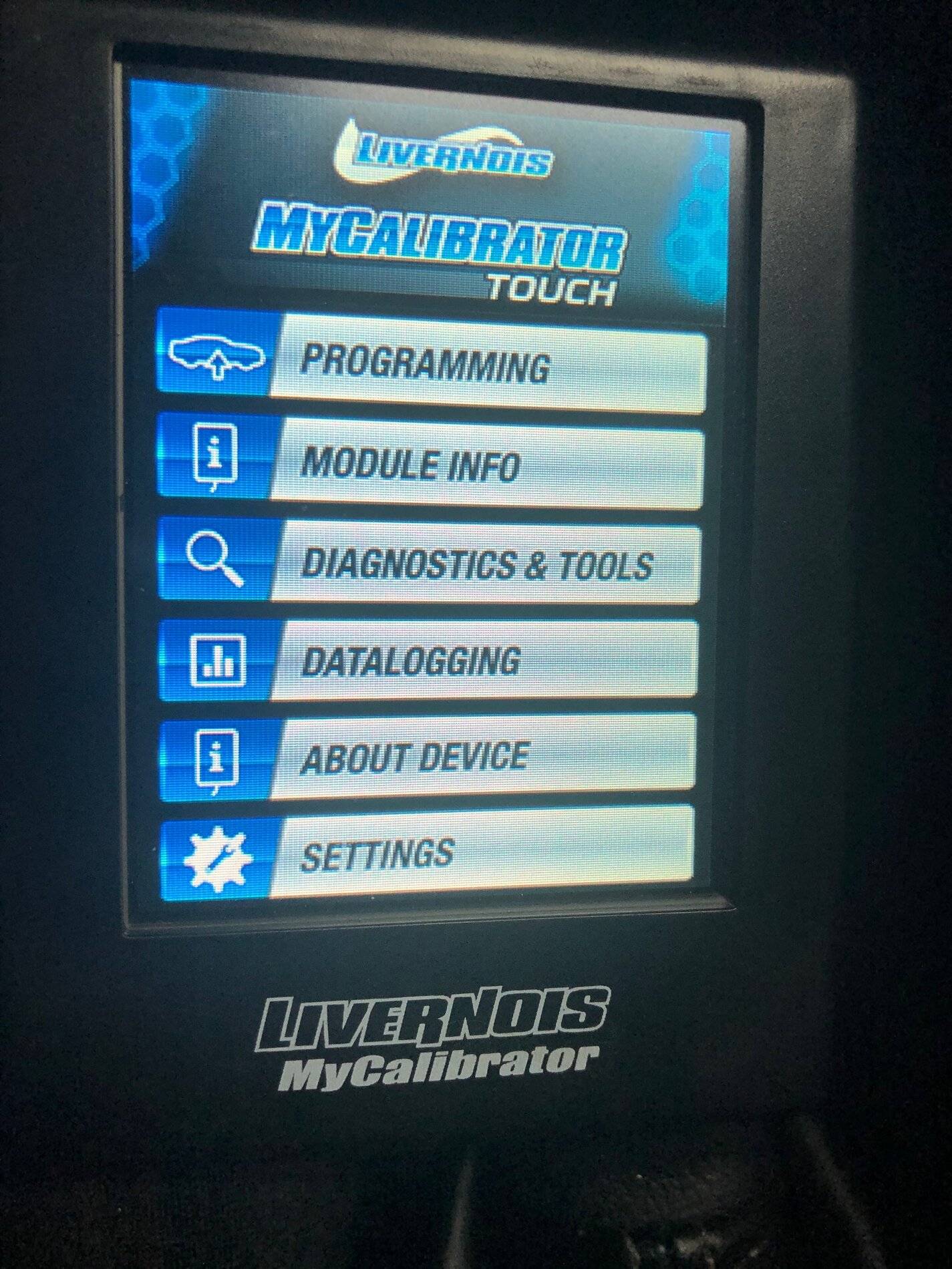

Just curious what the procedure is for returning back to stock tune via procal4. Don't have access to my manual to refer to on this. I assume all stock files have already been saved on unit. Do I just press "return to stock" on the procal and wait to upload? No laptop, no wifi. Thanks in advance

Pick program from the main menu. You then have the choice of returning to stock or flashing the performance tune again.

The Procal is the same tuner as Livernois Mycal. If you don't have the instructions for yours you can just follow theirs here. It's easy to do just make sure everything including the radio is turned off and no one opens any doors. It only takes a couple minutes to flash between tunes. Just hit programing and your tunes will come up next.

Duplicate above. Good to have option to alternate the 2 tunes relatively hassle free. Haven't tried to revert back since running on the tune installed 4 months ago. Maybe run 87 grade for a few weeks
