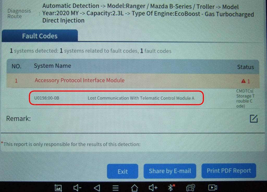

As noted earlier, MountainGoat inspired me to refocus on eliminating the Telematic's embedded in my Ranger. Based upon his and others previous efforts, I pulled the Telematics fuse 9, added a single 10A fuse in fuse slot 8 for the security horn. I then unplugged the cellular modem in the passenger foot well. I didn't even drop the glove box, simply looked up from the foot well and removed the big plug in the white socket. I left the 2 antenna cables plugged in.
I then hooked up my xTools D8 and scanned for any DTCs. I had one in the APIM area. It reported that there was no communication with the Telematic Control Module A. Just what I was hoping for. No other systems were affected.
So Telematics have been successfully disabled - no calling home to Momma!
It may (maybe not with the Telematics fuse pulled) still collect data, but it is definitely not going to be able to send that data anywhere. The picture below shows the error code with explanation.
