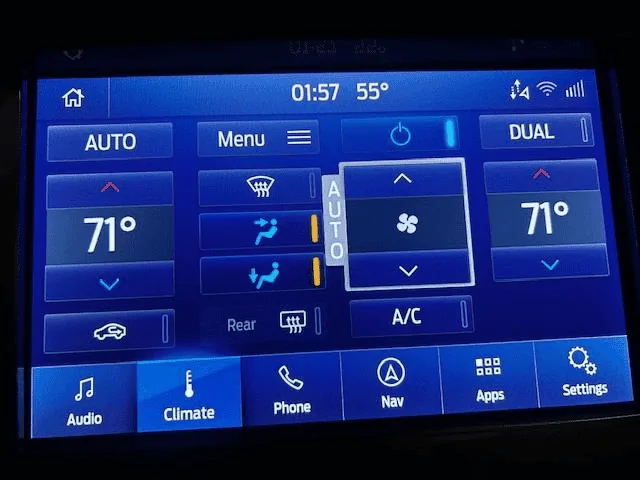

Floor vents shut down when panel vents are turned on.
