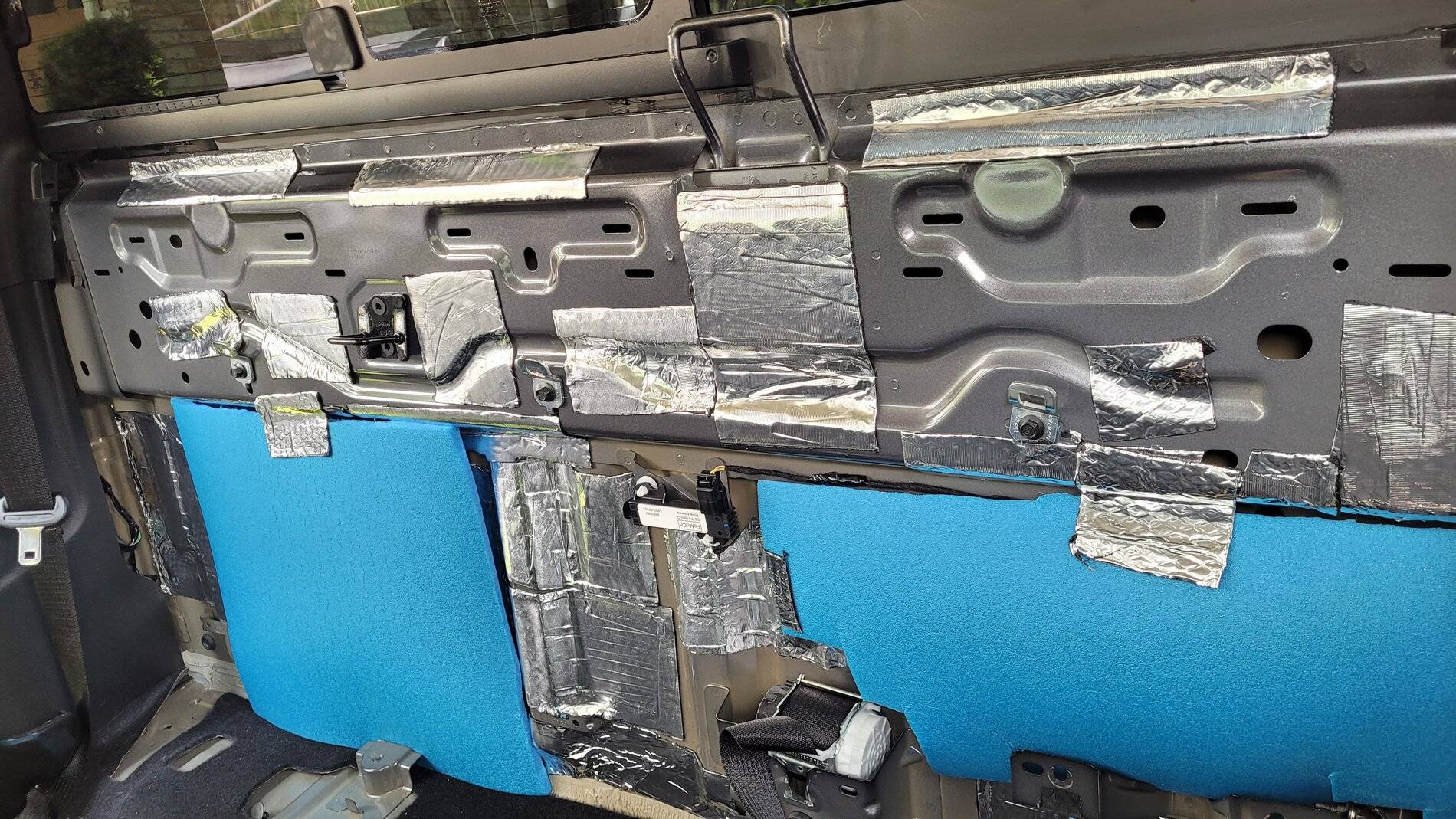

I noticed that mine only does this when I have it on fresh air. If I crack open a window just a tiny bit it stops doing it. That tells me that the truck is sealed up rather too well and building up pressure against the blower fan. I suspect it's probably the result of the foam mats I put in on the back wall to reduce wind noise after removing the jute material from between the cab/bed. Guess I need to open it up a little more to reduce air pressure from building up too much.
Use felt sheet instead of foam. Foam does not breathe and the felt will. Both dampen sound about the same
That's a really good suggestion. Thanks! Definitely have to go to the fabric store and pick some up. I thought I had the foam positioned in such a way that it would not block the pressure vents too much. Guess I was wrong on that.
