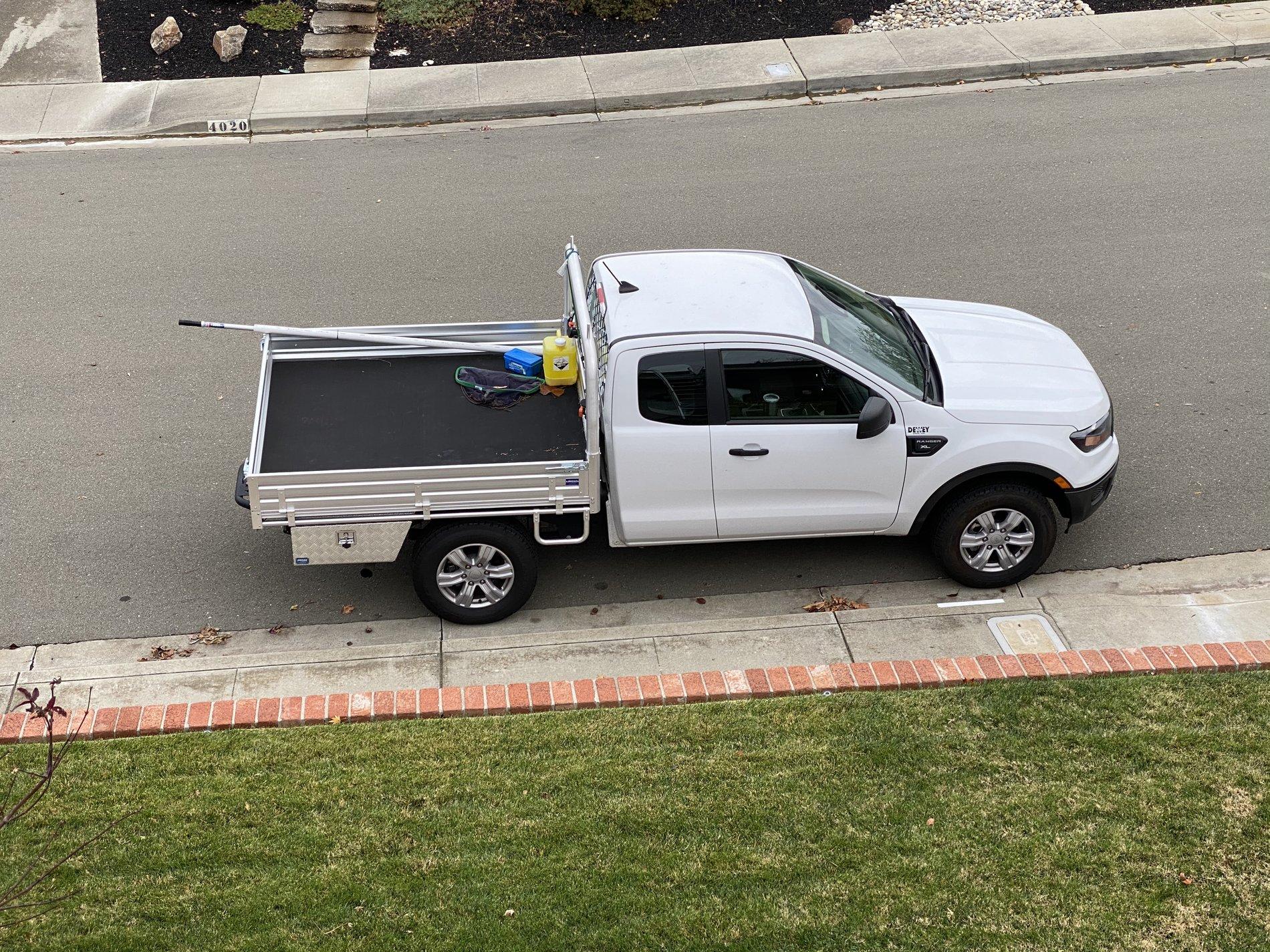

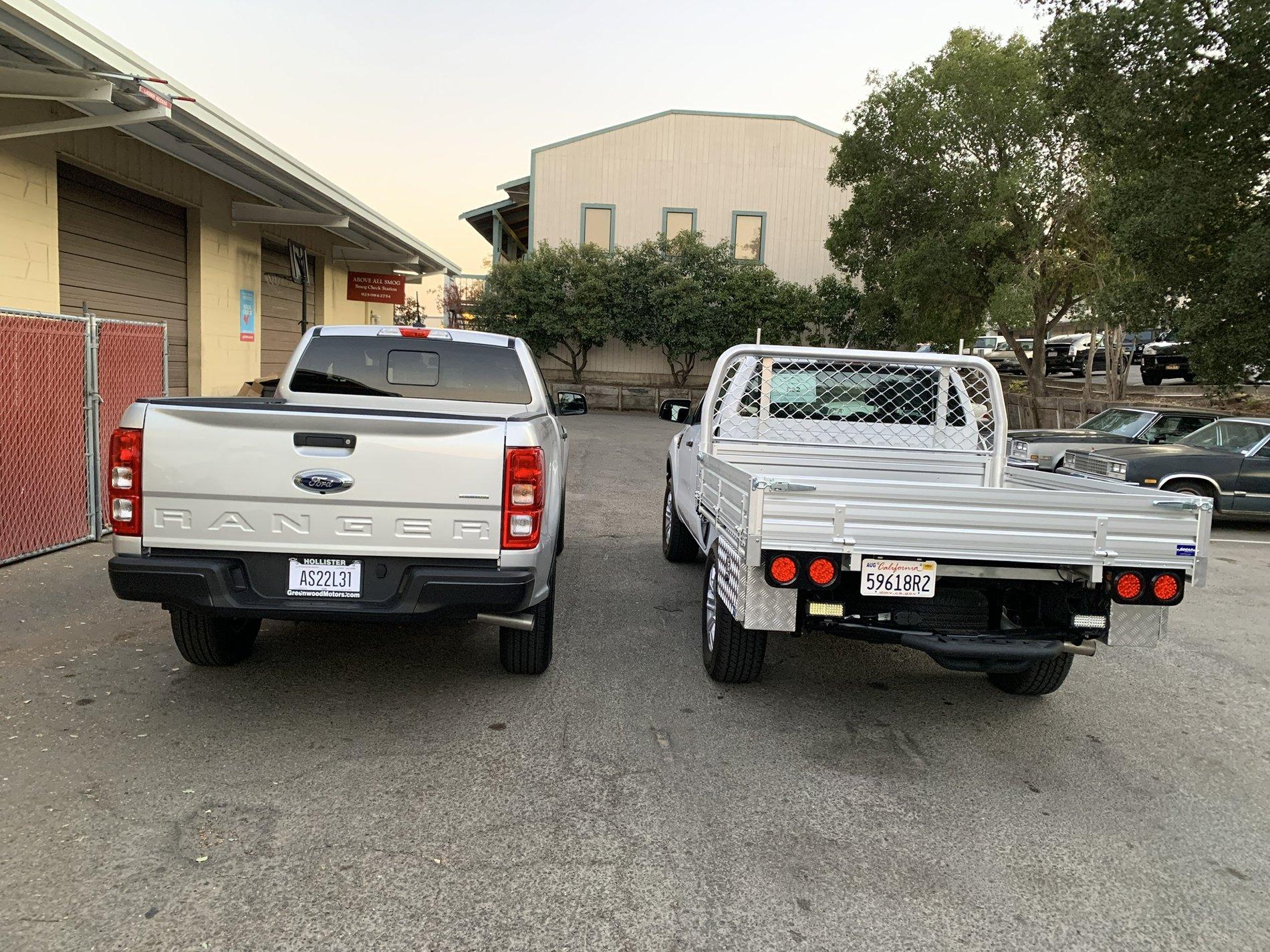

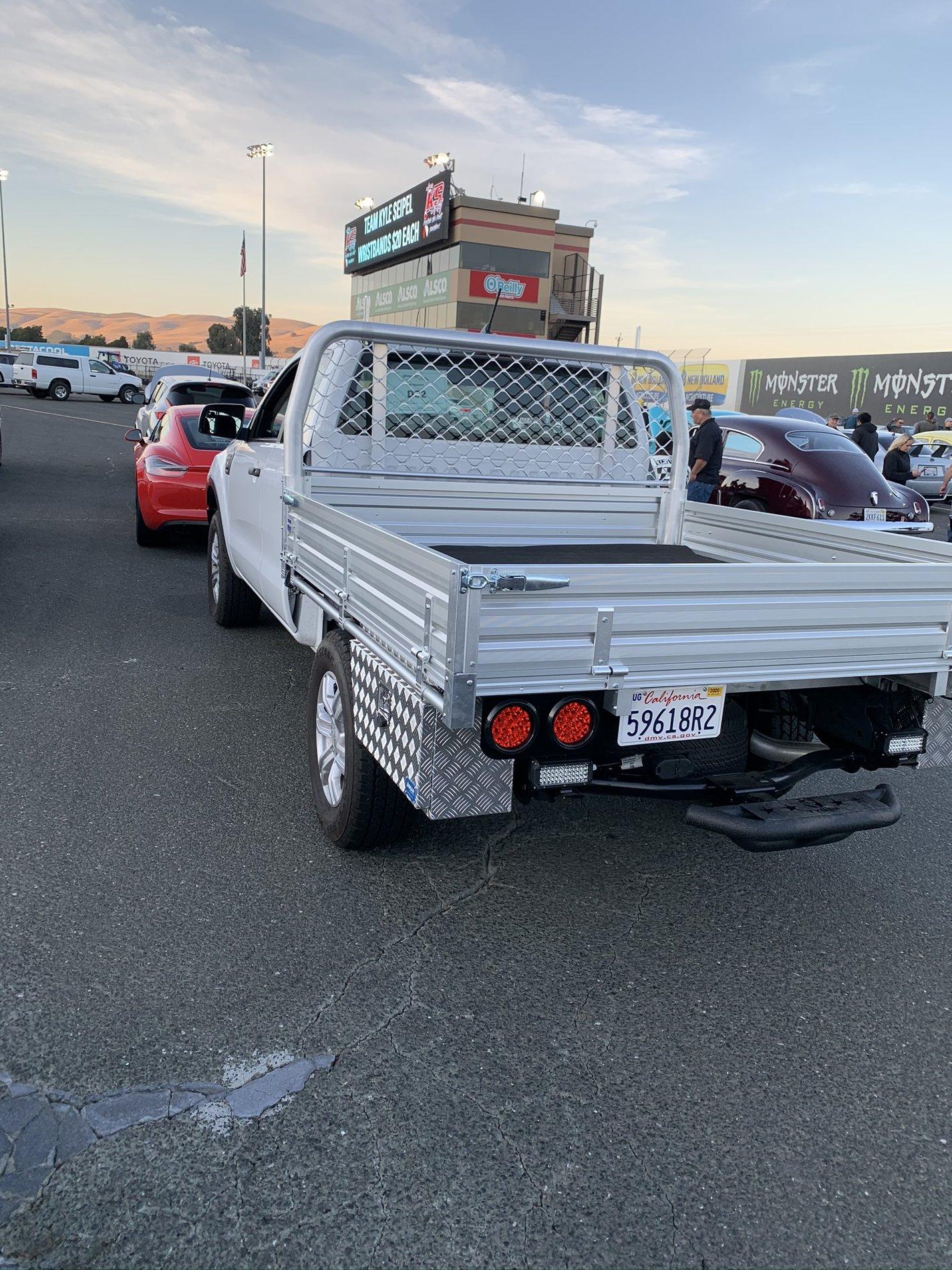

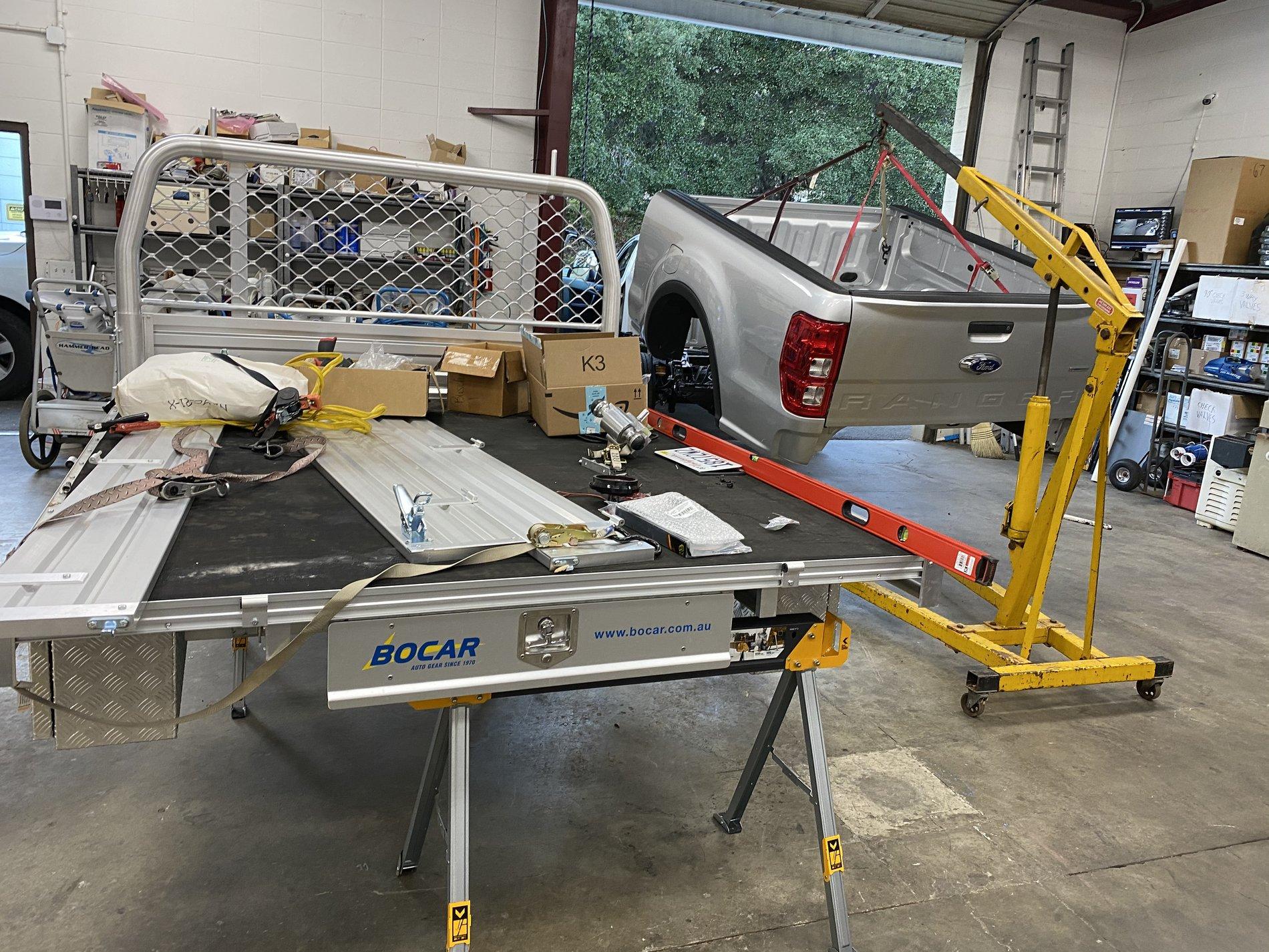

I have added three flatbeds to Rangers without any problems.
Those look good. Did any of the trucks have the LED tails that cause issues like mentioned above?

Not LED but I added LED lights. Why not just use led lights on the swap?
I think the issue is in the radar “sensors” in those taillights, the the LED lights themselves. I think they’d need to figure out how to mount those sensors somewhere else or find a way to disable them to stop the truck’s computer from thinking something is wrong.
