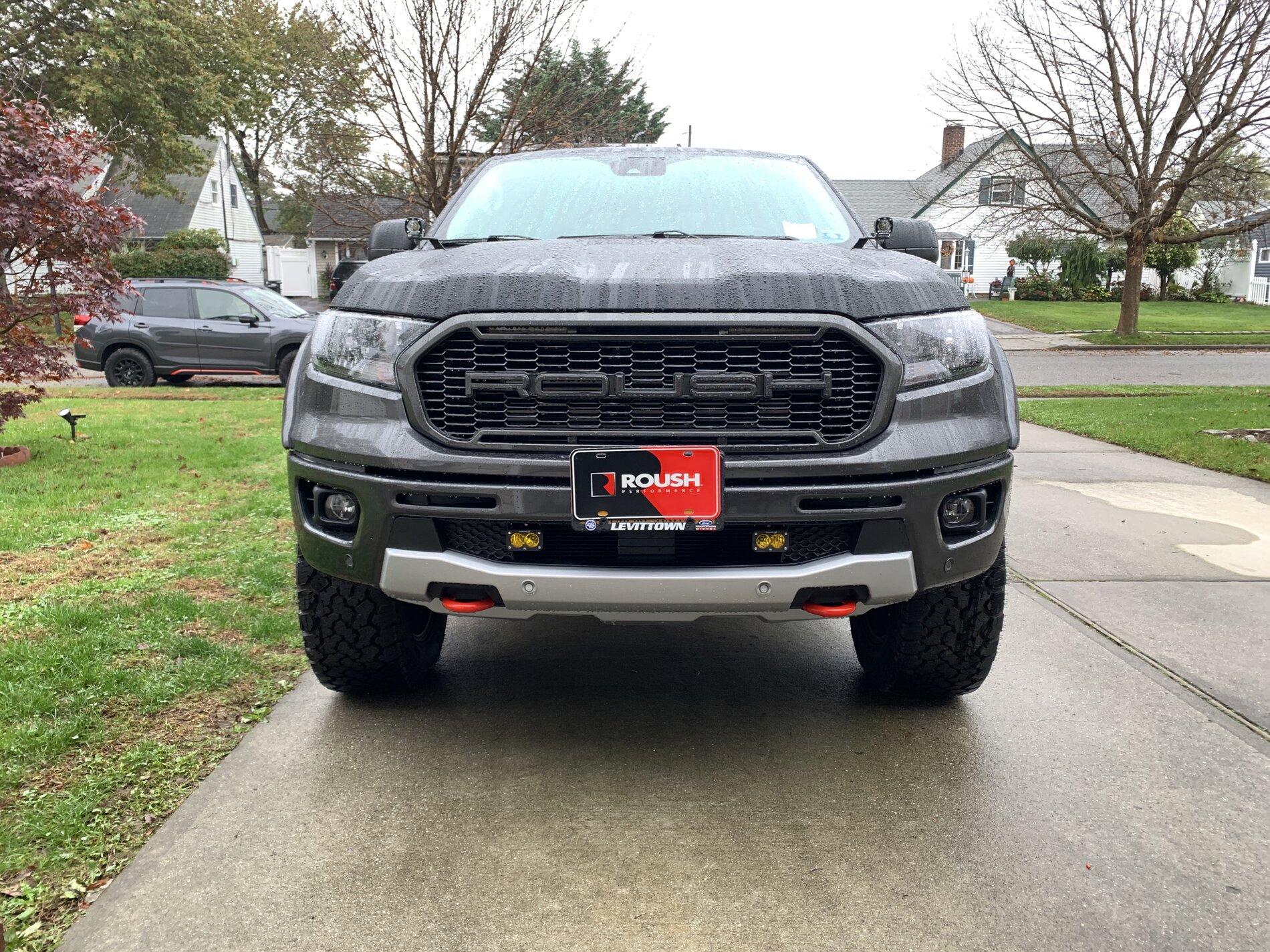

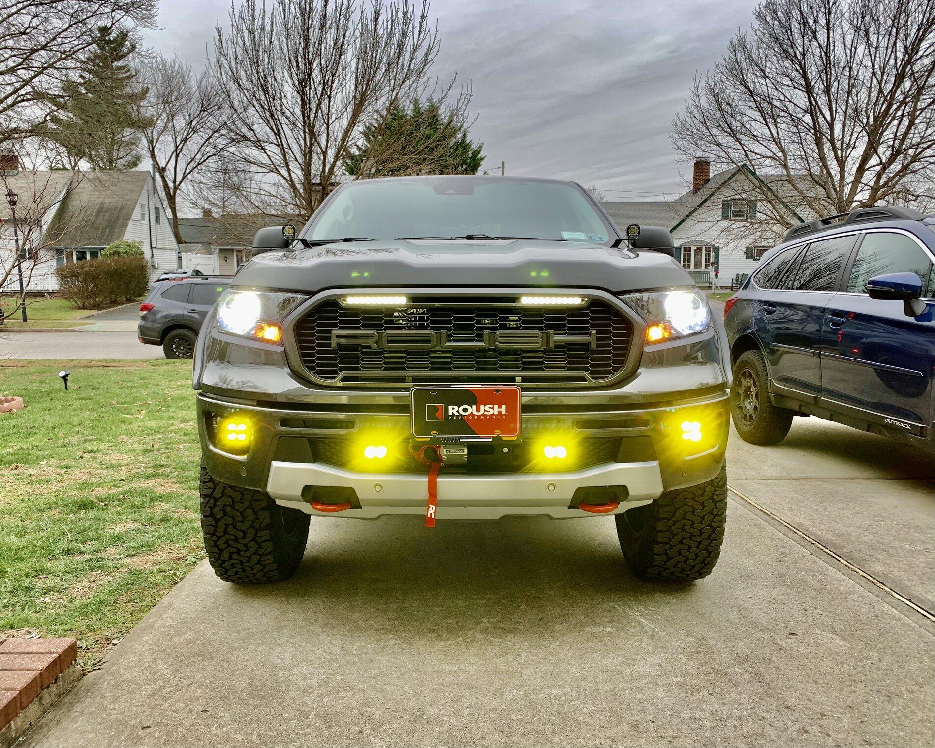

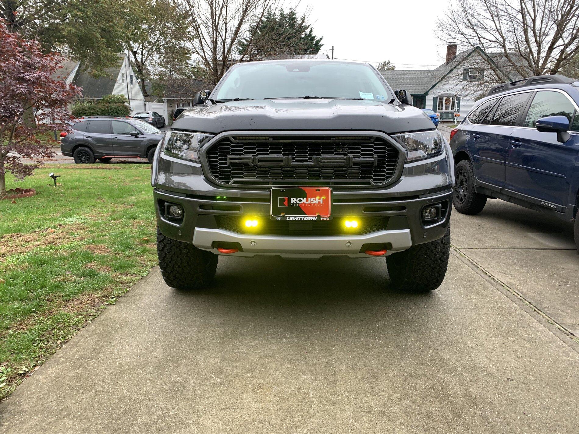

So these Baja S2 ambers came in today. :D
Had to wait til it stopped raining, lol.
Anyway....

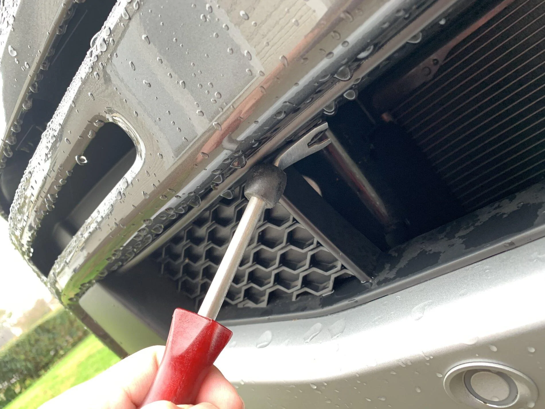

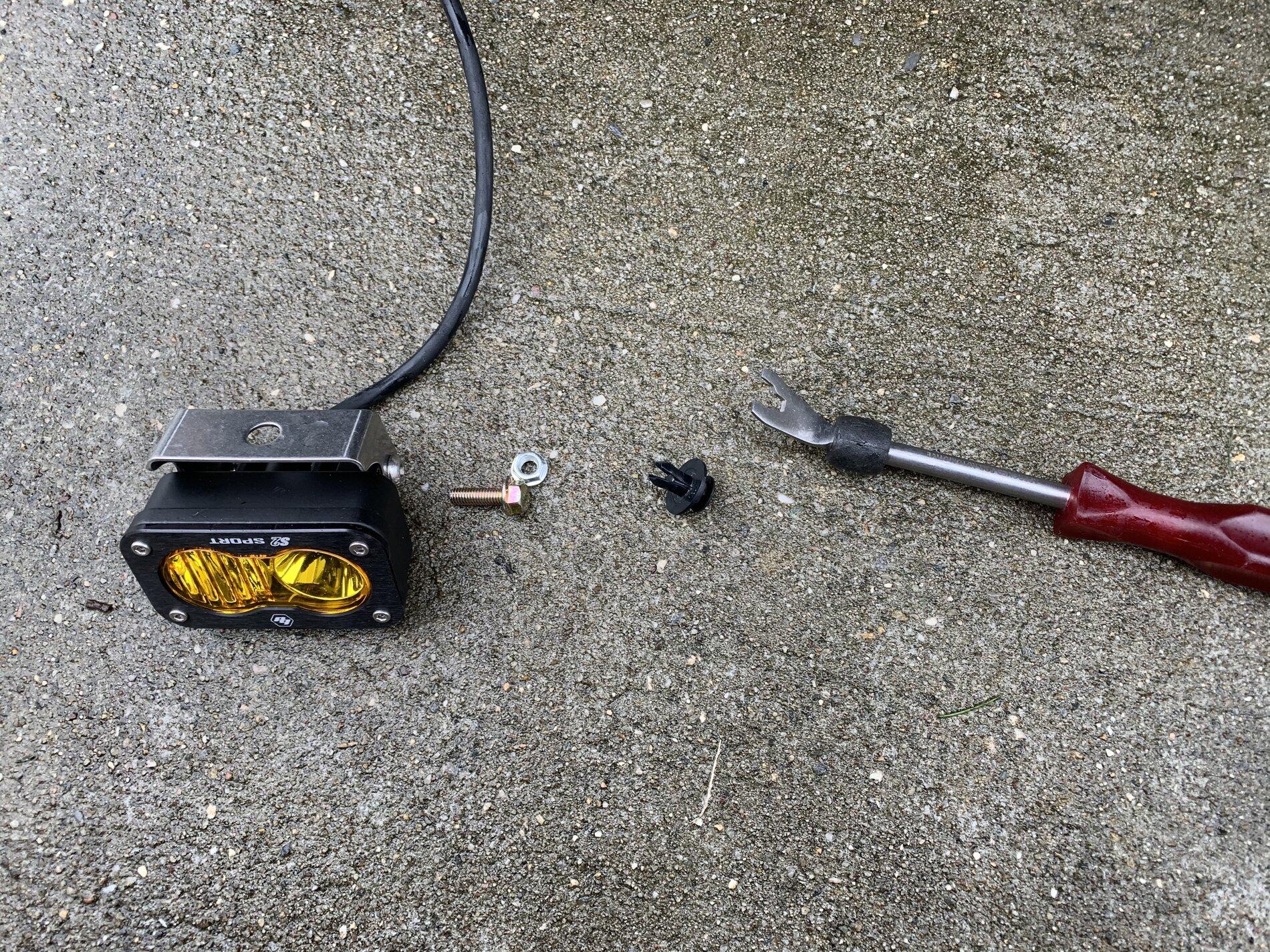

No drilling involved...if you want to use the same lower bumper fascia holes that I showed above. I used M6 x1.0 screws with flange nuts.
I just reached in from the back of the fascia where I removed the oem clips and replaced it with the M6 screw/ nuts.
Heres some pics.
How much light alone do those S2s add? I have been looking at the Diode Dynamics kit with 2 small bars on each side of the adaptive cruiser radar, this kit looks interesting as well.
Thanks!
They’re bright! brighter than S1, but less than S2 pro.
It would be suitable for off road use only or when its super foggy out.

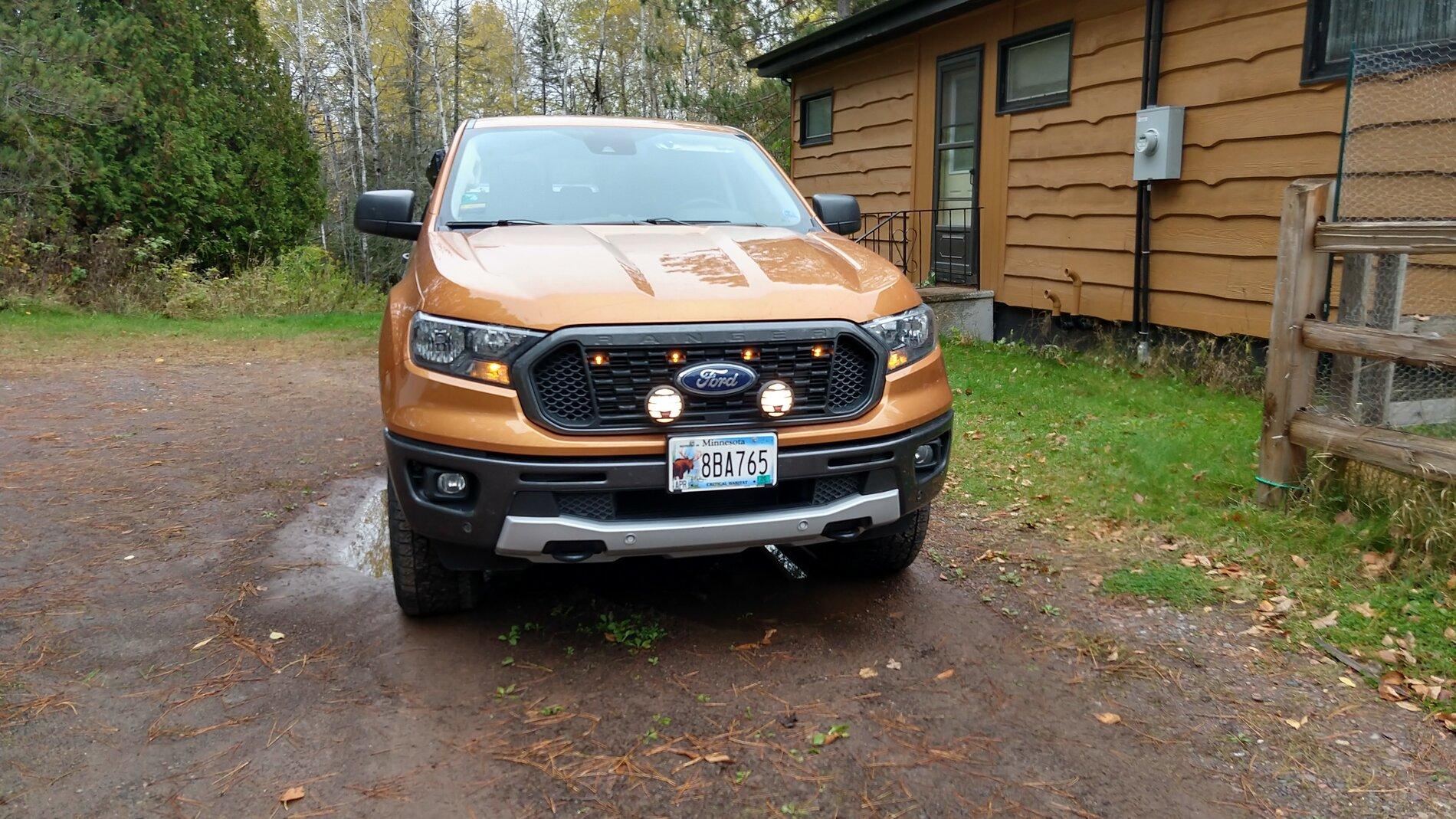

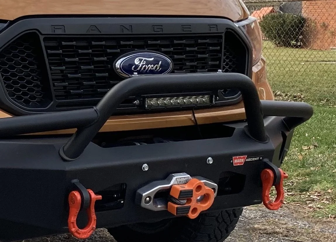

I have a small Rigid bar mounted on the bottom of my Baja bar that works very well. They come with a couple sets of "L" brackets that can change the direction of mounting but they are still near the ends. I didn't want to go through the bar and opted to have the wire exposed so I wouldn't have to disassemble if anything happened to the bar. Came with the relay and a red lit switch with very long wires that could be mounted anywhere so the switch is on the little smooth panel near my left knee in the cab.
What bumper is it? (sorry for off-topic)
