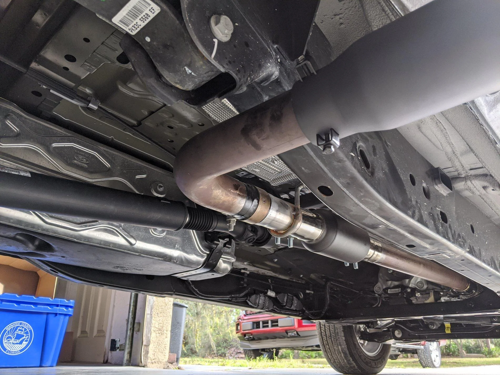

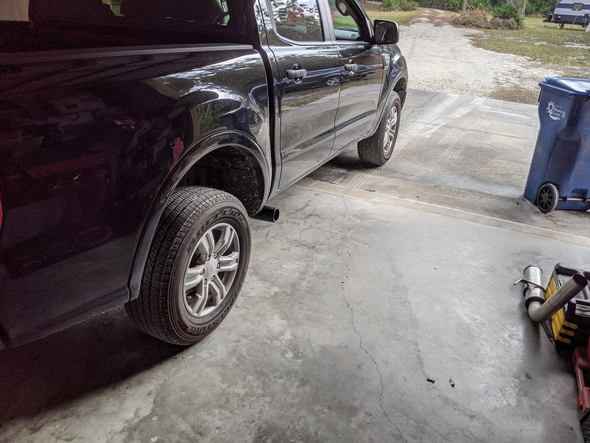

Here's a few videos of my custom made side exit exhaust. I used a hi-flow 13 inch long resonator, a section of straight 2.5in pipe, a 2.5in mandrel bent 90° pipe, and a DC Sports resonated exhaust tip. It's all held together with stainless band clamps with fiberglass exhaust wrap to keep everything sealed and leak free. Total cost was right around $100 and I love the way it sounds. Only thing I wish was that I was able to get the exhaust tip pointed a little to the back of the truck, rather than pointing straight out.
And just for shiggles and gits, here's a video of my truck when I was running a complete muffler and resonator delete with a turn down exhaust tip. Needless to say I wanted a little lower mellow tone so that's what made me make my own side exit with a resonator.

Ugh... sounds bad and it'll cook the spare tire too.
