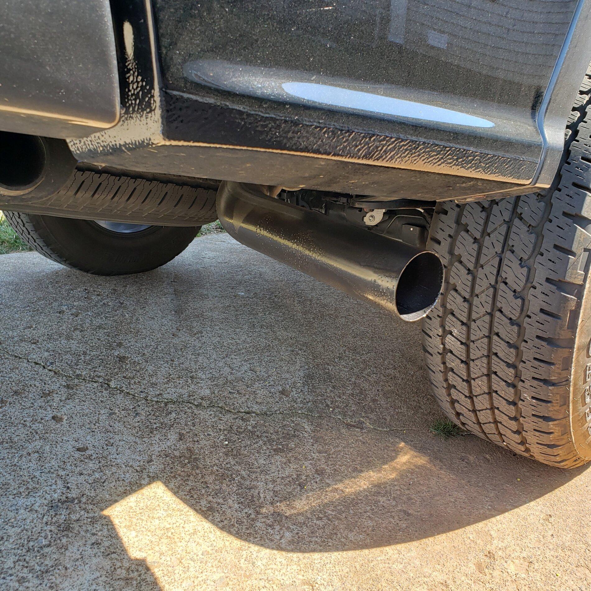

I painted mine with engine paint, there is a post here. It matches my magnetic package.

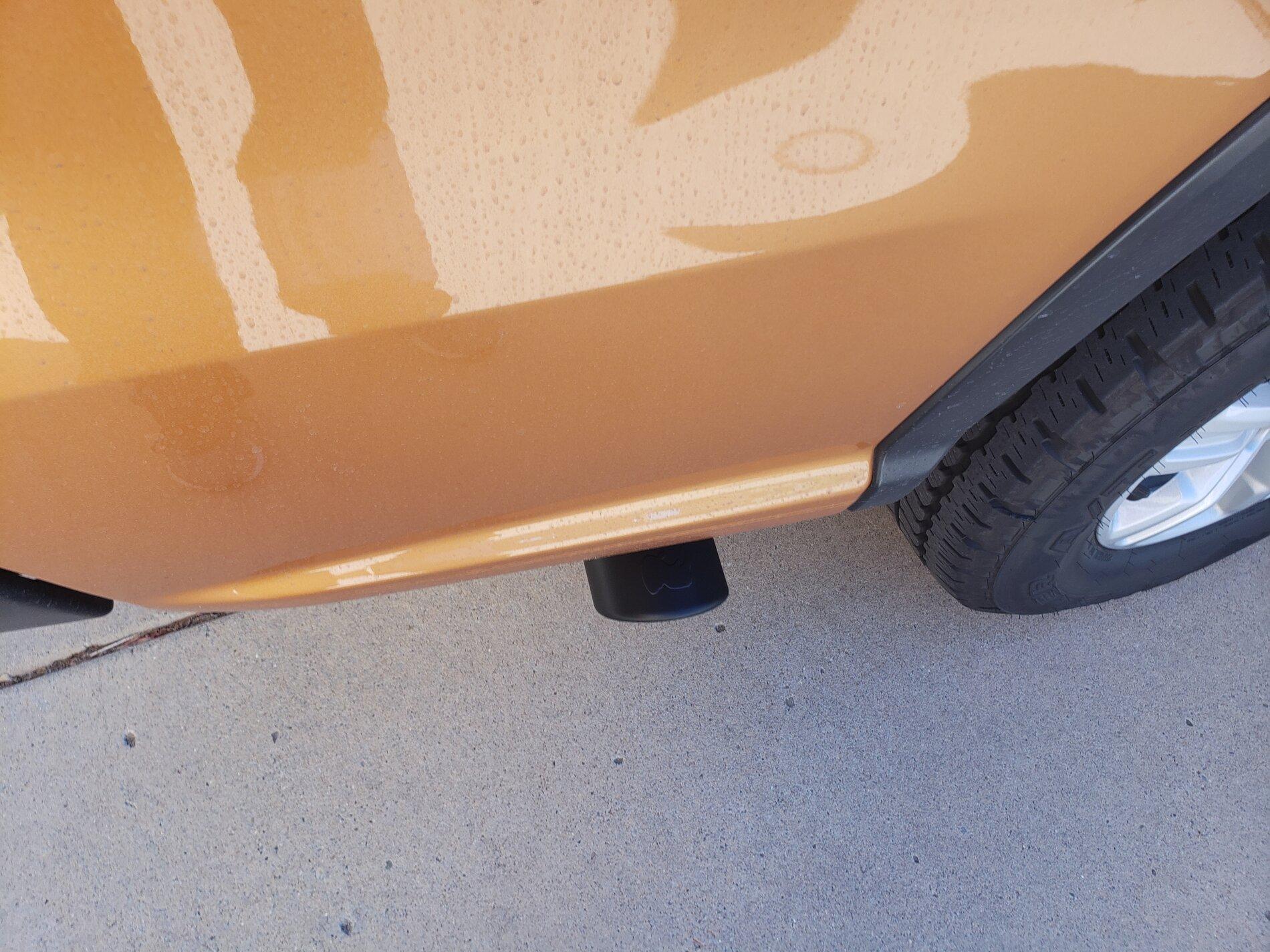

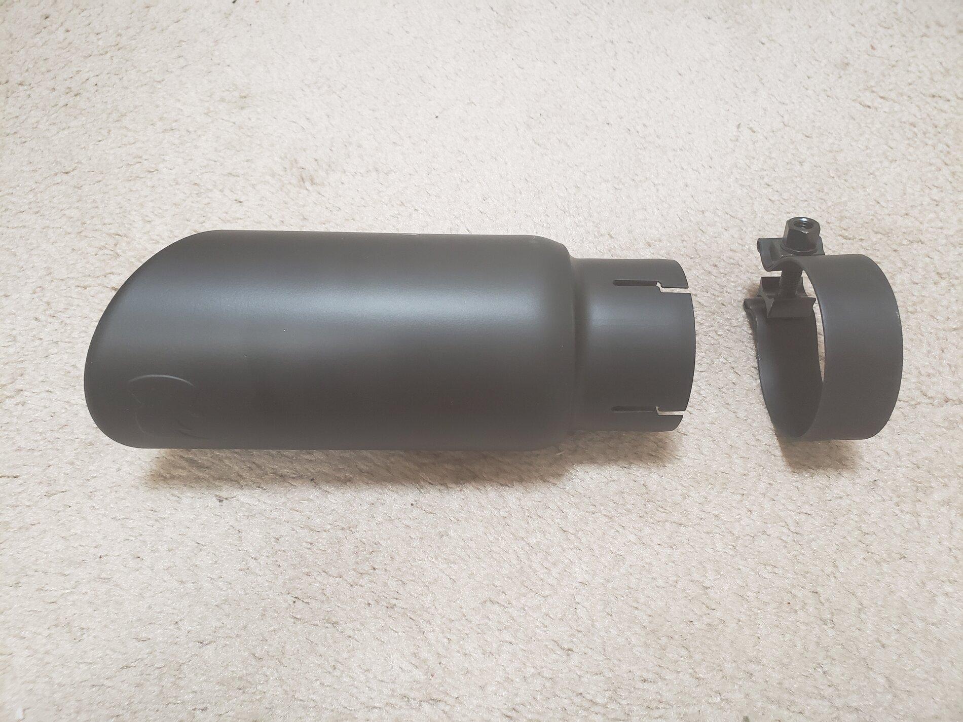

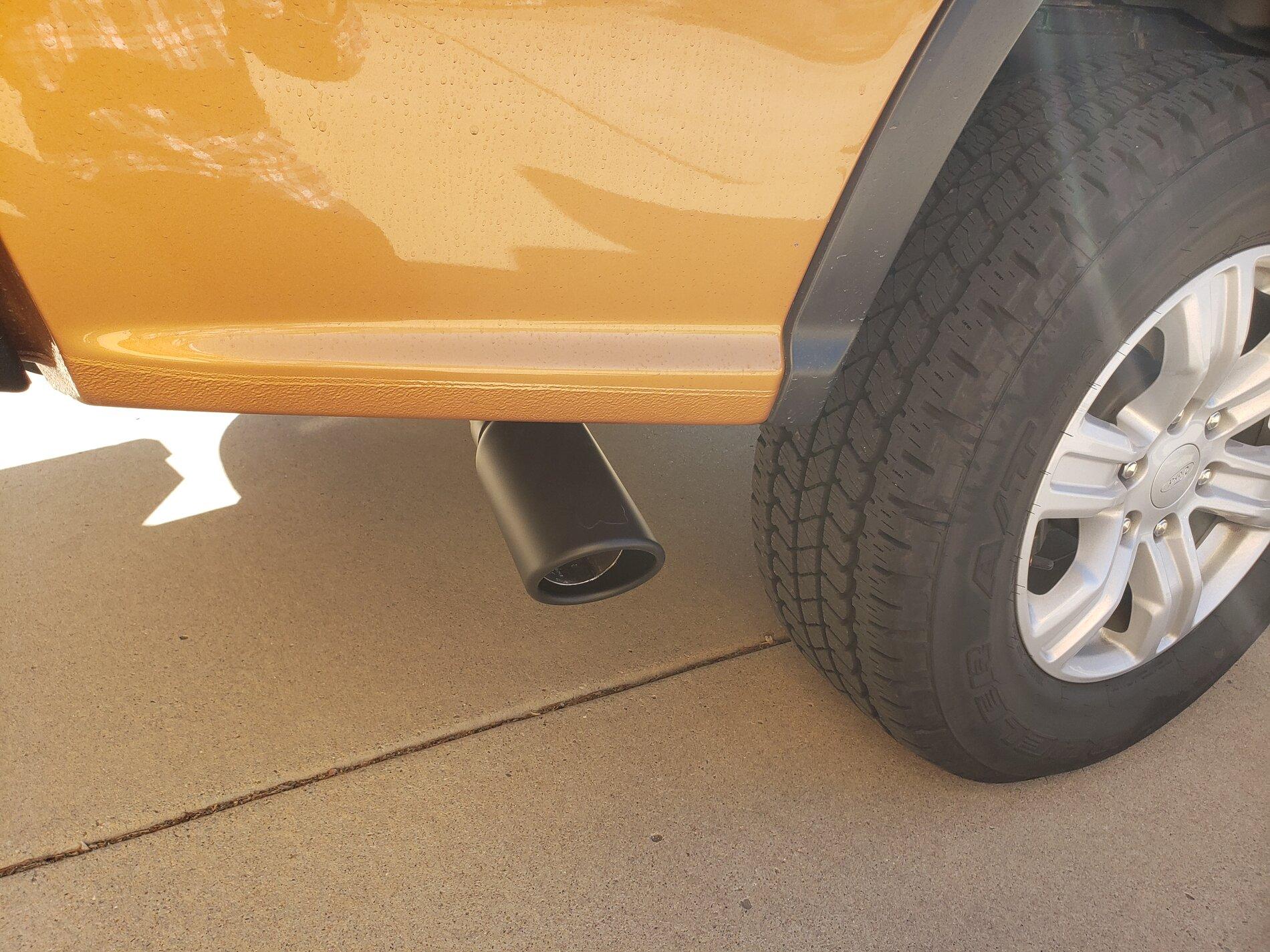

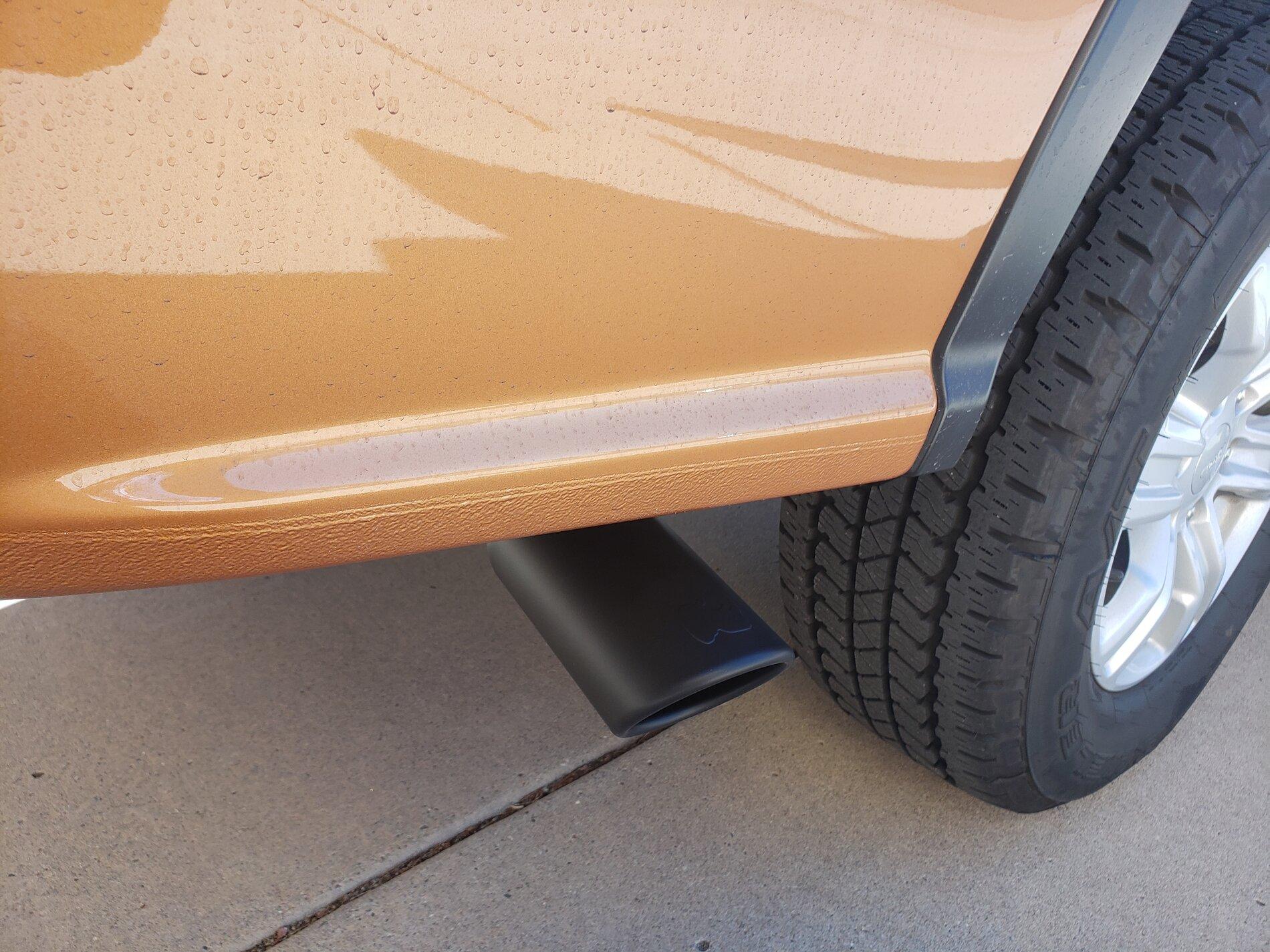

Go Rhino Black Matte Exhaust Tip 3" inlet, 4" outlet, 10" length (GRT3410B). This same Tip also comes in a 14" length. Got it at autoanything.com. Matches great with the black STX trim. I started by using a 3/8" drive and tightened it all the way but the Exhaust tip was still loose. I then decided to go with a 1/2" but said no, too much torque will surely strip the threads. I remembered that a member on this forum said to use WD 40 on the threads and this did the trick. I placed the back edge of the clamp 1/8" from the back edge of the Exhaust Tip (see photo #2) and tightened it down easily with the 3/8" drive.
