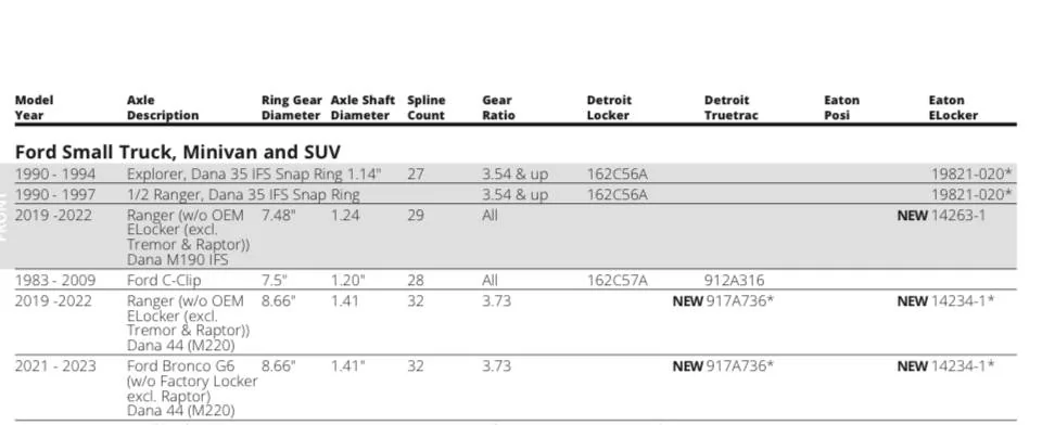

Thanks to Ford's "Better Idea" many have not bothered to do the LSD or Locker swap for the rear axle. That said if you go for the Detroit True Trac, understand that it is really only good for street use. I say this because it will act just like an open diff if one of the wheels is in the air.

And you have to buy a new ring and pinion since our ring gear is welded to the carrier.
Yeah, I saw that in the Eaton notes. More expense for no reason. Millions of ring gears bolted on with no problem: "let's weld it on!" ?‍♂

It looks like they only offer the E-locker for the front.
I would really like to get the TrueTrac there.
Unless you rock crawl (no real rock crawling in north GA, just mud and forestry service roads) the TrueTrac is a great off road differential, particularly in mud.
I have the TrueTrac in the rear and the Spartan helical (Spartan version of the same thing) in the front of my Jeep and have a running bet with my Jeep buddies that have Rubicons and are always trying to get me to get a Rubicon as well.
If we ever encounter a trail where my helicals are unable to complete the obstacle and the Rubicons navigate it easily, I'll get a Rubicon.
It hasn't happened yet.
Also, my Bronco has the Detroit Locker in the rear and the TrueTrac in the front and this is a dynamite combo, excepting the sometimes squirrelly street manners of my Detroit in the rear.
