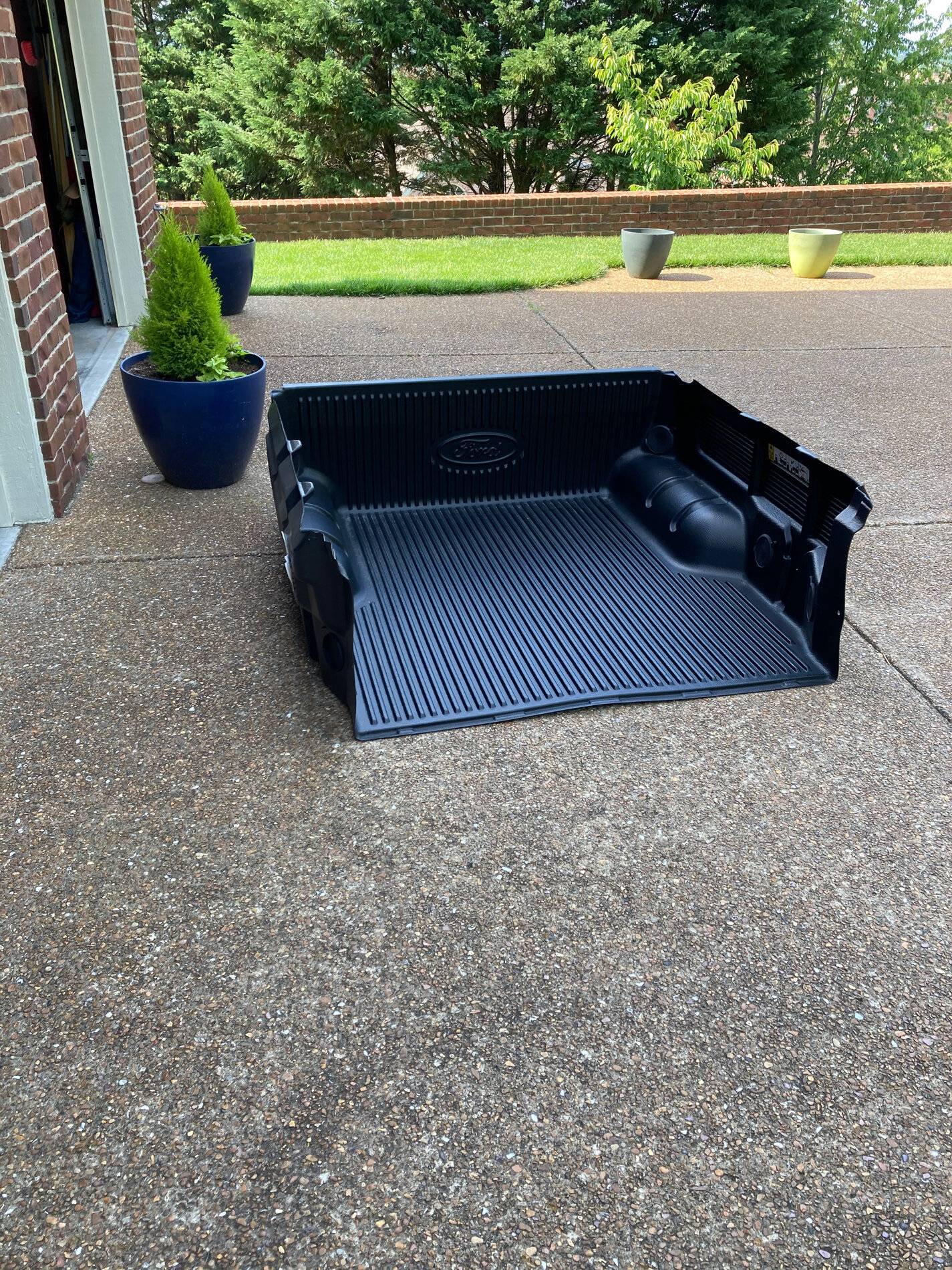

easy peasy. leave the bed rail trim in place. There are two oval shaped plugs, one each side up near the top edge almost under the top lip and towards the back. get under them and pry them out, they are a one time use push pin and will be messed up no matter how hard you try. rip em out, get pliers, go savage, yank em. then go get a cold beer
Then, IF they put two screws in the very back verticle edge by the tail gate , one either side half way up. remove those too. drink beer
Then grab the liner in the middle at the back and just strat lifting from the bed floor, way up there. the sides will come down from under the rails and you can pop them outside the bed. the front just sits over the front wall and lifts straight up. wiggle the whole mess out and throw it on your driveway. drink beer
drain pipes go thru a couple oval plugs you will see on the bottom of the front bed wall, drill holes for hose to pass thru. drink more beer
smile at your accomplishment and send me beer

Ok so let's say I want to take liner out to drill and get the drain plugs where they need to go...how so I get liner back in? New screws or what? Can I buy the plastic rivets that u said are a one time thing and break removing them?
bfastr
Bob
Apr 20, 2021
244
996
Nashville
2021 Ranger Lariat
well, if you go slow you can pry out the black plugs and re-use them.
Or, just put a couple screws in the holes in the very back vertical part. I think they are M6.
Thats all it needs and it wont go anywhere
