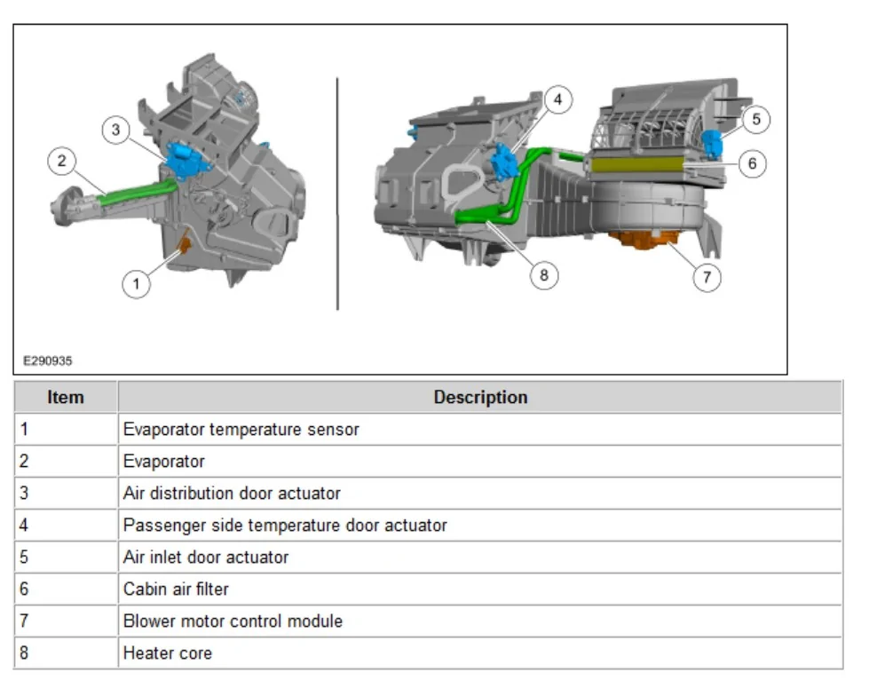

Item #3 in the diagram below is the air distribution actuator. This would control which vents the air is discharged.

The blend door complaint is usually that one side is hot and one side is cold. Which means that there is a control for each side. But you can control the temperature and your truck is made WAY after the Ford made the part change. I think that was july of 2020. So you dont have the awful repair. The way the actuator works is there is a little worm gear that turns a regular gear that moves an arm that slides in a weird shaped track that moves the blend door and maybe more stuff inside. So the one movement seems to control both the temp and where the air comes out.
So, to just answer your question. Yes, you could move the actuator of the way and move the little weird shaped track by hand, but it wouldn't stay. I assume that unplugging it would make an error code somewhere and the first time you hit a bump the track would move.
It is possible to replace the drivers side actuator without taking the dash board out. I did it. It is a bitch of a job. I wrote some of my experience somewhere on here and I did what the guy in this video did.

I was thinking of something else. That actuator that is behind the spedo makes ticking noises on a good day. The thing kinda hunts back and forth for maybe 5 seconds often. One of the ways the actuator fails is that it continues to hunt. So some ticking is normal. My "failed" part had no evidence of the worm gear jumping, so I had the hunting failure. Mine worked normal, just ticked a lot. You might get lucky and have a simple problem. there is a sensor that runs down and measures the temp coming out at your feet. Did anyone ever go rooting around under the dash?
