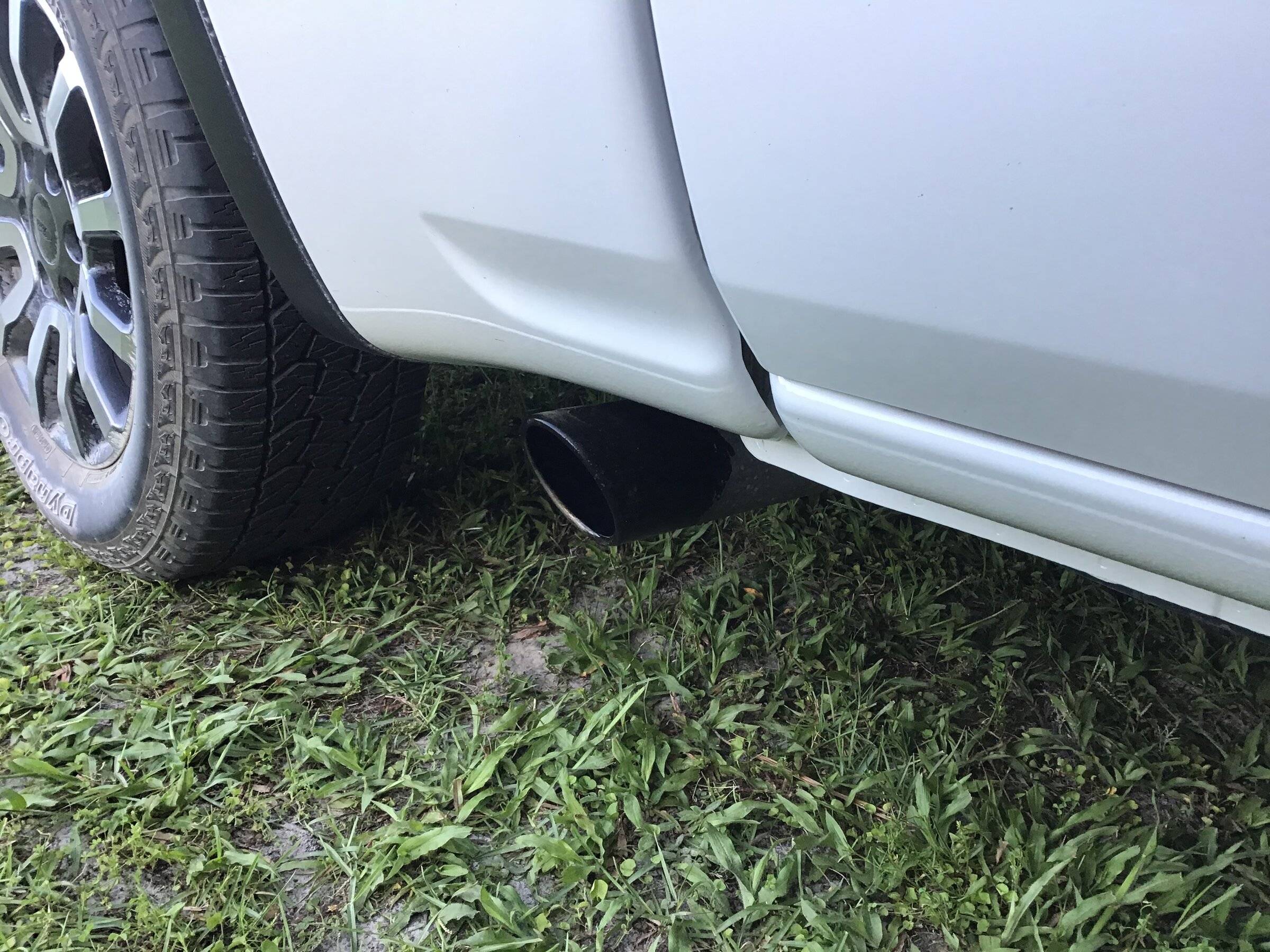

Muffler delete here .
Hi Doc,
I have always admired your posts for doing so I finally joined the forum.
Around 70-80 mph is there an uncomfortable drone? I had installed a Flowmaster 10 and it exited at the OEM muffler location and welded a hanger for the OEM location. It exhausted directly under the truck without a turn down and it would give me such a back headache due to the tone/frequency. The drone was so bad I could feel it but received a lot of compliments. Will the muffler delete scream and drone really bad at 70-80 mph?
Doc
Doc
Dec 24, 2018
94
5,837
23,523
Live oak fla
Hi Doc,
No Drone :)
