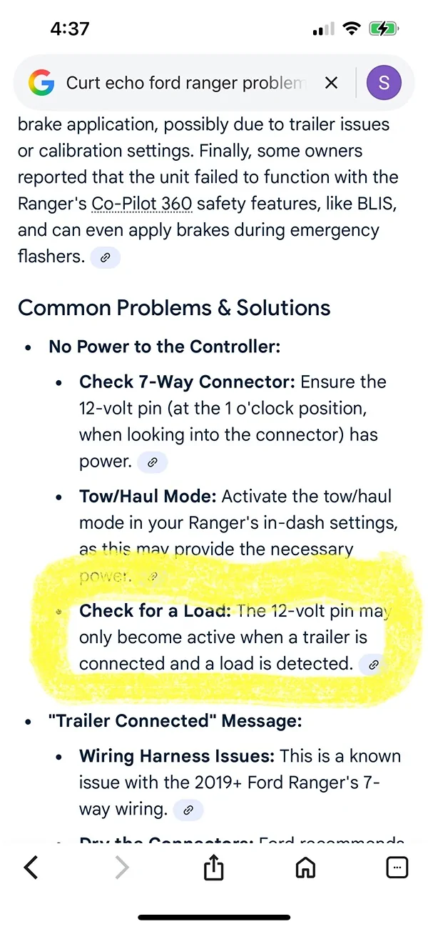

Pretty sure that the trailer needs to be connected for it to activate the 12v power
That's exactly it. I have this controller and have only used it a couple of times, but you have to have everything connected before you can set it up.
