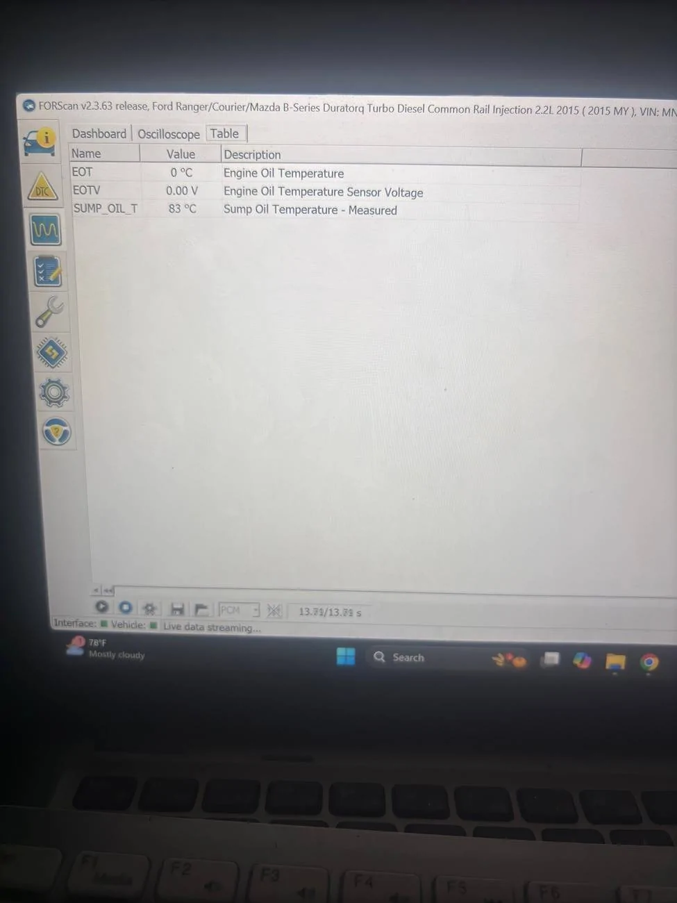

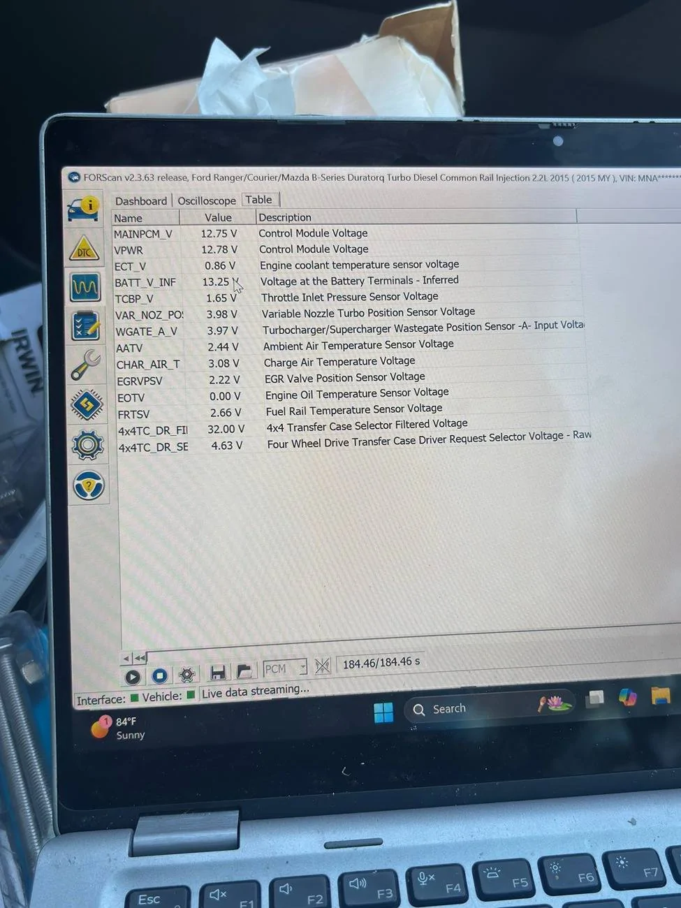

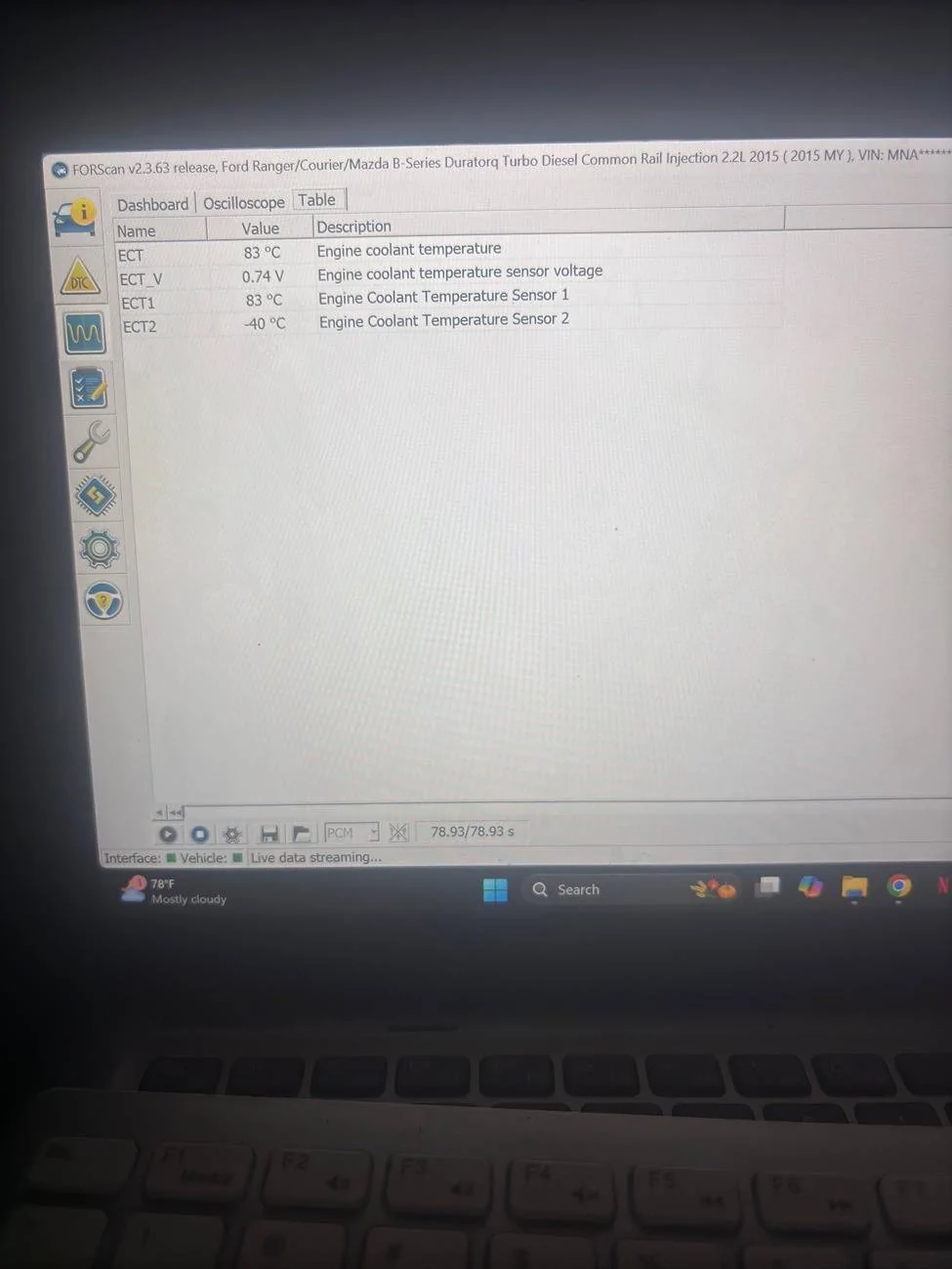

The P0480 can be caused by a failed coolant temperature sensor, so since you seem to have a low voltage reading on the coolant temperature sensor, it may be causing the code. What does Forscan report as engine coolant temperature with the engine warmed up and what is the ECT_V voltage warmed up?
I went for a decent drive and came back to run some tests on those 2 things you said and saw one of the sensors seem to be faulty but then I thought that I may aswell check the other temp sensors and it seems that they're not reading correctly aswell. would this this be each individual sensor failing or would there be something wrong with the power source or something like that. I don't know much about the electrical side of cars so finding this has left me a little confused.

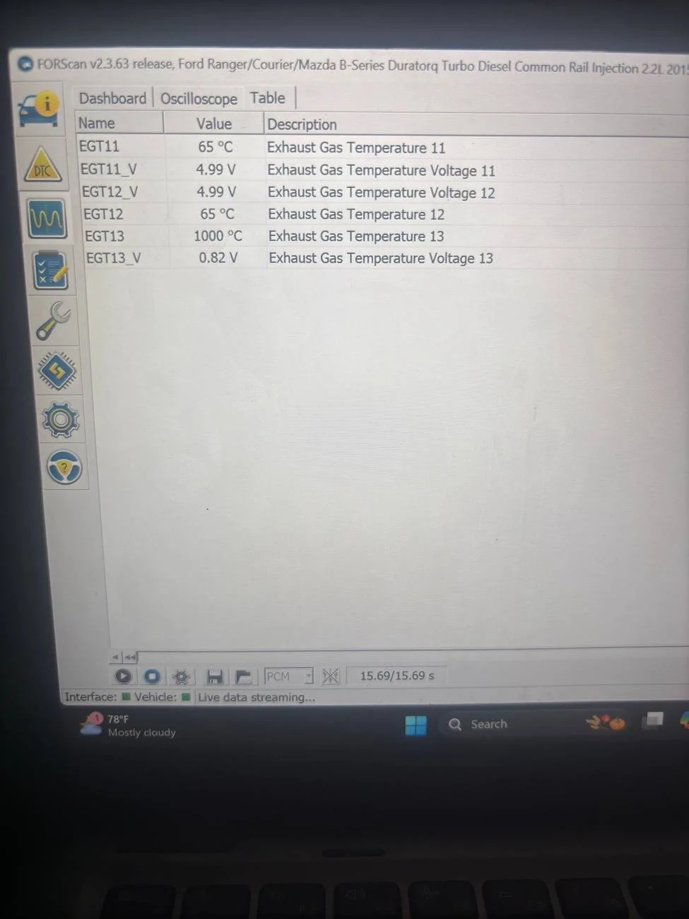

You have a wiring issue common to those sensors. It would seem to be a common power feed to those sensors. You would need a wiring diagram and a volt/ohmmeter to troubleshoot the issue. Could be a blown fuse or broken wire or a connector not fully engaged.

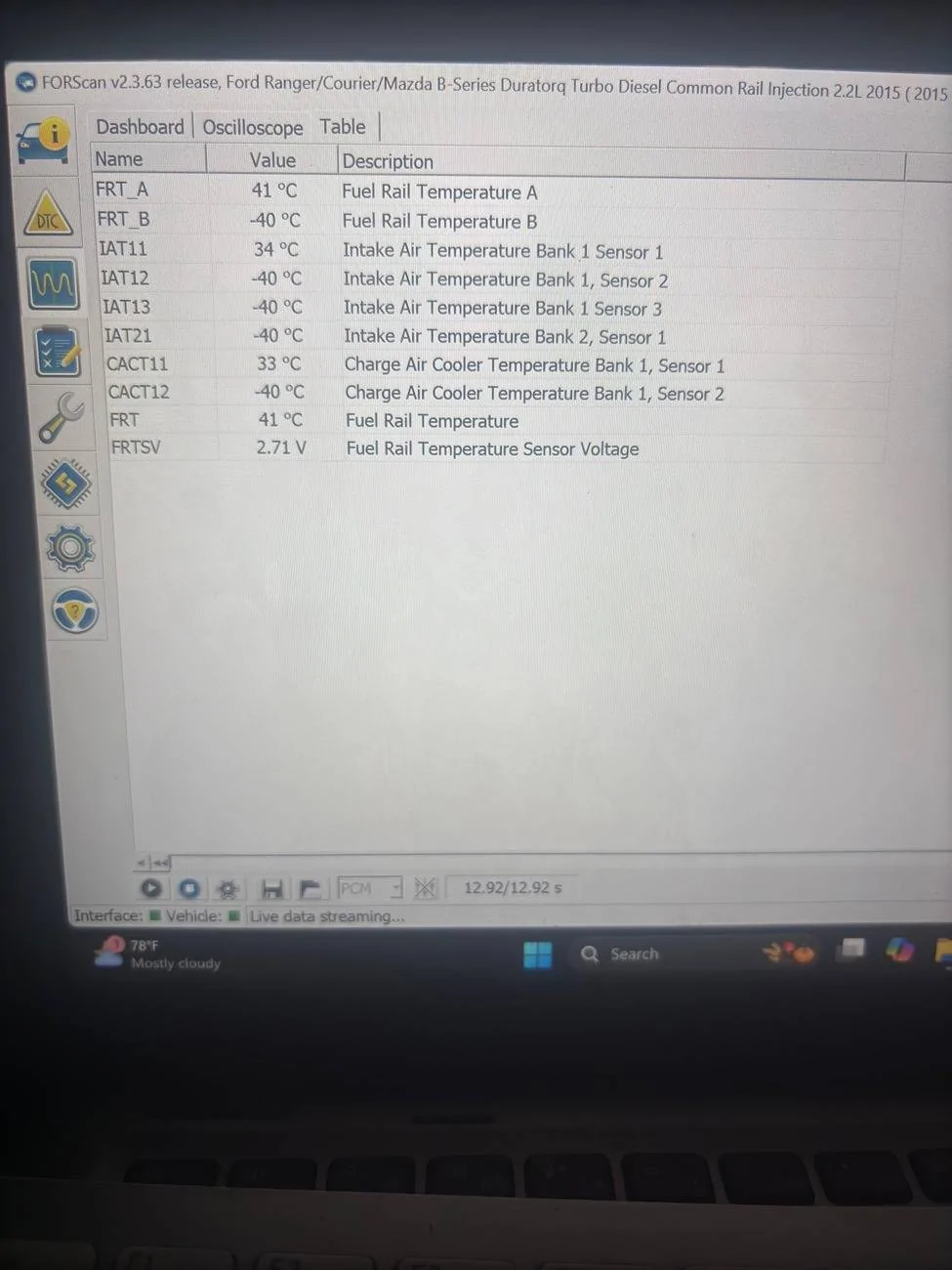

With Forscan being a Generic All-Inclusive software for scan and live data.
Codes:
I highly recommend getting a scan with a Ford Specific by Vin# scan tool due to the fact that you have a Disel Engine and a PCM that can produce fault codes -IE Cooling Fan, that are not relevant to your truck.
Live Data PID's:
Forscan is a generic software that can show PID's for sensors that are not even installed and since it's not picking up any data from the PCM - it is displaying a default parameter.
Example: I will use the IAT11 and IAT 12 as a Ref:
IAT11 = Intake Air Temperature (Intake Air Temp Sensor)
IAT12 = Intake Air Temperature (Measured at the MAPT) The US version Ranger 2.3 uses these 2 sensors. (The MAPT= MAP Sensor with incorporated temperature sensor) and we do not have a MAF Sensor.
I believe you have a standard MAP Sensor and a MAF sensor, so the IAT12 is displayed as an unknown default value of (-40)
Pay attention to the nomenclature of what the PID is, Bank 2 data etc may not be installed and Forscan still displays it.
Ref: Engine Oil Temp - The US Version Ranger does not have an actual Oil Temp sensor 2.3, the PCM uses INFERRED temp from the ECT and CHT sensors, so I believe the 2.2 will be the same, Forscan is displaying a Temp Sensor reading that is not installed.

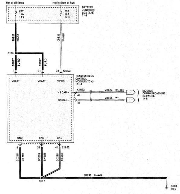

For the P0884 code:
See if you can find (locate) any PID's for the TCM
Module Power and view it
Try - Pull & Reseat the TCM Connector
Check these fuses: If Good
With a Meter - Check for Power at these pins
1 & 31 and 33
Check the Grounds - Continuity Check (Ohms scale)
Check each Pin to Body Ground - Should read .005 or less
