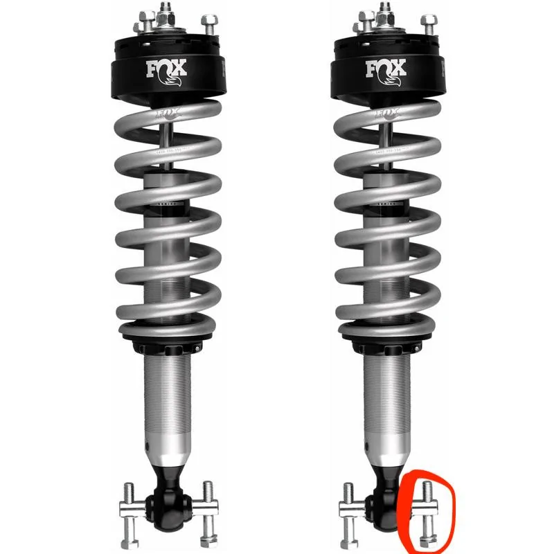

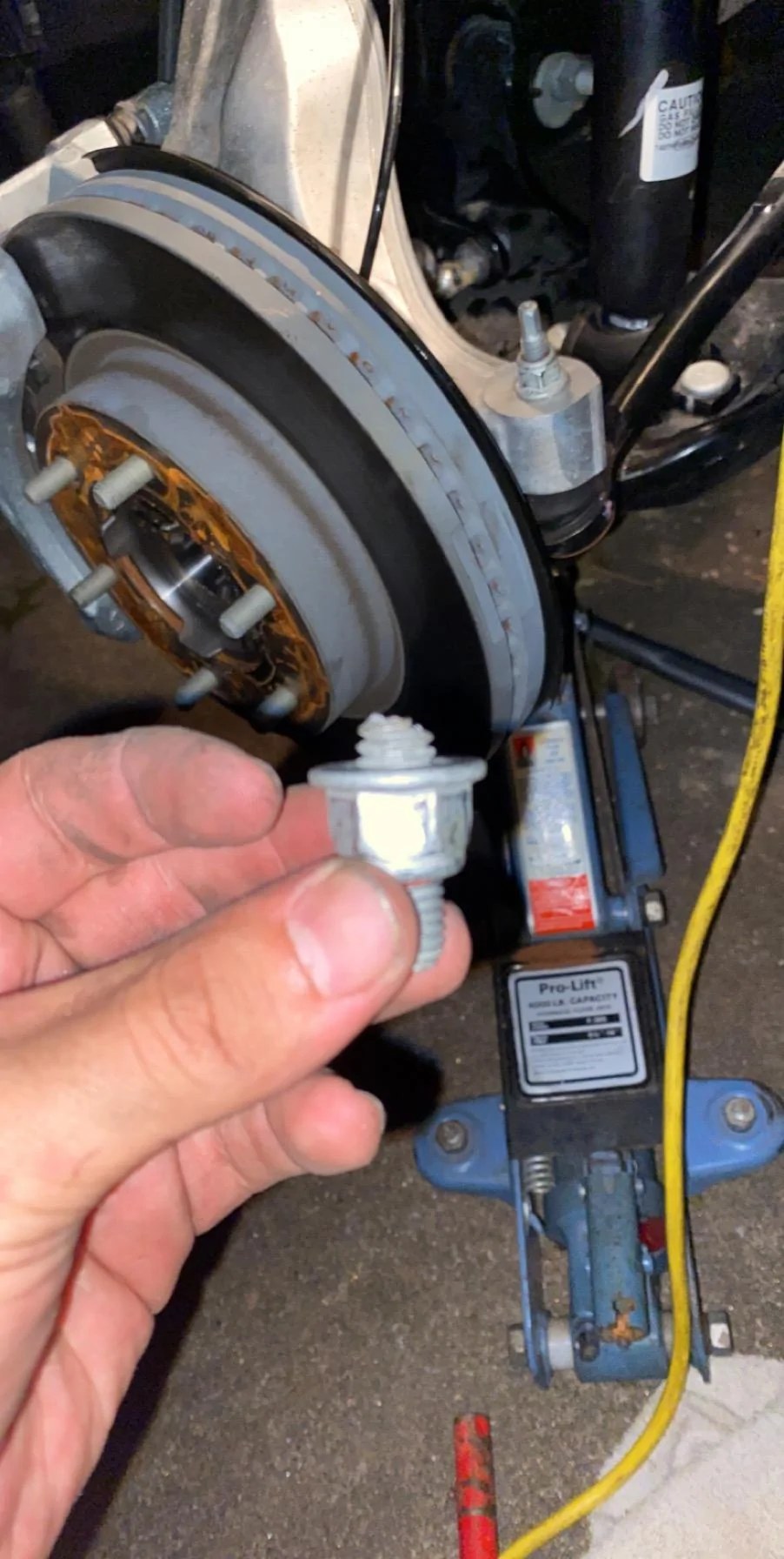

Hey y'all,
I ran into a little issue today while installing my leveling kit. My torque wrench managed to malfunction and didn't click on the very last bolt which managed to snap it right in half. I'm not sure if I'm calling it by the right name but it would be one of the 2 long 18mm studs that go through the lower control arm, and my google searches pull up nothing and ford's parts website is no help either. I have attached a picture of the stud and (yes it is not the OEM assembly but its as close as I could find quickly on google) a picture of the part I would be referring to. Would anyone happen to know the part number or generic/universal size for that specific stud, and perhaps if it could be ordered from oreilly or other parts store? Sorry for the lack of good information as I am just throwing this out there before I go to sleep, very tired from this late night install nightmare.
Thanks a bunch.

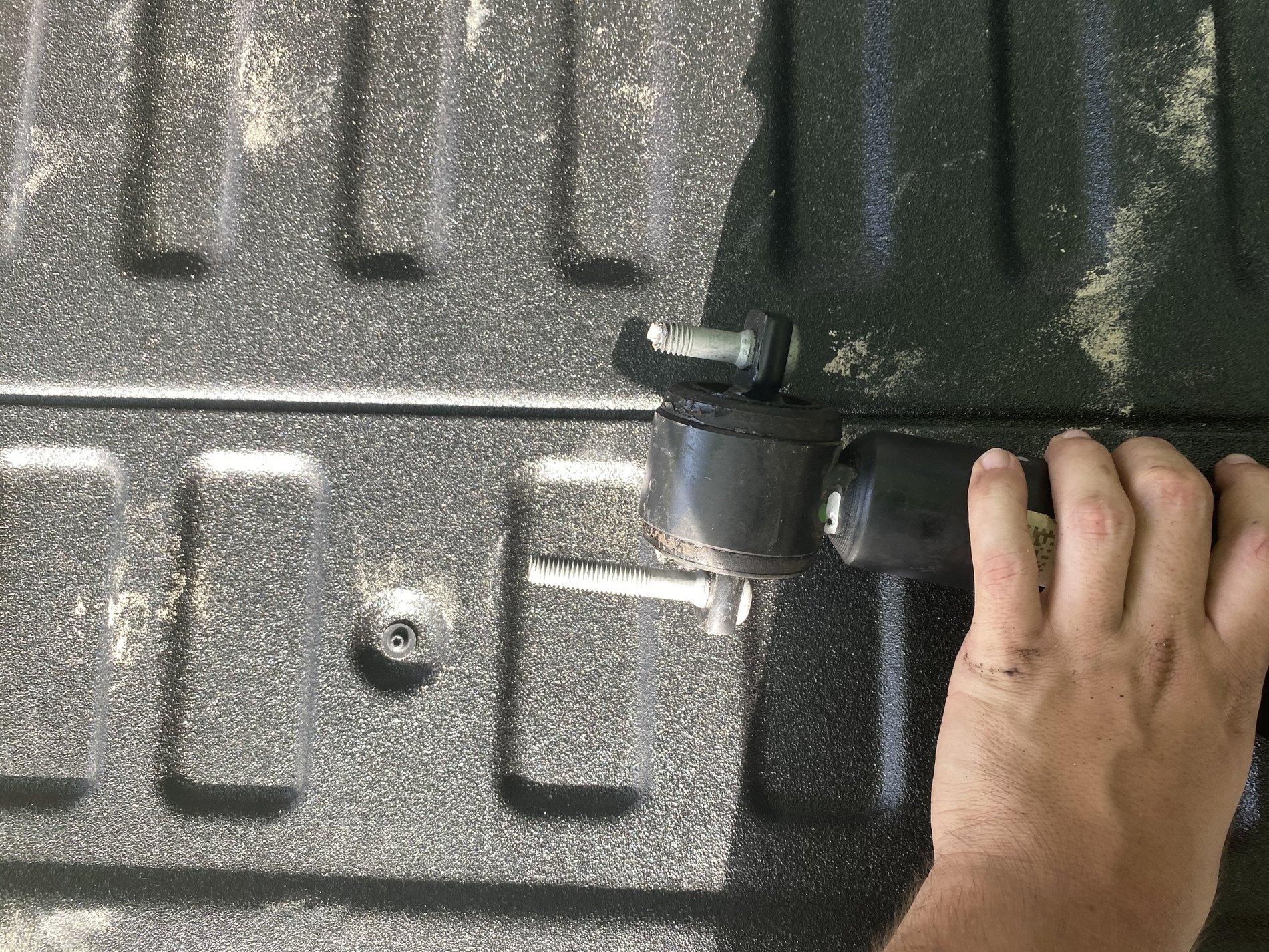

Hey y’all,
One more update: Managed to find the hardware needed (I used a M12x1.75x80mm, a 70mm would work just as good) at tractor supply co and rig up a temporary fix with a ferrule we had laying around in there towards the head of the bolt where the splines are to keep vibration to a minimum, washer, nut, and loctite. Trying to keep the driving to a minimum until I can decide to possibly get another oem bolt or upgrade to nicer aftermarket suspension. It works well so far, checked it after every drive and no change in the torque. Once again forgot to take pictures throughout the process but it was pretty simple and straightforward; did it in the middle of the day in this Texas heat and almost passed out 3 times trying to bare the heat haha. But we’re back on the road and leveled! Need to get it fixed properly within the week and then tires and alignment. Toe is pretty bad after installing this kit
