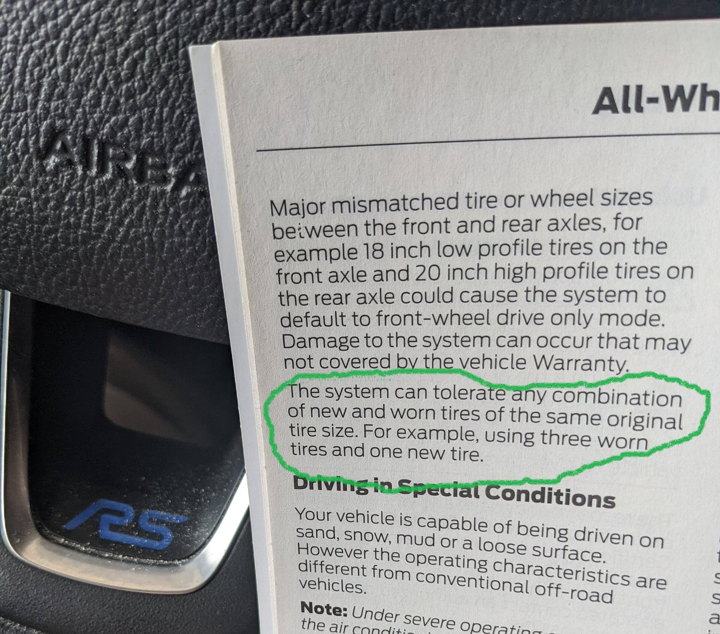

Nope, not that simple. The RS is AWD and does not have that rule, clearly states otherwise in the owner's manual. And on a 4WD since +95% it is it 2WD mode (no connection between front and rear axles) it can be safely treated like a 2WD setup. If you just want to spend more over a blowout and replace all 4, go for it. But I'm giving factual info for those that don't want to blow money they may not need to yet.

But how far worn is the question? If you only have up to 2/32nds of wear then you are fine. If you have more then that it will have problems. It will create accelerated wear on the powertrain. Also on a 4wd if you have tires that are worn more than hanlf up front and put new tires in the back the vehicle will start to buck the moment you put it in 4wd. How? Simple the tires are different diamiters and will fight eachother due to the transfercase not having any type of differential.
On my RS I had just put new tires on one of my wheel sets and had a sidewall blowout from a pothole, I put one of my other wheels on until I could get the new tire ordered and mounted. Drove around fine with 3 new tires and one almost to the 2/32 wear indicators all of them were 235/35R19 Continentals and there were no issues at all. The worn tire was on the primary drive axle even.
Bucking shouldn't happen in 4WD with different amounts of wear on front/rear if only engaged on slippery/loose surfaces as the manual states, one of the tires should be able to easily slip. If it's bucking you have too much traction and should be in 2WD mode anyway. And the tire different from mismatched front/rear wear on the same brand/model/size tires is going to have less impact than steering will on the rotation difference.
