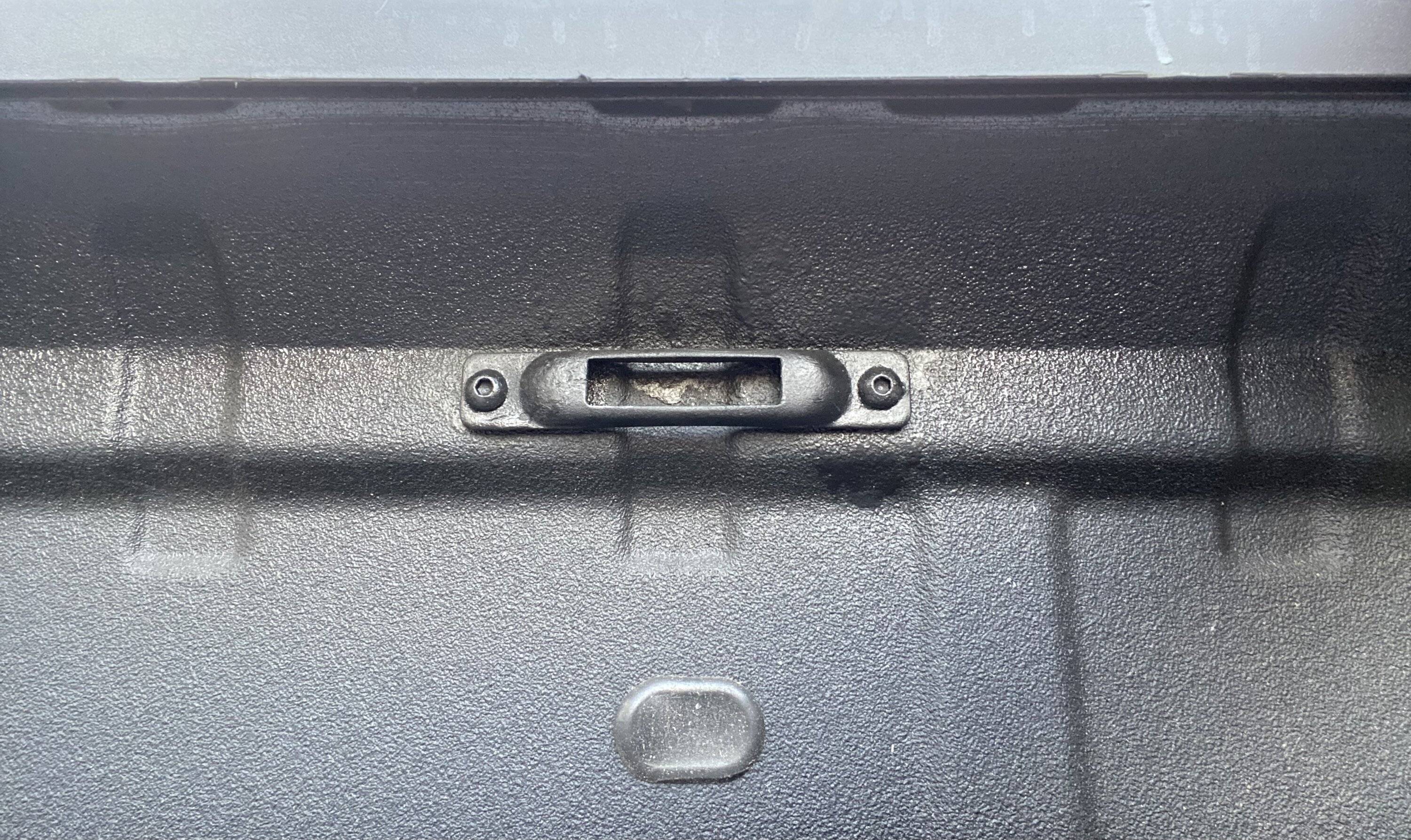

I'm not trying to beat a dead horse here, besides this isn't a forum on the new Mustang <insert rim shot sound effect here>
OK... Should have been six but only came with four... Ford bad.... Now we're all caught up except.......
I keep hearing that there should have been six, but isn't there actually holes for eight? Two in the back, two in the middle, and two up front but then another two above the two up front?

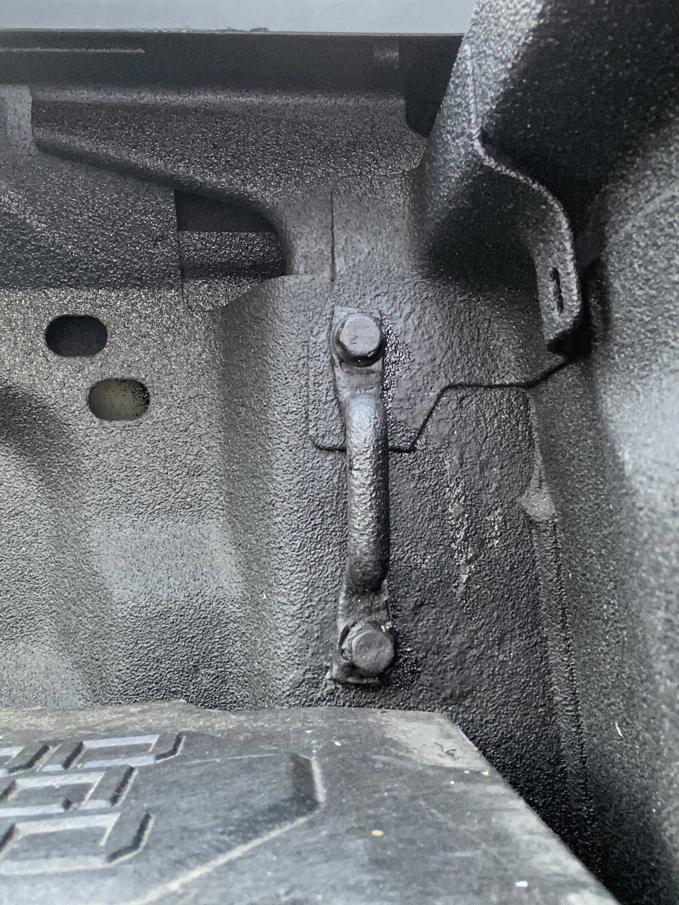

I am planning on getting a DECKED Drawer System for my Ranger and I was watching an install video. In order to mount the Drawer System, you have to remove the two front tie downs and replace them with brackets that DECKED sends you. The person in the video said that they were going to keep the tie downs, get new bolts and mount them in the holes above where the brackets go.
A real quick estimated measurement sure seems like these holes are the same size. Is this what they are for? Is it OK to mount the tie down in that position? Will it hold?
Also, has anyone else put a DECKED Drawer System in their Ranger? I'm getting the eye bolts that I saw mentioned on this forum and I was curious.... If I placed the eye bolts where the center tie downs should be, could I run some paracord from the eye bolts, up the side of the drawers to meet in the middle to use as a tie down strap across the deck of the Drawer System? Obviously, for light duty purposes.
Lastly, I know a lot of people were upset about not getting the middle tie downs but that isn't what bothered me. I upgrade to the Ranger from a SportTrac. I knew I was going to miss the boat type cleats on the outside of the bed as I used them all the time but I found some after market cleats that "work with most trucks". I was OK because I figured I could get some of them. After buying my Ranger, I found out that it isn't like "most trucks". I'm no truck designer but I'm not sure why the Ranger bed couldn't be like "most trucks".

I have a decked system on my Ranger. The holes near the top of the bed, next to the cab, are close to the ones the tie-downs will be removed from, but not exact. You will need to elongate the holes in the tie-downs a bit; the 8mm bolts will work in the factory holes.
For center tie-downs, I drilled some holes and installed some 8mm rivnuts; to those I mounted E-Track cleats.

Since they don't fit exactly, do you know if the other holes in the front are still reinforced for a tie down or are they just holes in the sheet metal?
Thanks

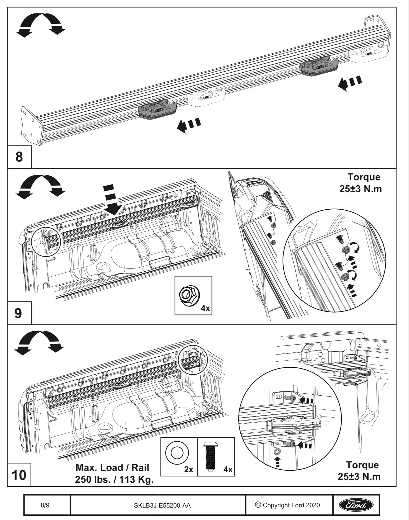

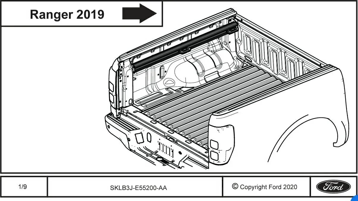

The other two holes in the front are for mounting a tie-down track system. The other end mounts against the back of the tail light housing. With sliding cleats, you can have as many anchor points as you wish. Super Crew only. Benny @LevittownFordParts.com can hook you up but availability is questionable.
Rail Assembly Pick Up Box - Ford (LB3Z-2655200-A)
Thanks
I don't have a direct answer for that, really, but they feel strong. The only ones I trust to be load rated are the ones with factory threaded holes. The E-Tracks I added to the middle I consider to be light duty, but I'm usually tying down camping equipment or lumber, so that's all I need. The factory tie-downs near the tailgate remain usable even with the decked system, they are just tucked under the drawer system a little.
Thanks
The other upper holes are spaced 110mm on center, while the (3) 'original' tie down hole sets are spaced 95mm on center. So you'll need to spread the factory tie downs out another 15mm for optimum fitment. All (16) holes in question are the same size and reinforced the exact same way; with M8 weld nuts and a reinforcement plate. The (4) mounting points in either forward corner are actually attached to a single long reinforcement plate.
TL;DR Those extra holes above the front tie downs are (by design) just as strong as the tie downs holes themselves.
