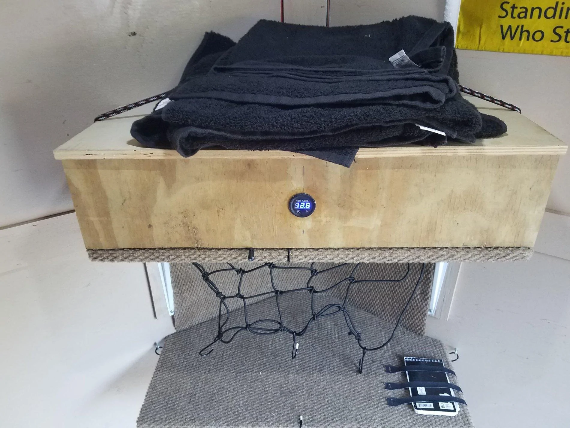

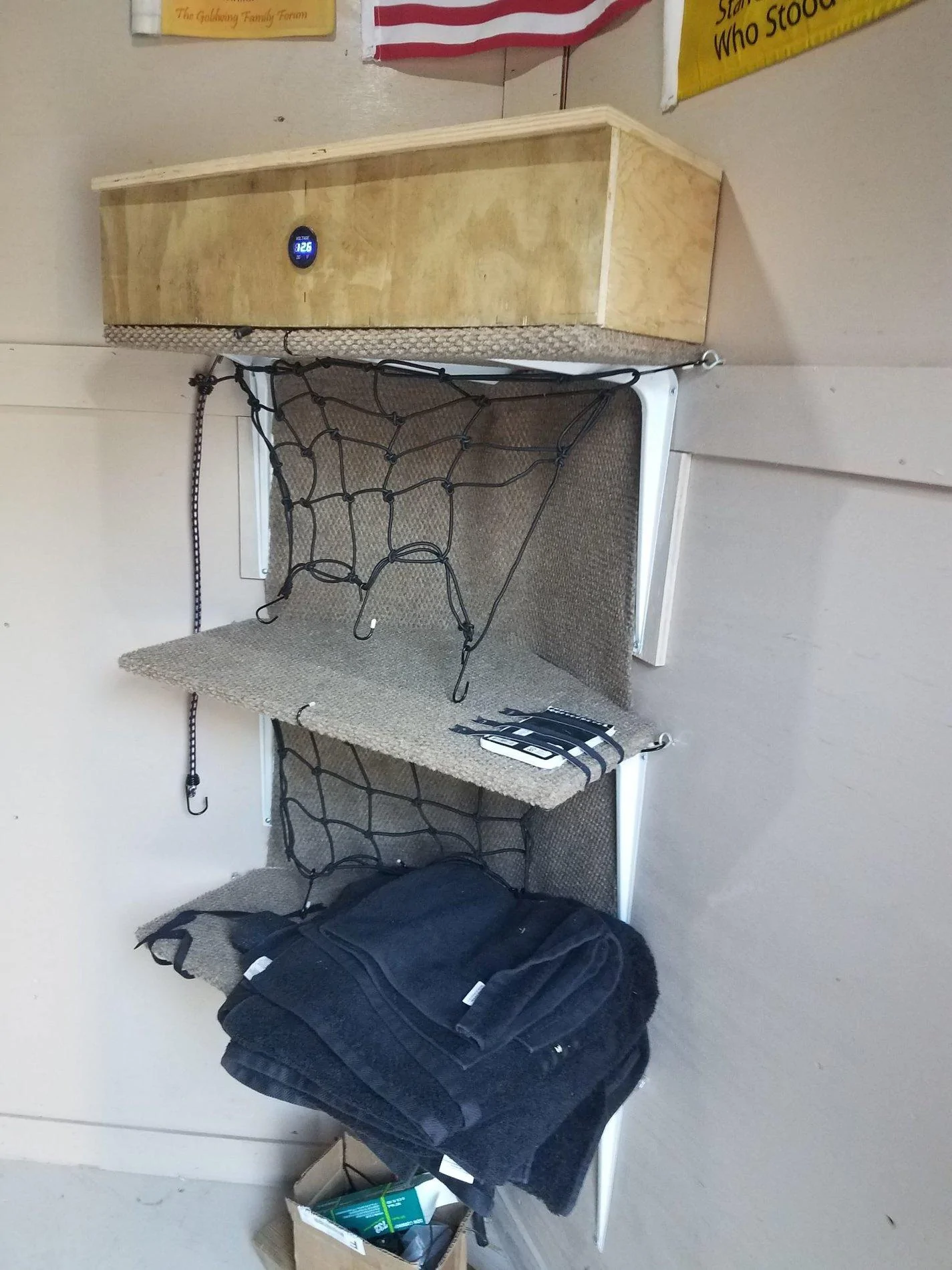

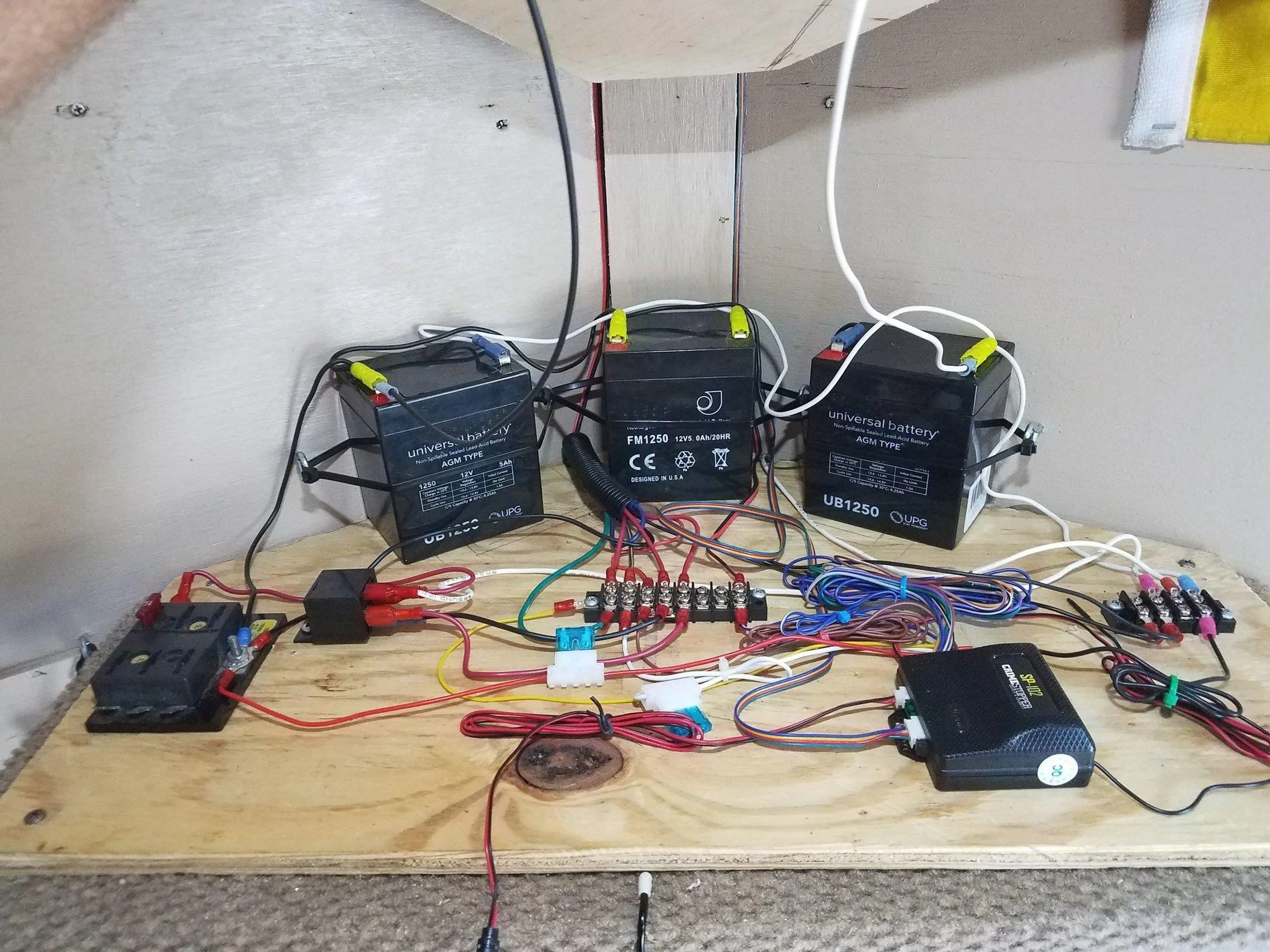

Finally got it all wired up and installed.
Mounted to the top shelf
The wiring under the cover

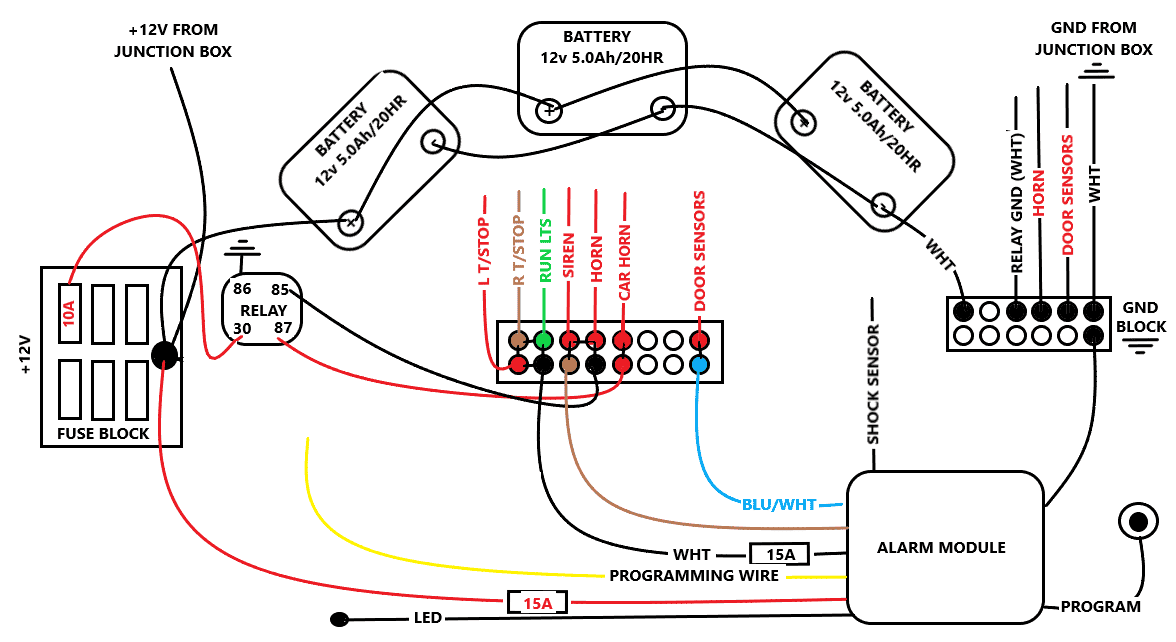

The wiring diagram so the mess makes sense

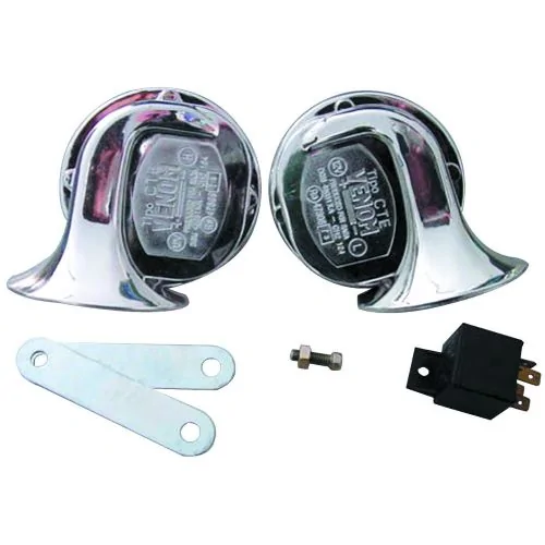

The siren came with the Alarm and I added a small piezo horn for the inside of the trailer and a car horn from Harbor Freight and installed it under the trailer where the siren is installed.

I am gonna add another HF car horn and put it on the inside so whoever thinks they want inside can't disable the alarm and all the horns by just cutting wires on the outside. All my power is located inside the trailer.

This is the view looking in from the side door.
The junction box is located behind the cardboard box at the floor. My containers for my E-track supplies and ratchet straps sit there and will hide the junction box when I am using the trailer.

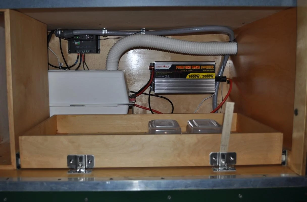

We have a 100 watt solar panel & group 27 AGM to power the teardrop trailer, lighting, galley stuff, entertainment (TV, sound bar, Blu Ray, stereo) & the alarm system. It's all wired through a PD4045 panel in the galley, for both the 110v shore power & the 12v systems.
Tamper switch is under the spare tire, siren is tucked inside the rim where you can't see it. The siren is about 1' away from your ear if you try to loosen the spare to steal it while you're laying on your back on the ground with a wrench. Surprise!
