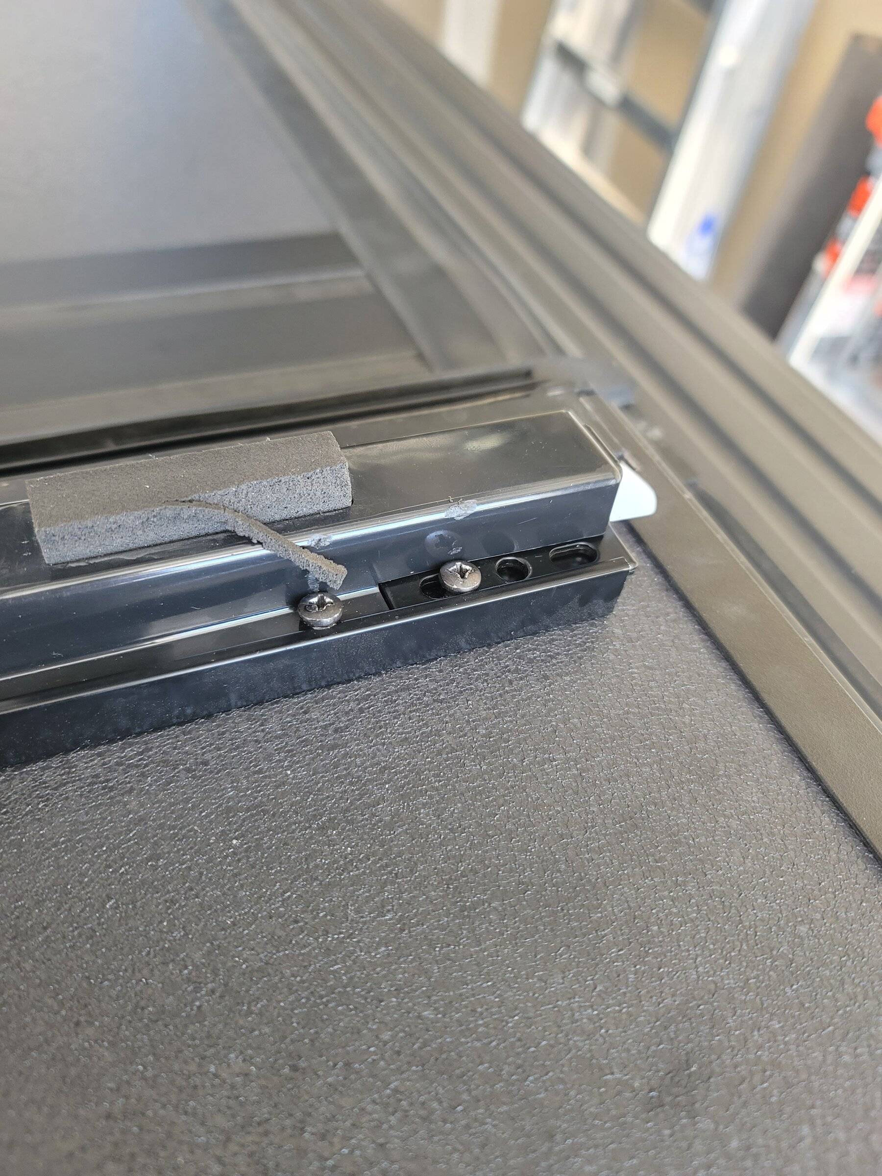

I had this for less than a year and rarely open it up. Today I tried opening and it broke. Has anyone had this issue? I contacted bakflip to see if there's a fix with it. Still waiting to hear back.

The company is going to send me a replacement latch. FYI for anyone who has a problem with theirs.

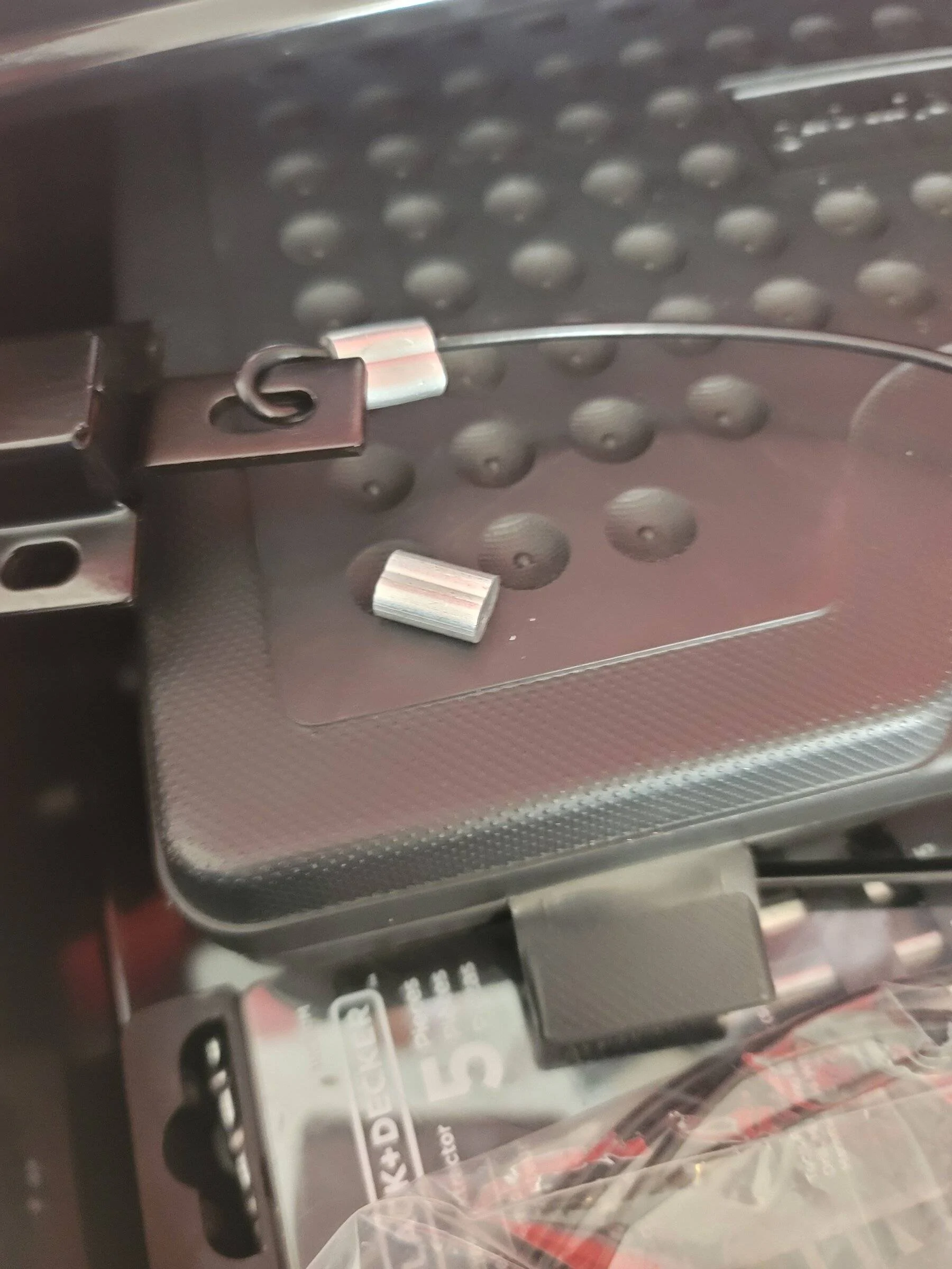

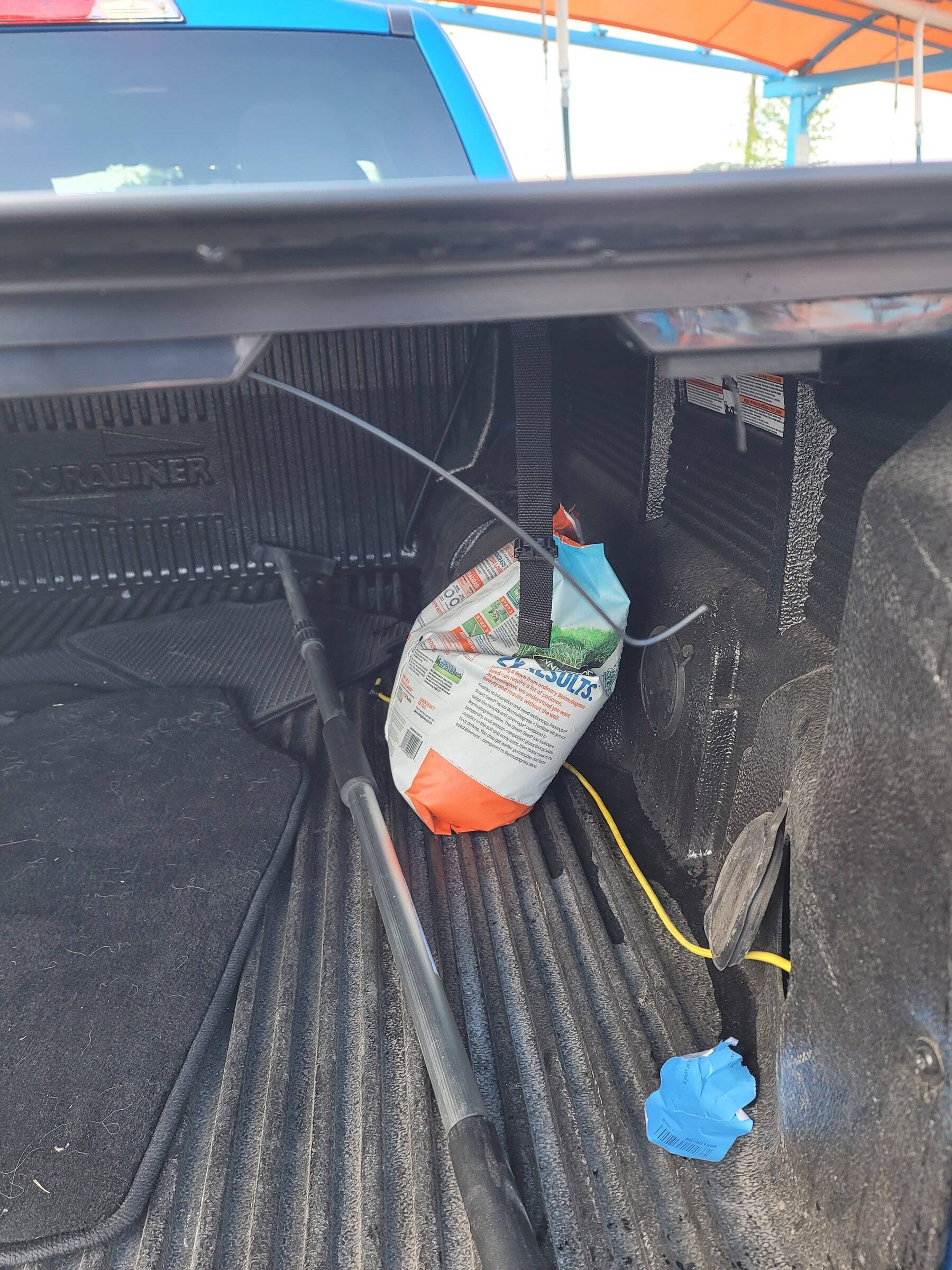

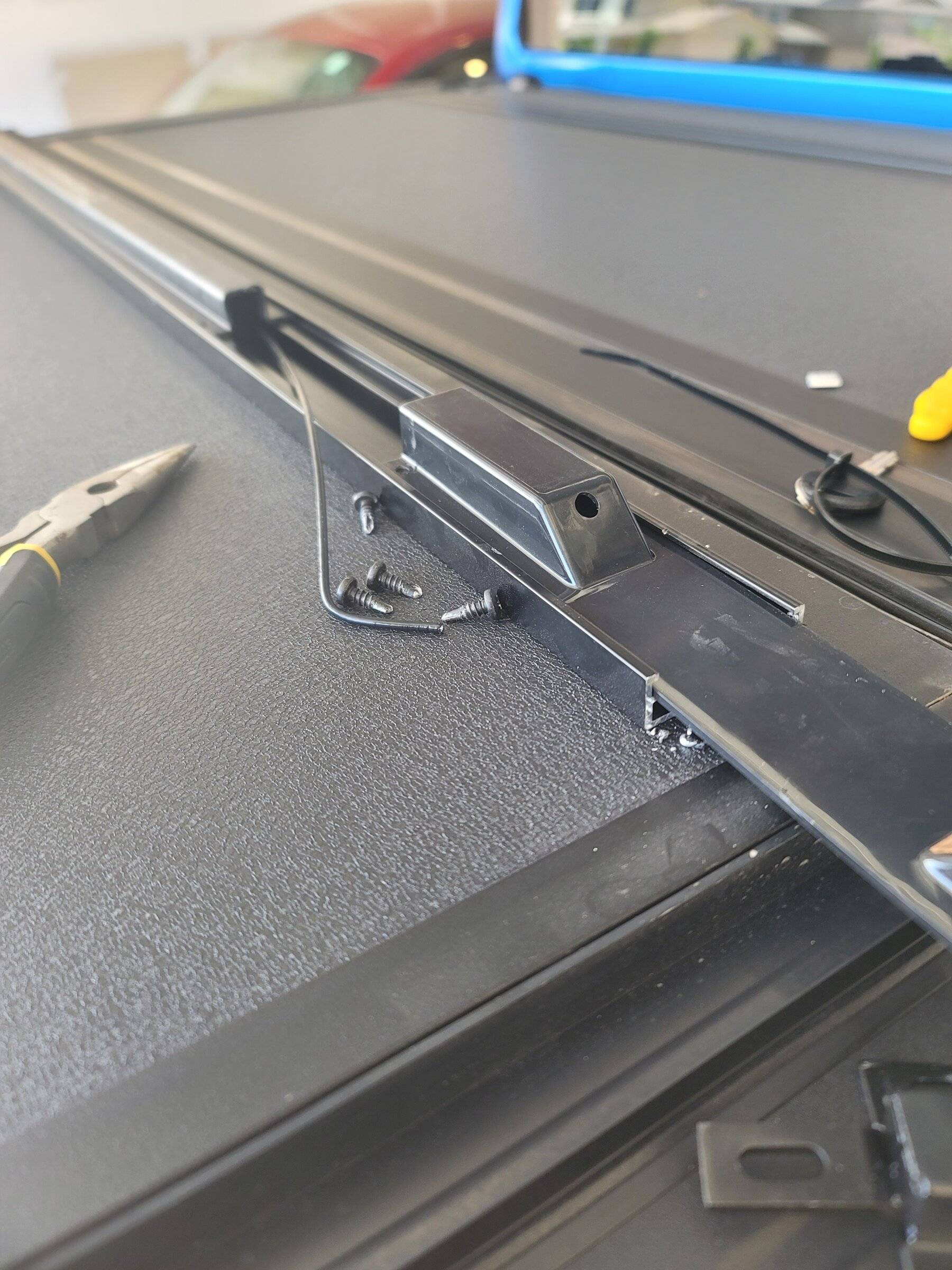

I received a replacement. After taking the latch off, the swedge that held the cable wasn't properly crimped and was just laying in there so I reused it without having to replace the whole thing. Only thing is I had to take out all the screws on both latches and cable cover so I could reach the cable to the latch. It was pretty easy fix. Just fyi if anyone has trouble
with theirs.
